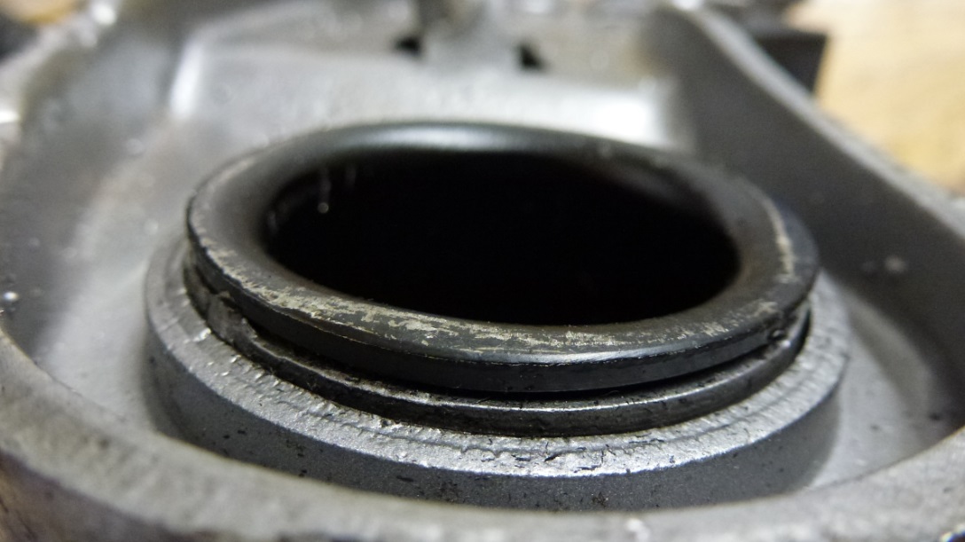

Closer investigation shows that the shell for the bush (poly come in 2 bits) does NOT seat to the base of the LCA. There is a 3mm or so gap. (as can sort of be seen in pic A). This accounts for some of it.
However, pic B) shows the top of the shell - and its flush pretty much (maye 1mm in it). Can only conclude that either a) The shell doesn't go to the base or b) the shell edge has been flattened by the press and shouldn't be flat topped like that, should be just in the LCA.

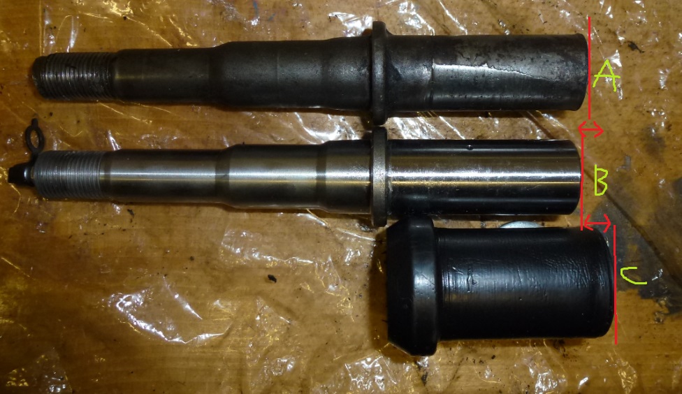

But check pic C). Oddest of all. Pic looks out of alignment, on the bench they were not. Number of things to see -
1) Hotchkis pivot shorter by 3or 4mm.
2) poly bush is WAY longer than the pivot, and also longer than old. Assuming old was flush to torsion bar (or close enough) then there is no way that poly bush (at current length) would seat the pivot at the same point. Show as the diff between a) and c) in diagram.
This is really odd. I can get the length right by cutting off the muffin-top (or trimming it down) allowing pivot to seat further into the uca - but I shouldn't have to. It should be the right length???

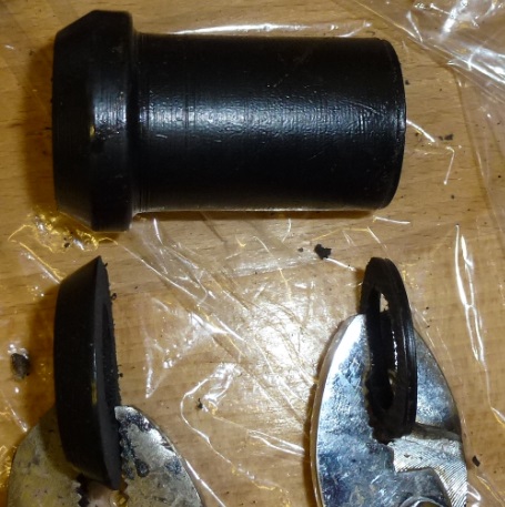

Sorted. Brutal surgery, but alignment now good and all tight.
Long story short, had to shave ~1mm from the bottom of the bush, 5mm off the top allowing the pivot to seat to the same level as the original.
Bush is still contained all the way down, neck still rests on the top of the sleeve.

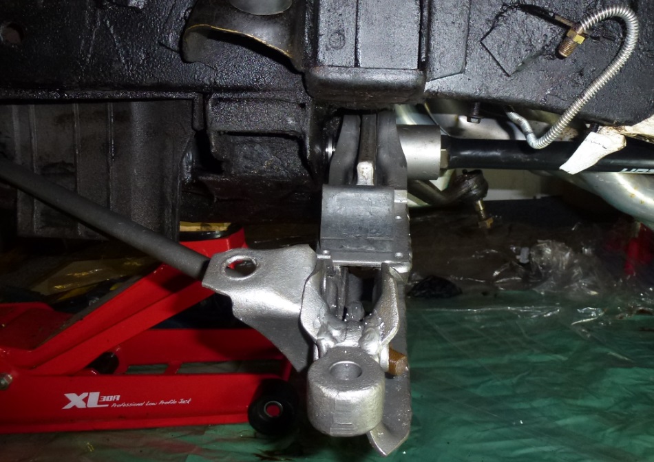

All now fits. Diagonal strut tight on new bushes. Torsion bars properly seated (complete with safety clip at tail end). Geometry looks like it should.

ta-do (sorry on zoom - cant really see the bush bit)
compare to show the shaved bits.
