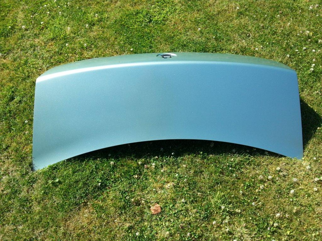

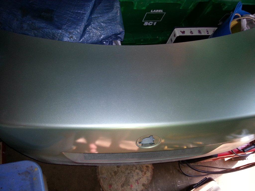

The colour looks a lot different in sunlight compared to the dark shed. Both taken after painting was completed.

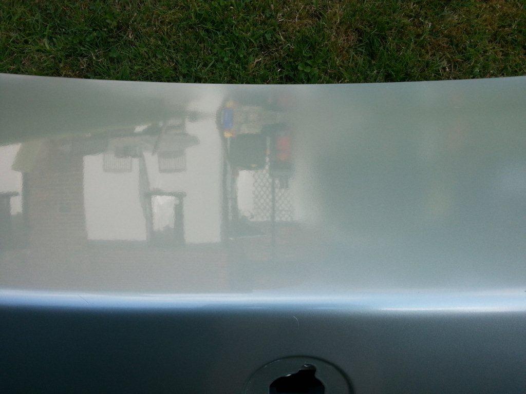

3 days later, will block and polish today if time allows.
Day of paint, metallic and clear

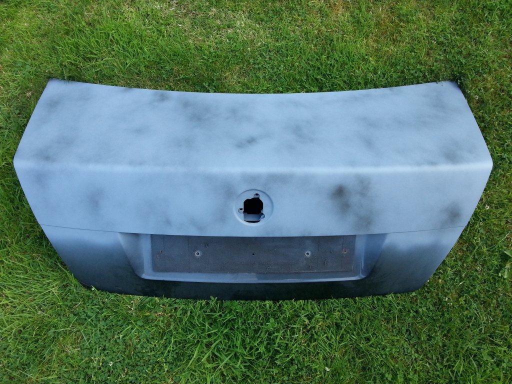

primed before blocking for paint

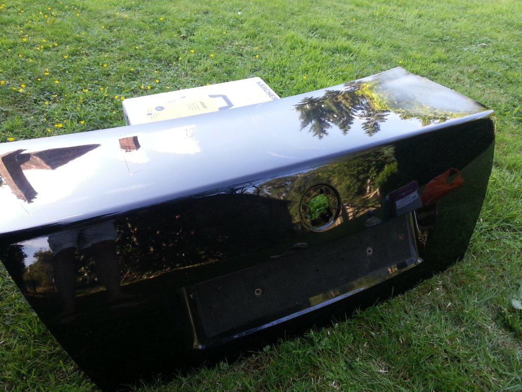

original paint
original paint

Just flatted (is that the right word?) and polished half of it.
Could afford to flat a tiny bit more but can not be arsed just yet! Plan to do a little more once I have a go at 2K and see if I need to flat that.

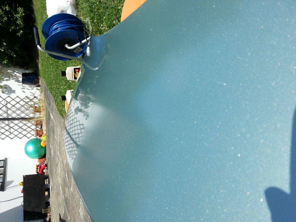

oops finish of the metallic is crap. too much fluid flow not atomising.
never mind ya live 'n learn!
will rub it back and start again when I have time.
