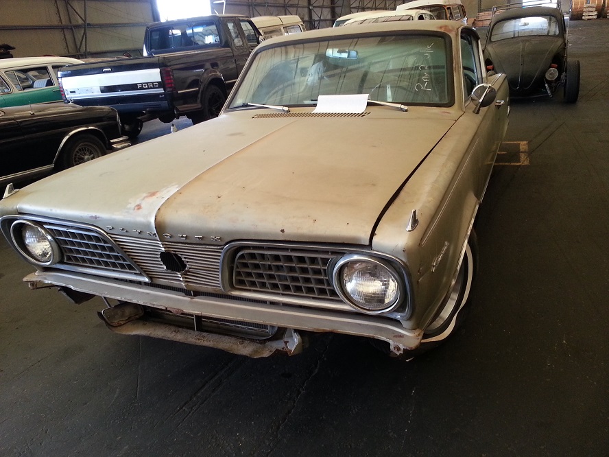

1966 Barracuda. Converting to RHD

looks quite sad there :( . pumped the tyres up, bit of petrol then drove it onto the trailer.
