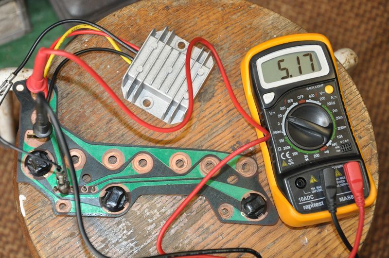

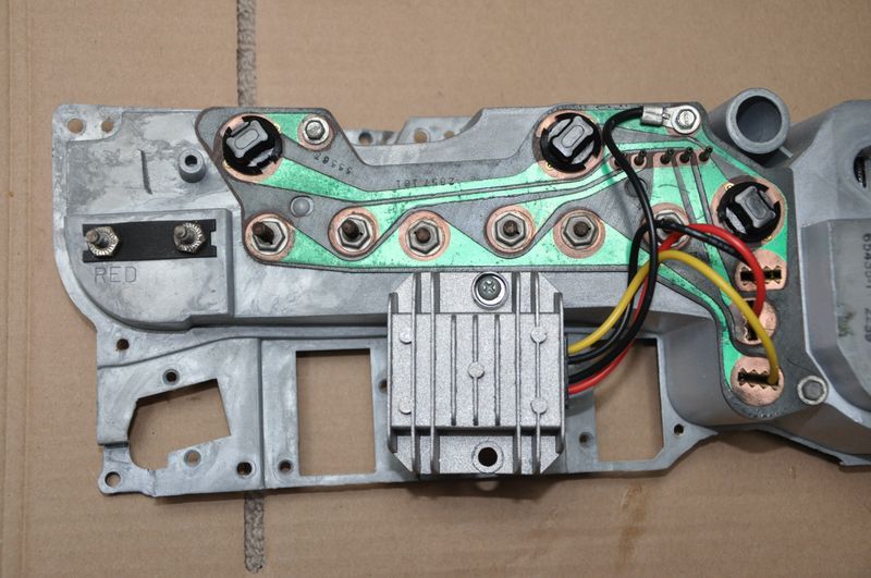

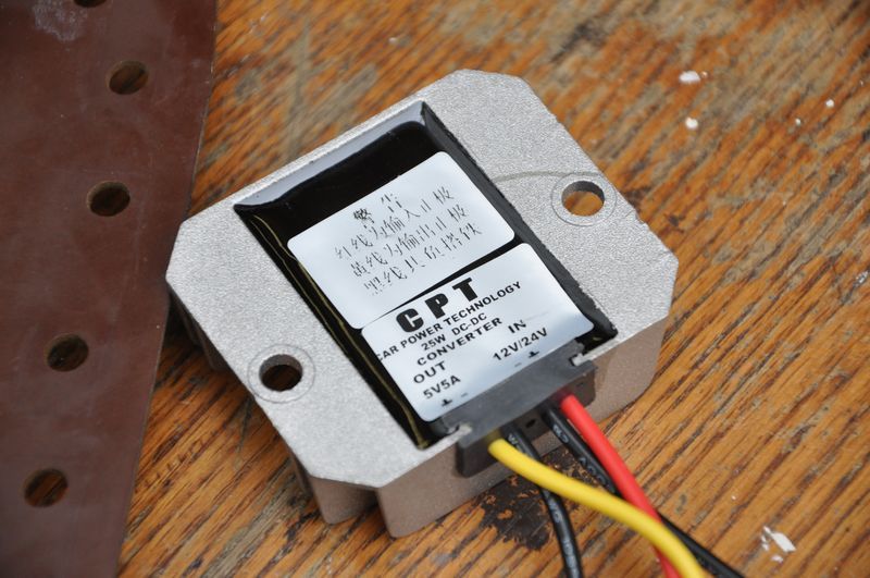

this is how I did mine …
I soldered the wires from the CPT voltage reg into the original connectors on the board where the OEM voltage reg used to go
red = 12+ve supply from ignition switched circuit
yellow = 5+ve from CPT voltage reg
2x black = -ve earth
looking at the back of the cluster, at the 5 connector pins, you need to check you're getting 12+ve at pin no.4 (going left to right), trace the board down to the OEM voltage reg port and you will see this is where my red wire is connected
using a 12+ve source you can test everything on the bench before you put it back in …

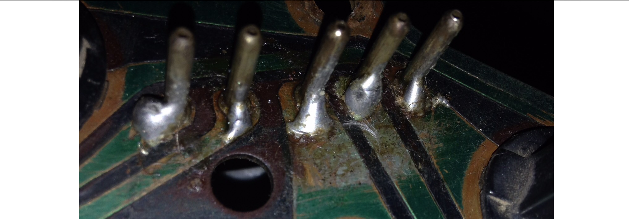

Removed the dash cluster, then the pcb, as can be seen in the pic, there's some crud around the base of the 5 pins where the power supply plugs in. Some of the exposed copper has also become discoloured.
Would it be ok to clean the crud off with lighter fluid on a cotton bud or is there a better solution to cleaning / removing the crud?
What's the best way to remove the discolouring from the exposed copper?
I was thinking of a light rubbing with something like 1200 grade sandpaper so as not to rub through the copper

looks like somebody’s had trouble with that before
the pins aren’t normally soldered
check you’ve got continuity between each pin and it’s respective track on the board
and that you haven’t got any continuity between the tracks
Posts: 9563
melt the solder at each junction and test again. the gunge is probably flux from resin/flux cored solder used previoulsy it will look like brown wax it chemically burnishes the joint as it melts and gets all over if you use big fat powder cored solder
if all good job done
or do it properly
desolder use solder sucker or desoldering braid
pull through
be careful not to pull the track off the board
use plumbers flux or soldering flux powder on the copper and the pins, heat it and it flows and cleans. (or just give it all a clean up and use flux cored solder)
give the mess a mop up but don't touch the track with greasy finger once it has been fluxed it kinda acid etches the surface for a good solder flow
tin both with solder
assemble
light touch at the junction with the iron to flow the previously applied solder down the pin and into the hole and across the track
make sure you don't link anything with a solder bridge that should not be linked
test it again.
the best joint is mechanical joint pin pressing on copper that is glued in place with solder.
when the high end hi fi guys build an amp they make connections by twisting their components onto tag boards
the amp would work without the solder. its put on as a permenant way to make sure the physical connection stays put. that way the conductivity/resistance of solder doesn't become part of the amp circuit. only the component's rated conductivity is included
if that method is good enough for them its very very good, possibly to the point of overkill here. :)

Checked all tracks on the circuit board, cleaned all the crud off the board and gave the copper a light sanding. Checked the continuity along the full length of all the tracks in relation to the pins. All seems good and there is continuity in all areas that there should be now.
At least it looks as though it's working while on the bench, I'll get it back in the car tomorrow and see if all the issues are resolved.
