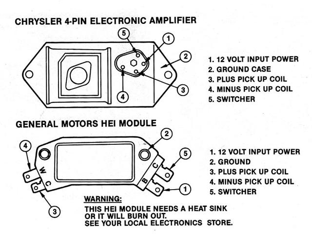

You mean Bypass the ballast and drop in the Blaster 2 coil will not fry the electronic ignition module?
I understand that at crank the car requires 12V to ignite, but when running the current Mopar system drops and uses 9V.
By bypassing the Ballast I now have (or should have), a constant 12V on both ignition crank and also run?
Trying to learn and understand, but I can't get my head around the fact the system will be running at 33% more than it was designed for, with no effect! Is it the fact that both systems run at around 3amps?
Thus the loading on the system is no different and fried wiring, EIM and fires are not a concern?
The (outdated) system was basically designed to work with 6V coils, which you would cook if you hit it with 12V all day long, hence the Ballast - BUT the Ballast is bypassed during cranking (when the overall voltage in the system would probably drop as the Starter motor pulled 700 amps; so to give the car a better chance of firing (maybe in cold weather) it hit the 6V coil with 12V (probably about 10V in reality) for a very short period of time, then drop back when you release to key to the Ballast back in the circuit and less voltage applied to the coil..............
module takes 12 volts
blue wire bypasses balast resistor and become turquoise wire to module
its at 12 volts all the time
power to coil + is blue wire through balast to coil in run poistion
but yellow wire to coil in start
hence coil sees direct 12 volts in start
and reduced volts in run
module sees 12 volts all the time
balast eats volts to coil in run cos coil is 8 volt coil
take out balast and run standard is 12volt coil
no problemo
12 volt coil has ballast in built in coil
becasue it is built into it you can't bypass it without smahing the coil open and digging about in its guts.....not nice
either way all ok
don't run mopar box with very low resistance coil primary
blaster 2 is 0.7 ohm mopar box will get hot
it won't like that very much but it will work fine ....

i'd use ballast with it unless i was usuing it with HEI module
that way the mopar box would last 100,000 miles
Note: This Blaster Coil Kit is intended to be used with an MSD Ignition. If installing on a stock, points style ignition system, a 0.8 ohm ballast resistor or resistor wiring MUST be installed. MSD offers this Ballast Resistor as PN 8214 or the Blaster Coil Kits, PN 8200 and 8203 are equipped with one.
voltage to igntion module is not a problem.
so based on new found blaster 2 spec
run it with a balast if running it with mopar standard or orange
run it with no balast if using mopar chrome, FBO or HEI

a old style 12 volt coil had 1.5 ohm primary reisstance
an old style 8 volt coil had 0.8 ohm primary resitance + balast of 0.6-0.8
both used with points so both had to limit cuirrent flow to 3 amps
mopar eletronic is just a Bananarama! points eliminator for lazy people with no brass feelers who are crap at angles.... all the rest of the spec stays the same.
HEI achieved in 1976 what all of the other products achieved years later for low cost
runs a coil with 0.7/0.8 ohm primary resistance at 14.5 alternator at full tilt volatge relaibly without the module or coil melting

Dave81 wrote:Just to be clear....Dave wrote:The blaster coil might have a slightly lower resistance but I doubt it. I think it probably sacrifices current for a higher voltage output.
In any case. Short out the resistor and use your blaster coil ya fanny.
How more clear could I be? Which bit of short out the resistor and use the blaster coil does not make sense?
Voltage is just electrical "pressure".
Amps is the amount of electrical current flowing. Current is what will make anything heat up.
Resistance limits the amount of current flowing.
If resistance goes up - current flow goes down. To bring the current back up at that resistance you have to increase the pressure (Volts).
Truth is I don't know what the running resistance of the coil primary on the Blaster coil is.
But even if (worst case scenario) it is the same or lower than the low voltage coil you can still switch the coil primary with the orange box unit. At worst it may indeed get warmer and it's working life shortened. But it will do to test the system which is what I thought you were doing? You don't have to keep it that way. If there is no difference to how it runs just put the original coil back on and un-short the resistor again.

Cheers, so it will run slightly warmer. This is as I thought. No issue, just trying to understand!Dave wrote:Dave has edited and expanded his reply above my last.
If the Blaster primary resistance is that low when running (hot is always more resistance than cold) then yes the orange box will have more current running through it so it will get hotter.
Still fine to test with though.
