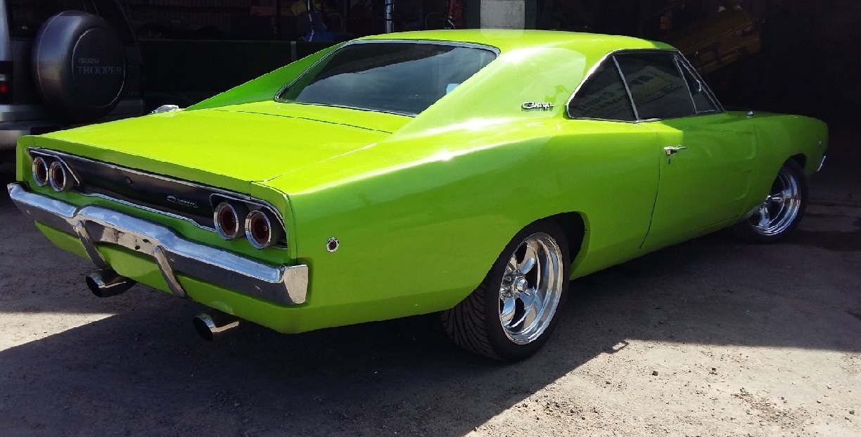

Sold the old 15" chrome wheels / tyres and fitted new 17" Torque Thrust II's

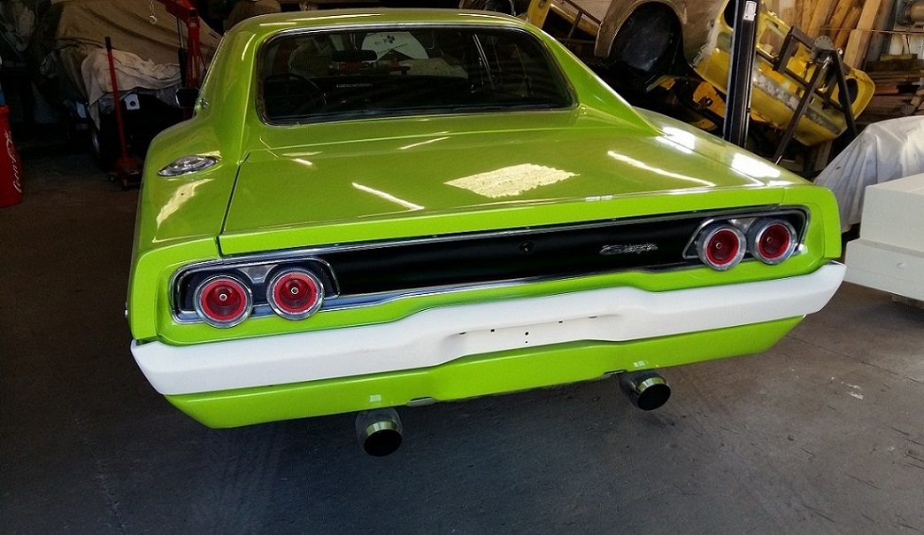

Rear bumper had a bad dent in it. Got a replacement 2nd hand but straight bumper on which the chrome was very poor but that was fine as I wanted to weld up and smooth out the bumper bolts and over rider holes and paint it body colour anyway.... Just got to give it a buff and polish and that will be back on for this weekend

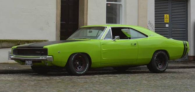

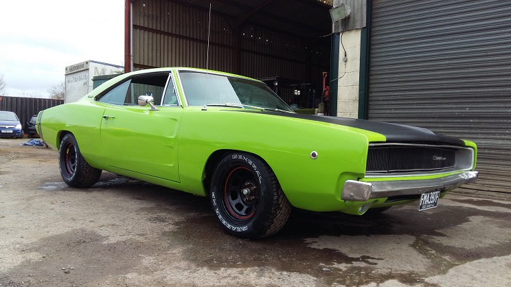

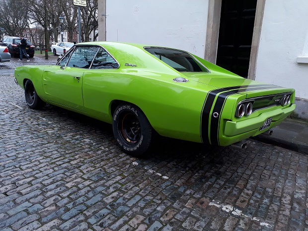

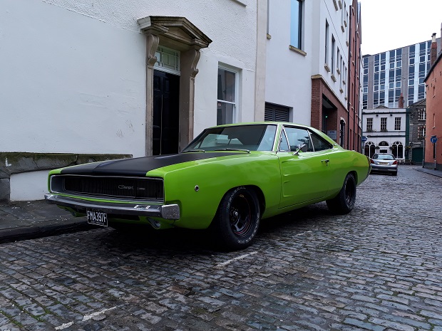

Wow time flies and never enough time to post on here.... ! So by way of a small update I recently loaned the 17" Torque Thrusts wheels to my youngest lad to try them out on the 1970 Challenger.... so I decided to see what the Bassett D Hole 15" steel rims would look like with 60 profile tyres..... I like them, but maybe not to everyone's taste if you like the factory stock look !
Got the bumble bee stripes applied a while back last summer and also got the exhaust tip changed for something a little more subtle....
