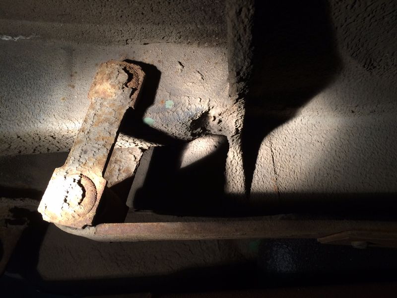

Something I hadn't thought about is the position of the shackles at the moment, I'm not sure what's correct. If mine are not, does moving them have any affect on height? This is mine now

The shackle is sitting like that because the springs have sagged, it will sit more upright once they are sorted. You will need to get your own bushes, if you want poly you can fit those yourself easily enough.
