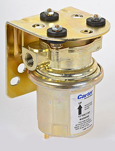

Yes I to went with an electric fuel pump eliminating the mechanical pump I use a unit from Carter,I am replacing after 15 years or so,with the current fuel we have, it is a must, vapor lock is a huge problem here,but I am re wiring,and will add an oil pressure switch, that will only allow the pump to operate when the engine is running, sensing oil pressure it is a unit that I will also add a relay,as well as a fusible link.
all this is being done because currently I have it setup off the ignition, so it is on all the time with just the key in run position, this way is not safe ,if the car or I become disabled, the fuel will continue to run even if the engine is turned off,that is not safe .SO CHANGES WILL BE MADE THIS WEEKEND :thumbright:
