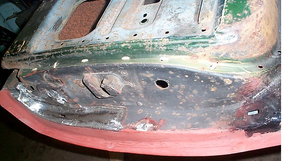

hi all. im back with a few more pics for you. il be next sending the door to the blasters.

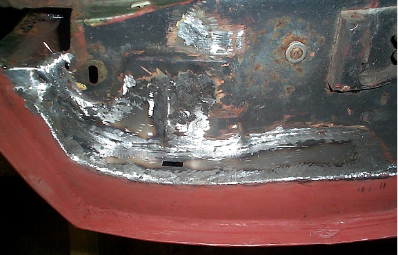

now in the last pic I posted can be seen that I have now also repaired the pin holed area above the door latch, again I first made a card template of the area to be repaired. then made it in metal. before then welding and grinding the welds down. the door jamb area of the door shell is all solid now, note also I have cut out the door bumper slot too.

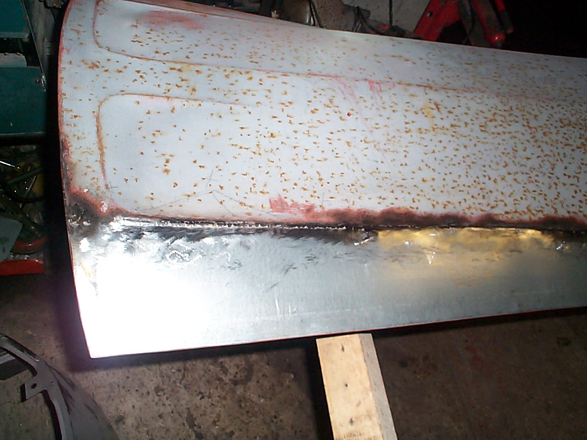

the last pic is the lower door skin repair section. it is now had its final welding finished and ground down with a sander pad on the grinder. finally ready for the blasters, il next post some more when im prepping it ready for paint. thank you all for your interest on my work on my door reggie

What's your plan for treating the rust inside the door?

hi guys. now its all welded. my mate gets a good price at the blasters . so it is going there this week. apparently they will also blast inside the door too. and I will get it back in red lead. after this it will be painted and internally stone chipped. then a gloss black over the stone chip. when the car is ready for the road il spray oil the inside of the door. I did this with my split camper. door is still good years later. ive also every confidence this door will fit ok. I always double check my measurements as I go. too much work to make mistakes. I learnt this years ago. one always learns the hard way, I do anyway. reggie
