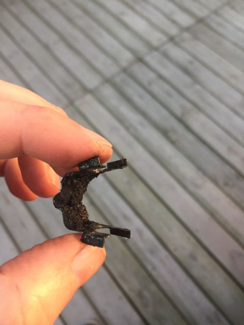

Hi
Bit late to the thread but I think I may have the clip you were after?
I'll try and upload a photo later this evening, doesn't work of my phone
rossk
Posts: 199
Joined: Wed Aug 31, 16 1:27 pm
Location: Watford
clip
Post by rossk »
is this it?
Posts: 7309
Location: Cornwall
Post by MilesnMiles »
Yes sir, I think that's the clip I'm looking for!
rossk
Posts: 199
Location: Watford
Post by rossk »
cool, send me a PM with your address and I'll pop it in the post to you.
Posts: 7309
Location: Cornwall
Thank you. PM on the way.
