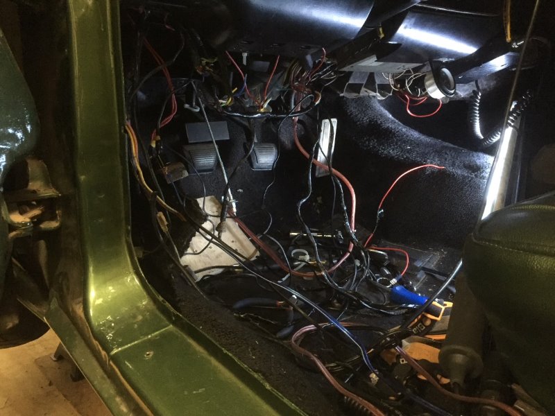

Being as progress ground to a halt on the brakes (Re above) decided to start tacking the wiring ... :? DOn't you just luv unpicking several previous owners hacks and lashups. Going to remove virtually everything and start again

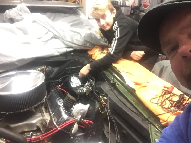

Got the Res installed, got my lad to give me a hand - gotta keep the younger generation interested eh

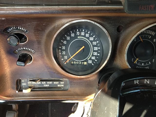

Back to the boring stuff and more wiring this evening, need to remove the dash and pretty much start again with the wiring, such is the state of the hack or wiring.
Removed the HUGE old radio - Its Massive LOL Will keep this in a safe place, but can't see how to pull the rest of the dash out.
Undone the screws at the top and bottom on dash, and its all loose now ... Any hints/tips for next step welcome ?
"Snot Rod" 1971 440 Charger
Posts: 1674
Re: Jimbo's 71 Charger "Snot Rod"
Did you get the screws under the speaker grill?
If its anything like the A bodies you have to drop the steering column by a couple of inches to get the cluster out.
Have no idea if thats what you need to do on a Gen 3 though!! :thumbright: :-k

Dave81 wrote: Wed Mar 21, 18 1:16 pm If its anything like the A bodies you have to drop the steering column by a couple of inches to get the cluster out.
Yes I forget about that, you do have to drop the column...can't remember if there's anything else it's been three years since I took my dash out.
Posts: 7309
Location: Cornwall
Post by MilesnMiles »
Drop the column a touch as said. Also need to detach the heater controls and plug too. Remove gently leaning it 45 degrees towards you and then you can unplug the various bulbs etc on back of dash. Might also fine the speedo cable holding it. Ensure it has some free play by pulling the outer cable thru the bulkhead a bit.
