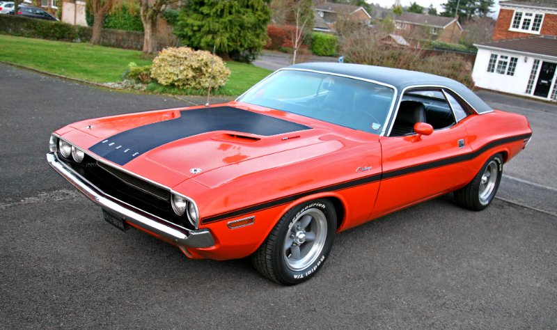

Re: Mark B's Challenger
Posted: Tue Oct 30, 18 12:15 pm
by Blue
Looks very nice does that!
Posted: Tue Oct 30, 18 8:50 pm
by Mark B
Cheers. Need to put some miles on it now.

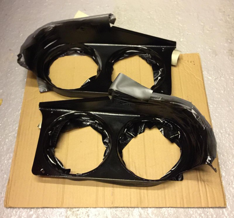

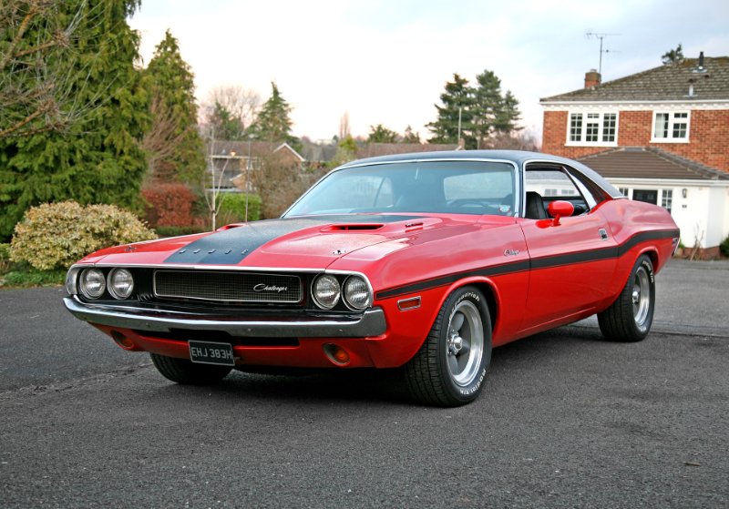

Decided I'm not that keen on the standard argent silver grill. So thought time to paint it satin black.
Challenger 6.JPG (94.78 KiB) Viewed 4556 times
So masked of the lamp surrounds, primered and finished in black smooth Hammerite. Thought Hammerite might give better protection against stone chips.

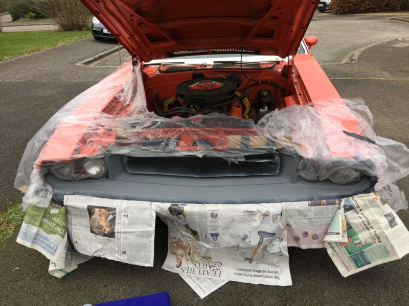

The Grill is a pain to get out and the front bumper is not shifting, so did it in situ.
So today 3 Coats of primered, then 4 coats of Hycote Bodyshop satin black lacquer.

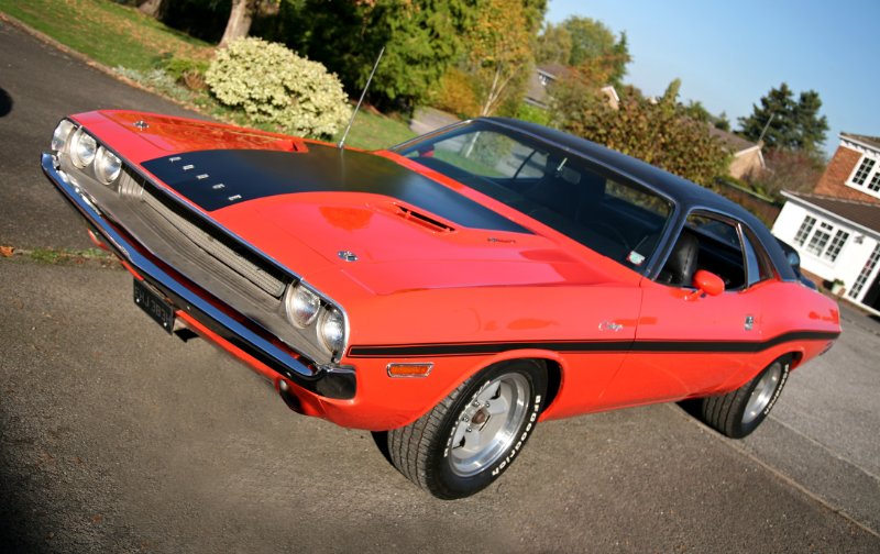

And the finished job:
Posted: Sun Jan 13, 19 8:22 pm
by MattH
Nice job Mark. Sets off the stripes nicely.
Posted: Sun Jan 13, 19 8:47 pm
by Mark B
Cheers Matt :) . Had a bit of stick from some yanks about changing the argent grill on an "original and collectable" 1970 A66, but no ones heard of them over here so who cares. It's got to look as fast as it goes!
Posted: Sun Jan 13, 19 9:19 pm
by Pete
Well done, I like it.
I need to do mine whilst it is out.
I think it really improves the definition on the Grille assembly.
Great job!
Posted: Sun Jan 13, 19 9:26 pm
by Mark B
Cheers Pete. Yes, satin black rather than matt black, shows the definition. Would be great to see what yours looks like all done.

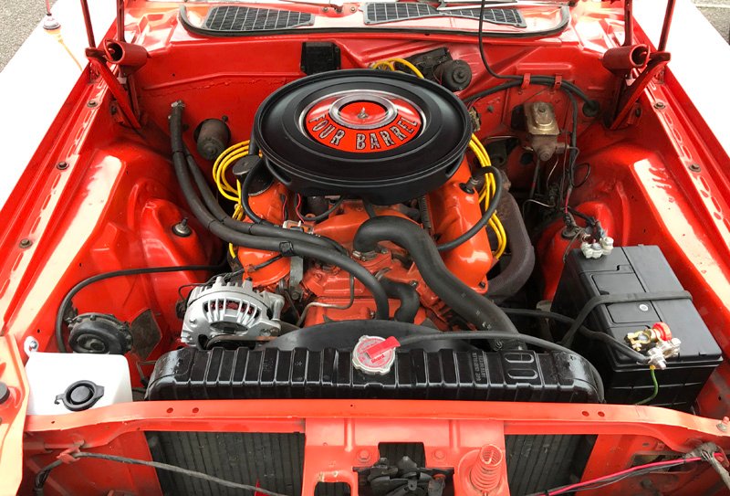

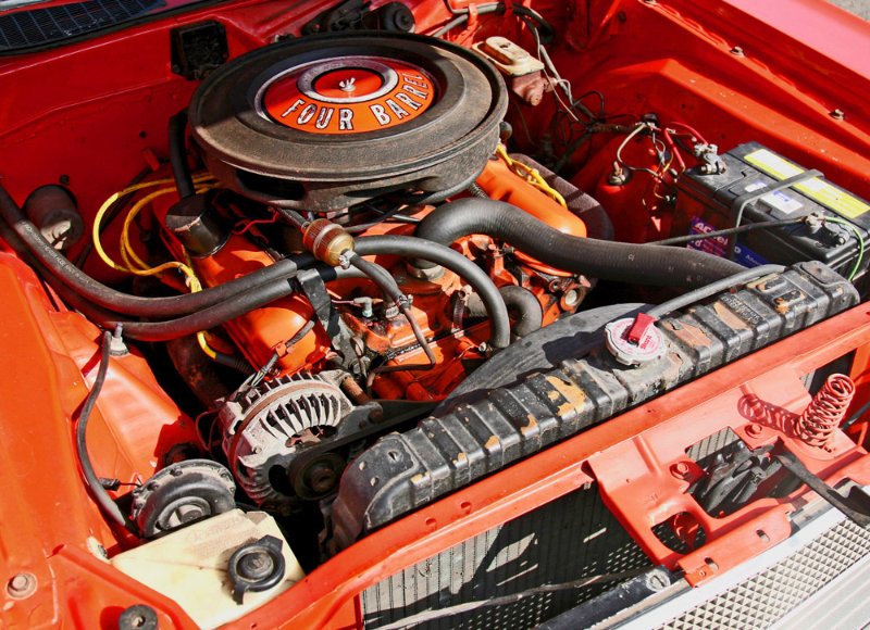

Have been tidying up the engine bay on the Challenger. New alternator, restored the air cleaner and radiator, painted the block. And thanks to Andy's Speedshop for the new washer bottle. A few more things to do.
Posted: Sun Oct 18, 20 6:21 pm
by newsatten
How'd you get on doing the air cleaner housing and lid? They are crackled finished and ive never had any real luck getting the finish correct?
Mine could do with some tlc, lol........
Posted: Sun Oct 18, 20 6:38 pm
by Pete
A great improvement, Mark - well done!
Posted: Sun Oct 18, 20 7:07 pm
by Mark B
Cheers. Didn’t do the air cleaner in a crackled finish, just satin black lacquer. Don’t know how to get the crackled finish.
