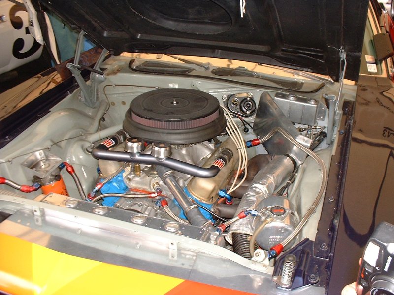

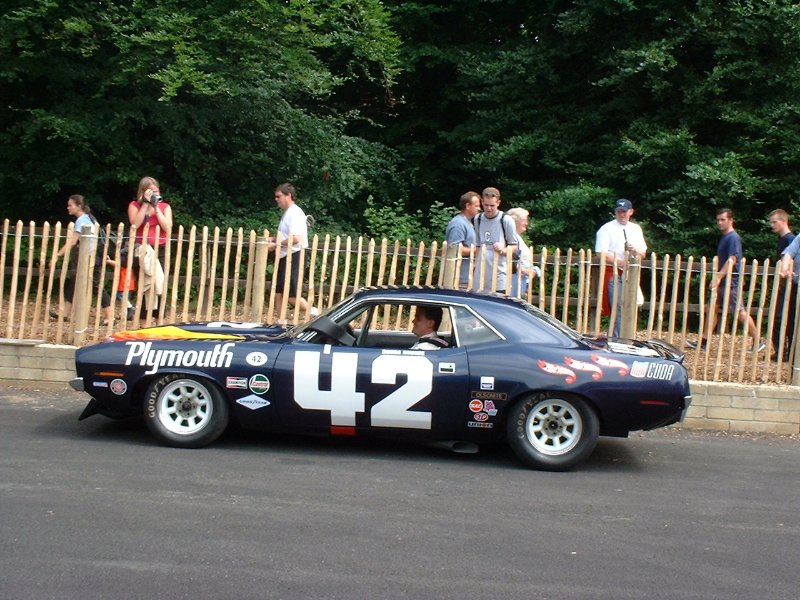

A few pictures of the real deal from Goodwood some years ago! AS Pete mentioned, we were there (in our E-bodies) to meet Gary Savage, son of Swede who originally drove it. Good times, and a great car!
..........................................................................................................^ Gary!

got to love that car and a small block as well 305cu. in i think

Yes the race cars ran de-stroked 340s to come inside the 305ci capacity limit for the series.

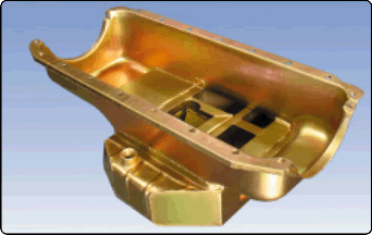

Good point about the oiling. Dave Billadeau is building the engine and the intention was to use the Milodon pro-touring sump, for which they claim "Full competition baffling is capable of handling full road course use" Just have to hope the oil drains back into it quickly enough, as you say. The fly in the ointment is that the special pickup tube for this sump has been out of stock for about 6 months and the 'available' dates keep getting further away, so we may have to reconsider. It's a pain because I've already bought the sump and it was an eye-watering amount of money. I'm trying to avoid a dry-sump system due to cost, timescale, and complexity.

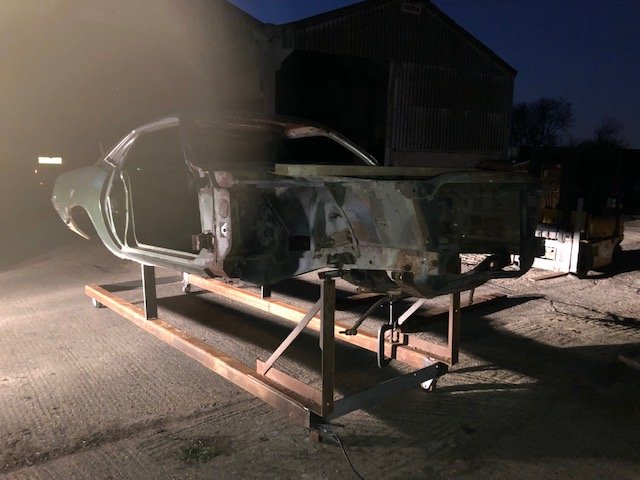

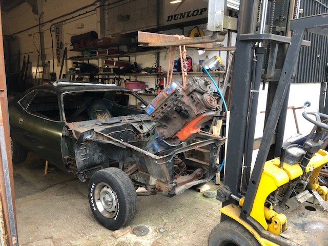

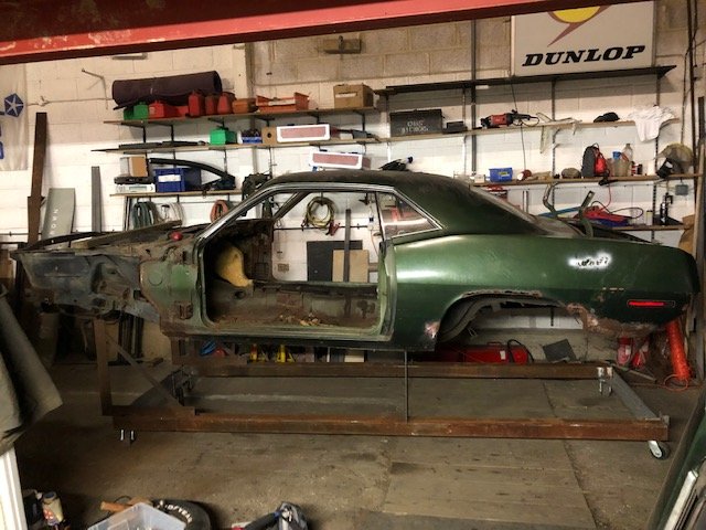

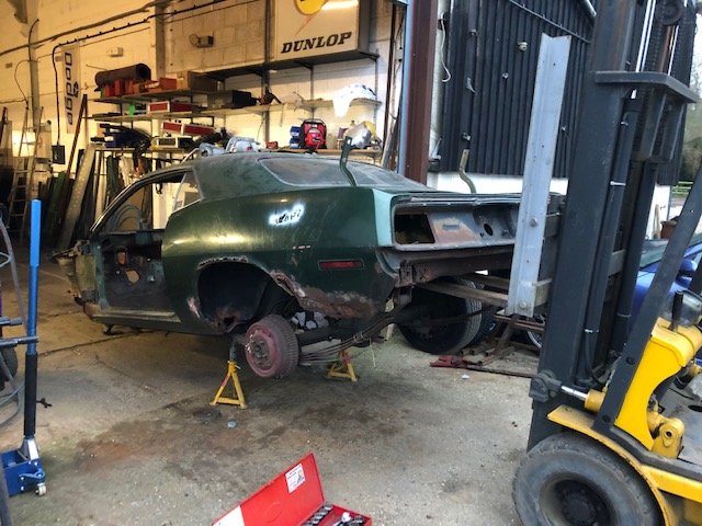

A bit more progress last couple of days.
Stripped the car down to bare shell ready for rust repair.
Engine & box out . 383 not original to the car and probably seized. I have no idea why the sump appears to be on back to front !
Rear axle out
Built a substantial rolling jig to mount the body on. I can make reference jigs from this for positions of frame rails etc as most of the rear sheetmetal will be cut out for replacement.

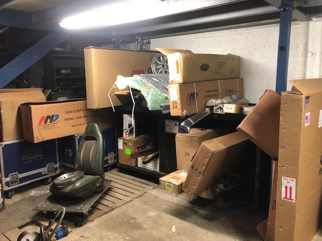

Got all the sheetmetal ready to fit, although I've now decided that the whole front floor pan will need replacement so will need to order that separately. A friend can call in a favour with an airfreight company so it should be with me soon, and cheaply.

That IS fast work, big stash of new parts already, is that a minilite in the pile too?

I one of those sumps on my 408 cu.in. and one one the 340 T/A expensive but they will make sure you always have enough oil :thumbright:

Ive just put the circuit race sump on my 440 sixpack engine in the coronet,nice piece of kit.
Look forward to seeing progress Matt :thumbright:
Same sump on my 440 blower engine. If I’m correct the pickup was treaded to larger hemi size for the pickup.
