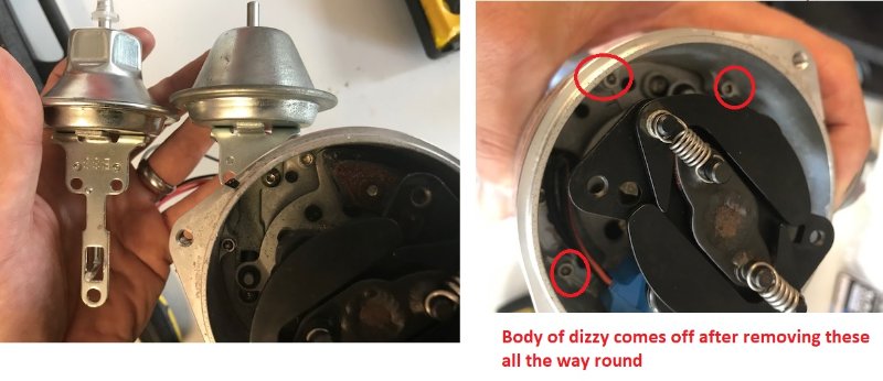

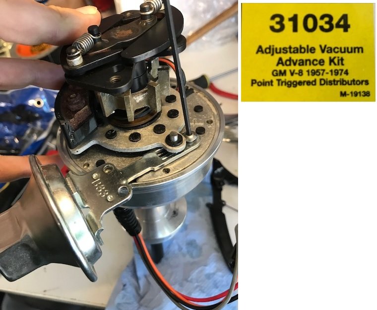

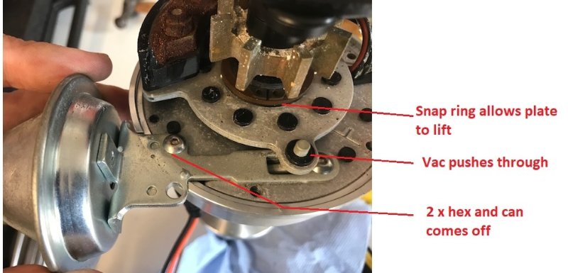

Re: Timing - 440
Right, timing fans.
Vac update.
The good news is that despite various US forums claiming you cant, it turns out you CAN swap the vac can on an MSD.
You need an 'Accel 31034 - for GM point dizzys' - its the same but adjustable (unlike the MSDs).
Got it fitted this morning, got it all screwed down at the mo but will start to introduce vacuum slowly later and see what happens.
Anyway, here is how you do it -
- Dizzy out.
- Remove 'body' top half of dizzy - then you can get to everything.
- Pop the circlip/split-thingy allowing plate to lift.
- Undo the 2 hex nuts.
- Ease the vac-rod out of the plastic housing.
Thats it. I lost about an hour trying to do it without popping the clip, so just go straight there !
So, its on, I can adjust and when I suck on the tube I can make it move easily, with difficulty and lock it down - so the adjust works.
Unless I've missed something I cant see what MSDs problem is and why people dont think it can be changed ?
Vac update.
- Dizzy out.

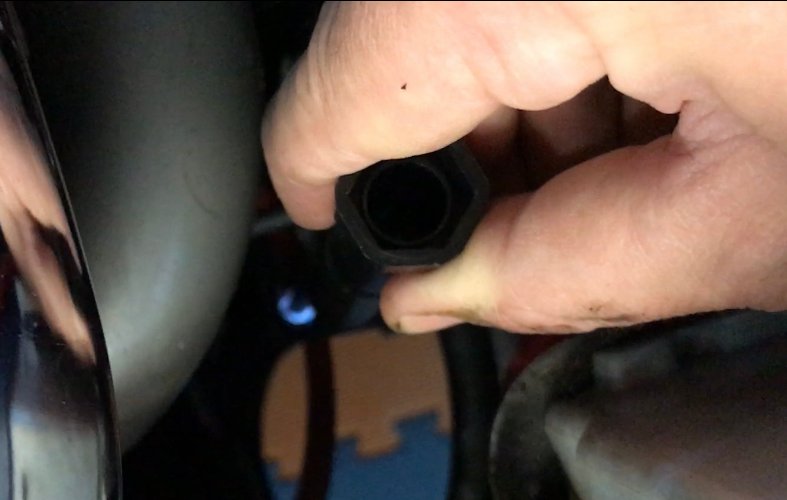

Re: Timing - 440
Not fired up the colourtune yet. Might have a go tomorrow...
Re: Timing - 440
Wow. A year ago. Well, you cant rush these things....
Decided to have a go at getting my idle to be less stinky and smooth out a bit.
Plenty of reading done as well as all the stuff from last year. But my overrun is back (dieseling on shutdown). I mean I can shut it down in D and the natural drag will stop it but its not good. SOmething inside is too hot (carbon? Could possible use a damn good thrashing) and the carb is clearly allowing fuel to go through after ignition is off.
SO - learned that apparently on bigger low-vac cams this can be a problem. Various Holley threads and a solution appears to be adjust secondaries to let some air through. You can then wind back the primaries to cover more of the transfer slot (wot Blue said). So armed with tools, vac guage and a colortune I set to work...
a) Took carb off. Secondaries were indeed at factory setting. Cracked open 3/4 turn, you can see daylight around the edge but crucially not much of the secondary transfer slot. So now she can suck more air.
b) Connected vacuum gauge to manifold. Started car and immediately its breathing better, idle higher. Allowed it to reach op temp. Vac gauge miserably low ~12(unit. Hg?). adjustment of the idle screw managed to increase to 18ish. This is good.
c) Insert colortune ! What a wonderful thing. Color of spark is blueish. Possible white side of blue, but blue. This is good. (see pic).
So now we are looking for roadtest.
Initial reports are that I have not had the overrun (but only tried half a dozen times). The theory of all this is that if the engine can draw air instead of fuel when I shut the thing down it wont diesel on...
Will report back...
Will report back...
- spark.jpg (43.65 KiB) Viewed 1163 times

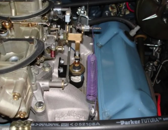

Re: Timing - 440
The factory solution to stop six pack cars running on was to fit a solenoid under the idle screw. When you turned off the ignition the solenoid would retract to totally close the throttle blades.
Re: Timing - 440
Huh ! Never seen that. One way of doing it instead of tuning it out - thump it shut !
- solenoid.jpg (55.47 KiB) Viewed 1152 times
Re: Timing - 440
Yes that's it. When I was setting up Jem's six pack it didn't have the solenoid and I modified the outboards to get a bit of idle air. Never had a problem with in running on it just the rest of it I never totally got on top of. These cars definitely do run better if they have a run up a fast road occasionally.
Re: Timing - 440
Well, Been out. No hesitations or flat spot (good). No overrun at all even after a fast run (good). Still smells. (not good) - but given that I know the timing is good, the spark is blue, it runs good I think that might just be silly cams overlap smelly.
Either way, I am happier now and car seems it too. Just got the more-power-than-traction issue now hahaha
