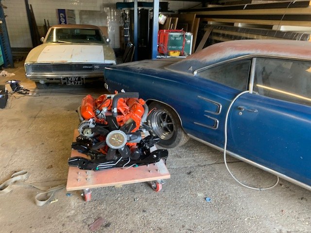

Hope to get the engine back in this week.

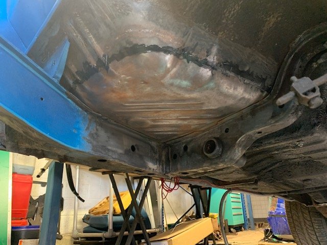

Cleaned off the old floor pan repairs and seam sealed them, ready for a quick coat of satin black to tidy them up a bit

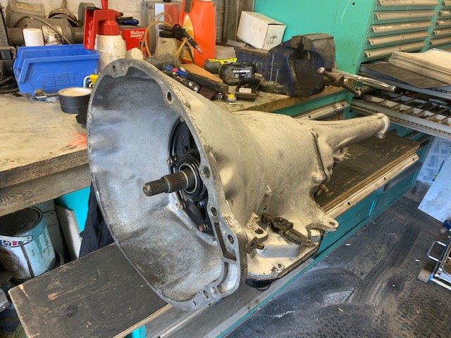

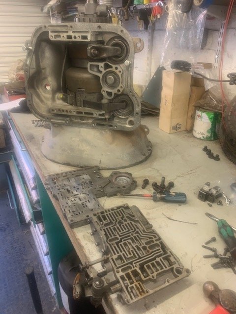

Had a look inside the transmission , as I'd left it outdoors last year for a couple of weeks . Yes I know I'm bad....
No water damage anywhere except for a partially stuck Torque Converter control valve (which is pretty much the first thing in line to the atmosphere at the front) , which soon freed off.
Pump etc OK

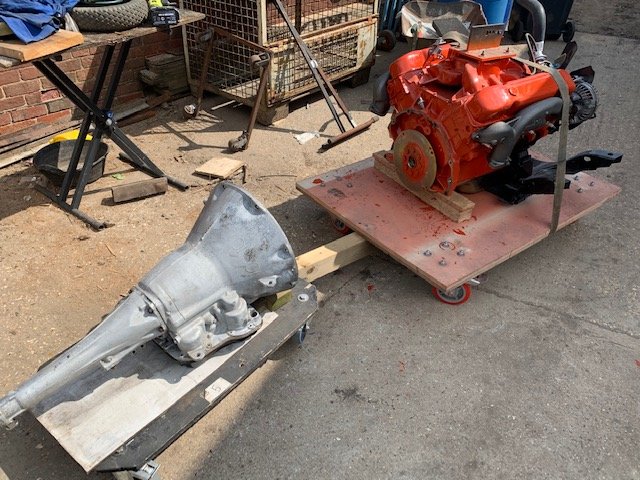

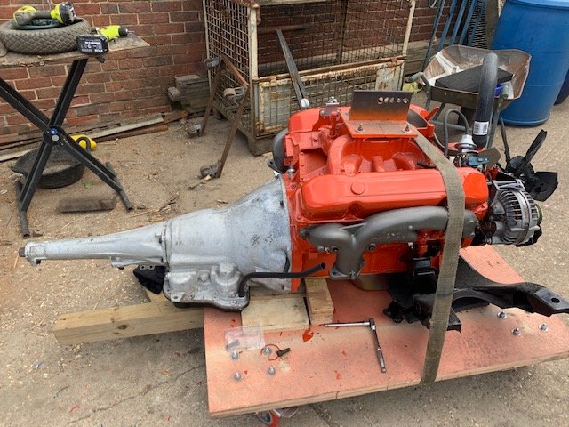

All done . With new gaskets etc.
Ready for mating to the engine

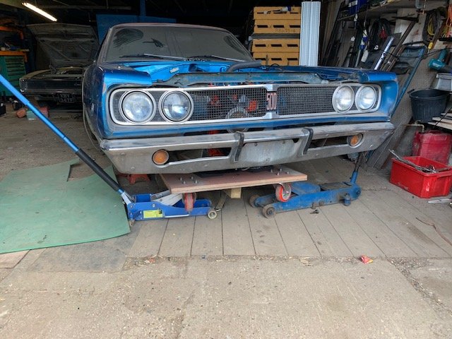

OK let's go !

You make a transmission strip sound easy. I have a TH400 leaking lots but bit wary of dismantling.
Posts: 22137
Re: Matt's '68 Coronet 500
727's are a lot easier to work on than a TH400...

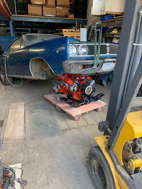

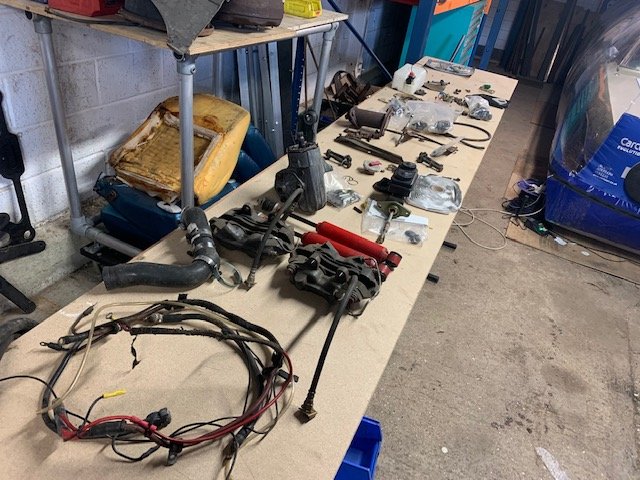

Progress has been a bit slow.
Engine back in though
Got all the parts out. Going to start on the wiring first I think.

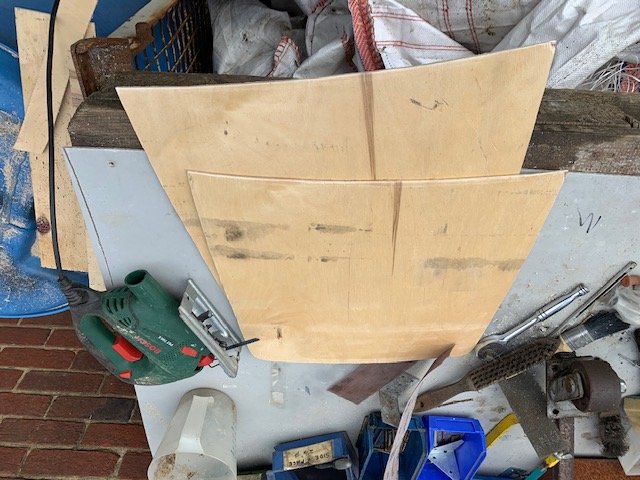

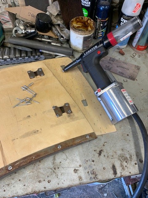

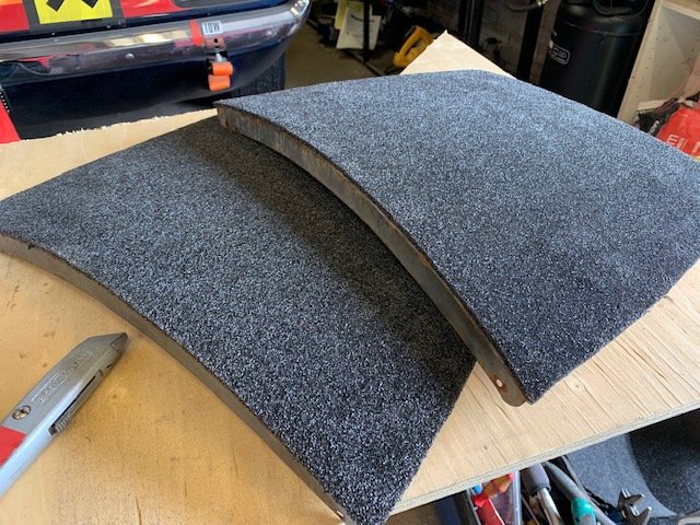

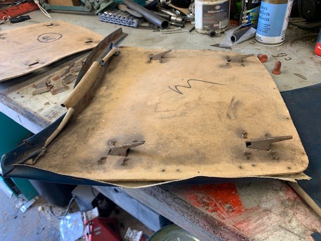

Been reconditioning the rear trim panels from the front seats.
Original hardboard warped and horrible
Cut some plywood copies
Add hardware
Add a thin layer of foam before covering in vinyl

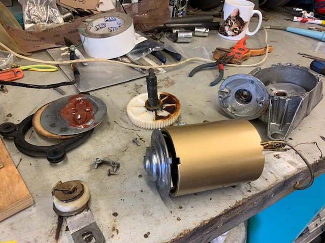

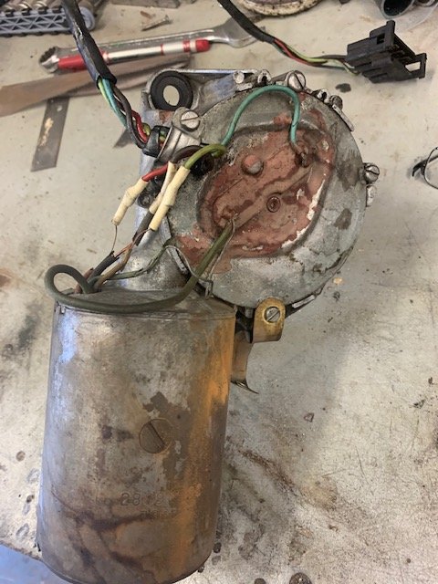

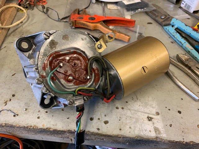

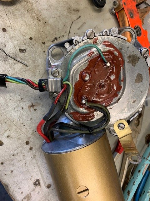

Wiper motor looking a bit sorry for itself
Corrosion removed, parts variously clear-laquered and painted. Not exactly 'correct' , but it's an improvement.
Reassembled, with wiring/sleeving replaced or tidied up
