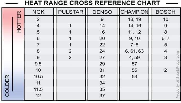

It gets weirder than that. These are XR range - which seem to run lower numbering.
Stock (like stock-stock-motorhome-stock) seem to be XR4s. (see post earlier about 'up to 9:1ish comp). Summitracing suggests XR5 is the next hottest - but this isnt the same as 5s on the old scale.
As I am reading it - the XR5s (which are the current ones for sale) should be the equiv of a '6'. So colder than I have now.
As you say, I think the main point is 'Do plugs stop the misfire'. If they do (even temporarily) then thats a cheap fix while I play around. My pal has a less scientific theory (which I think actually might be right). His point is that Bob had this built as a race engine and I am putt-putting around in it. In his words 'You need to give it a damn good hiding and clean it out a bit'. :drunken:

yes i have been unable to find an XR/standard NGK plug comparison
i guess your special heads have a different thread size and thread depth from standard hence the XR plug
it would be totally off piste for the numbering to go the other way from the rest of NGKs spark plug range but...you never know

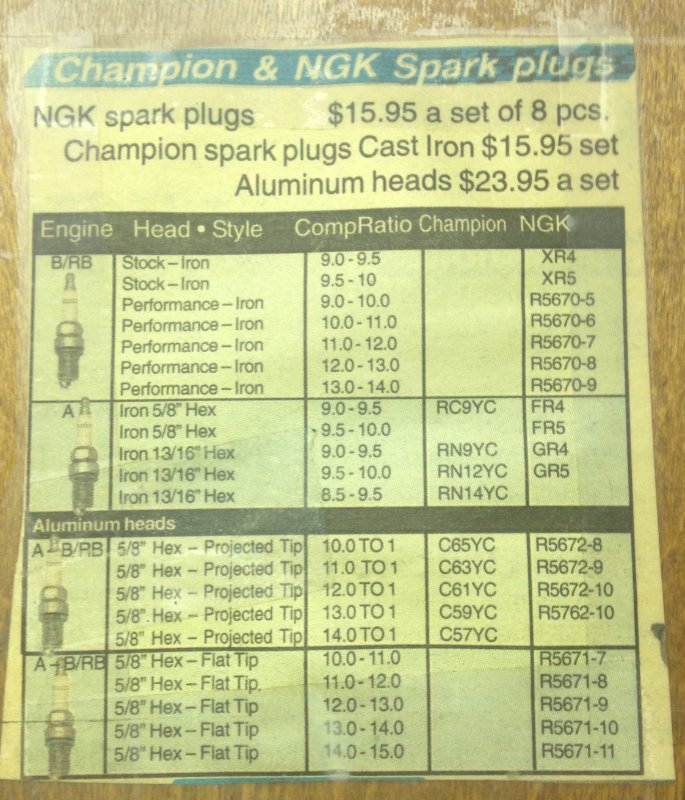

There is SO much info out there - but this old chart looks useful . According to this though I need colder for 10.5-10.8 comp...

i agree..i think you do 5670-6 or 5670-7 if you heads are iron
and one presumes you don't have standard heads
and note subtle differences for iron an ally heads as well

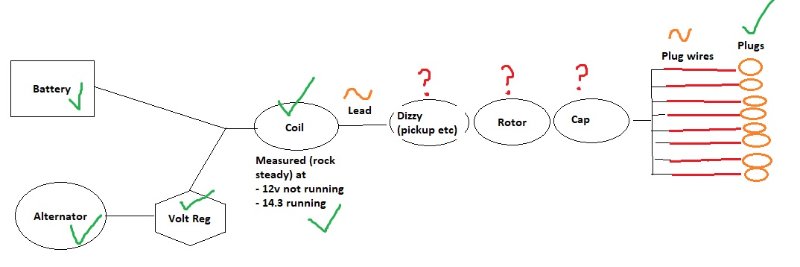

Wont idle. POP ! BANG ! - Will run, but stalls and bangs on idle. But I have made some progress.
The prob seems to be in the dizzy somewhere - My logic is thus.
Battery is fine. connectivity to coil with ignition circuit open.
With car not running (so battery only) its 12v-ish as expected.
With car running coil is 14.3v +/- 0.03v - so basically rock steady. This suggests ignition circuit, alternator, volt reg all fine.
Coil has been swapped with no difference noted - so eliminated.
Timing is set to 16/34 - its fine.
Plugs brand new (not a guarantee I realise, but they made no difference basically)
BUT - I noticed the timing gun misses too - which implies the charge isnt even hitting the wire. I moved the gun to a diff wire - same result.
Conclusion - Feed into the dizzy is fine. Plugs and wires likely to be fine as problem same for all.
This leaves -
Dizzy internals (pickup etc) - feels unlikely - should work or not work
Rotor arm (looks fine but... ? )
Cap (looks fine again, no micro cracks, but...)
SO - for the want of sanity I am going to get a rotor arm and cap. There really isnt much else left. I dare not try and get it to thunder road or similar (although to be honest once the revs are up you wouldnt notice).
Logic below - (not intended to be a circuit diagram, just illustrative!)
Posts: 9596
Re: Misfire ?
phasing of dizzy...but that is one of those things that gets mentioned but i've not had the problem and my dizzy is messed with, welded and generally not as intended, it has only 6 * of cam shaft based advance to add..... it only adds 12 degrees of advance in real terms. which means its probably well out of whack from where it started and i haven't had an issue...but.....never say never
there are solutions for mopar dizzys not sure about others multi keyway reluctors etc rick ehrenberg does them
one thing you can do if this is the case is make the contact in the dizzy more desirable to the spark.
close up the plug gaps to 28 thou or some such...make the jump from rotor to contact easier...
other thing
are you sure you have the right rotor... use a bit of plasticine pressed into one of the contacts and turn the motor by hand..
the rotor should take a slice through the plasticine nominally across the centre of the contact patch... but i can't tell you how far away is too far. minimal gap is desirable
another thing.... button in top of cap. does it scribe a nice ware pattern on the centre of the dizzy rota.... is it still nice and springy..... does it get stuck....and does the shaft in your Dizzy jump up and down....
lost destroyed shims between body and drizzy drive, worn out press in shaft bushes??? i have only seen this on gear driven dizzy's when a nylon gear was specified but a bronze gear was used. i had one what had been run with a bronze gear and it needed a total rebuild..... then again it may have been knacked before the gear was applied.... nylon is forgiving bronze is not....not an issue you have i suspect, as yours has an intermediate drive...mine runs on the cam which is bendy and full of vibration.
ps just because they all misfire doesn't discount plugs. No flash of the timing gun just illustrates where the spark energy runs away through a compromised plug and no spark jumps a gap you need a SPIKE to trigger the gun if the pulse is smooth it doesn't trigger....no spike no flash of gun. no spike when the spark energy shorts back down the outside of central electrode ceramic to the gunk in the bottom of the plug and across to its body....i.e dirty plug or the gap is massive between electrode and earth strap is massive*....if it gets better with a smaller gap....then....this might be happening...once a set of plugs is knackered, these days its really hard to clean them back to life.....mixture needs to be near.....time for the gunson colour tune :)
* I think the plug electrode sucks electrons from the earth strap. and the spark travels across that bridge of Ionised air in the opposite direction.
if the electrons can be sucked up the plug insulator you get no spark and no timing light. leccy takes easiest route.... i might have it back to front but that small gap needs to be the easiest route
