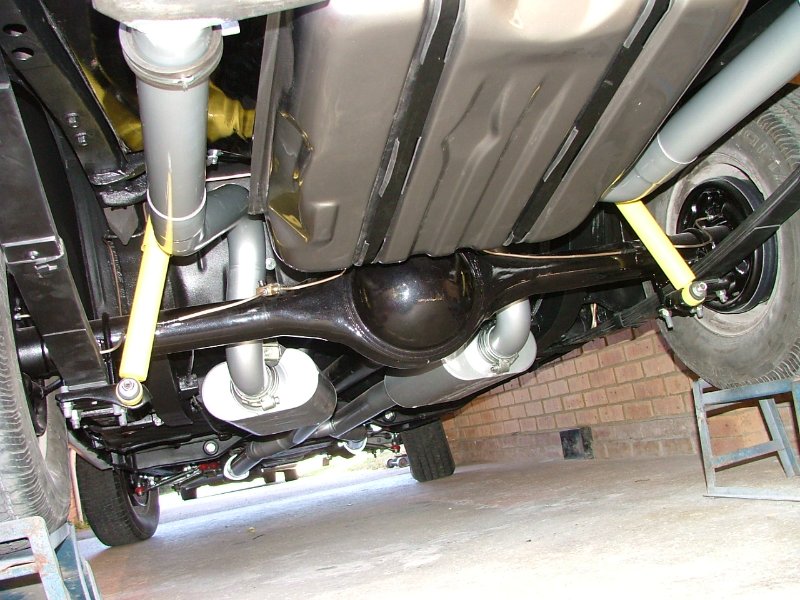

Sigh. I remember when my underside looked as sparkly as that...

I hope you're talking about your car, Morgan...morgan wrote: Thu May 14, 20 3:22 pm Sigh. I remember when my underside looked as sparkly as that...

Cheers guys
And yes it was Barry's, i send him an update from time to time, when its done he's going to come down and spend the day on the coast and have a blast around in the old girl again, (subject to the current messed up state of things!)
Lost count of the hours laying on me back underneath the thing removing all the paint/underseal etc, and thinking i really am too old for this ---t!
anyway thats all done now and doing some of the more fun bits!

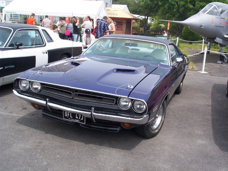

Adam, how did you guess that, I've been in it and under it many times when Barry owed it. This pic is from Brooklands 2005.Adam wrote: Thu May 14, 20 12:45 pm Welcome aboard![]()
That looks very nice indeed. It wouldn't be Barry Holledge's old car would it?
- 100_1978.JPG (133.35 KiB) Viewed 3353 times

Fab pic
Yeah the old girls had a couple of face lifts!
Should be Rallye Red, now Tor Red, should have a black vinyl roof and black trim, now no vinyl and white interior, the faux wood is gone and now moody carbon, pretty much the only thing ive done is to remove the RT strips, as the car was Stripe delete!
