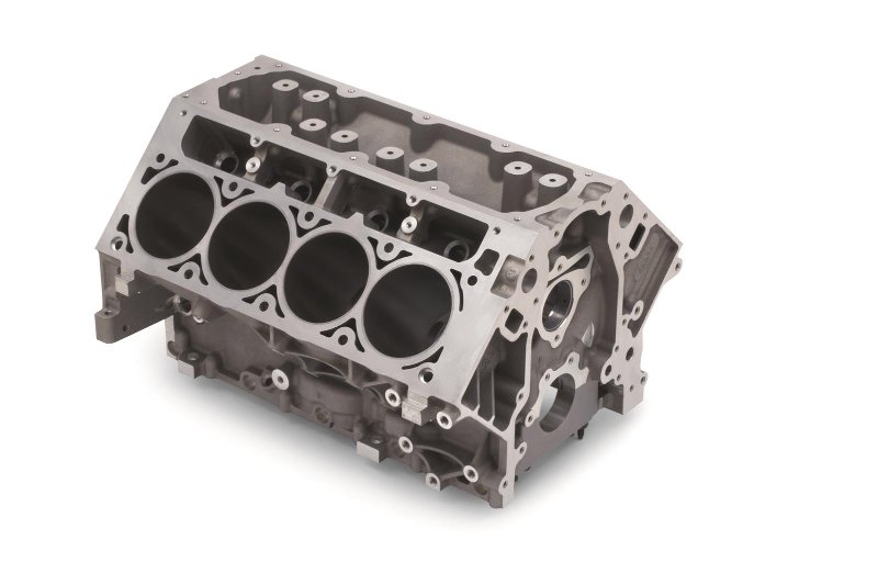

So I gave up waiting for a crate, and will go the slightly more expensive route of building an engine from scratch. The upside is that the finished product will make more HP - around 600 if all goes to plan. John Sleath is doing the build .
Summit fortunately have ally blocks in stock . One has been ordered and should get here this week. Everything else is more or less available. John will build the engine and tune it with a FuelTech ecu, which will include all sorts of data logging possibilities generally for the car - G forces, suspension travel, etc.

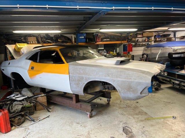

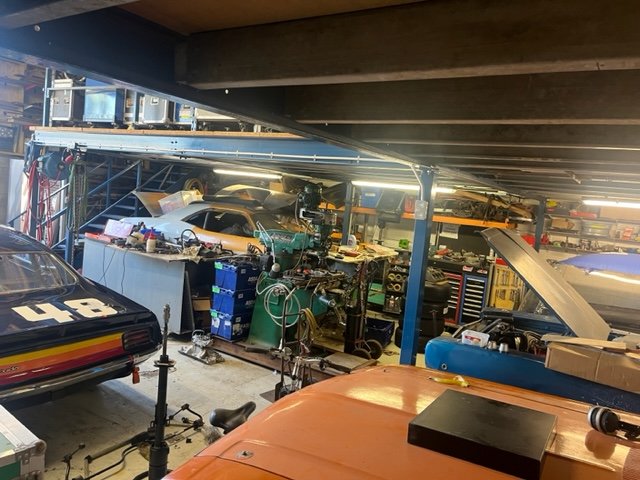

The car has been buried in the corner of the workshop for about a year. I got a few days off work last week, tidied the workshop, dragged the car out of its corner, and bolted on the wings and bonnet for a bit of inspiration. I'll order the steel for the rollcage next week.

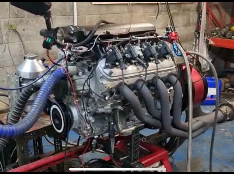

Well they say if you want something done, give it to someone busy.
Looks like I now have a 610HP, dry sump, fuel injected, all aluminium LS small block.
Better crack on with the rest of the car I suppose...
