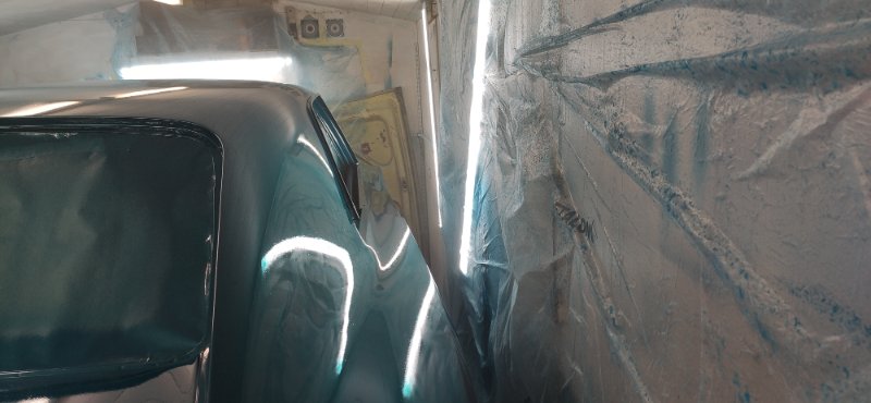

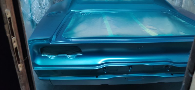

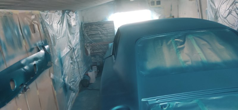

Some pics of the colour.
- IMG_20250114_200633.jpg (49.36 KiB) Viewed 21341 times
- IMG_20250118_202158.jpg (50.52 KiB) Viewed 21341 times
- IMG_20250118_202202.jpg (50.73 KiB) Viewed 21341 times

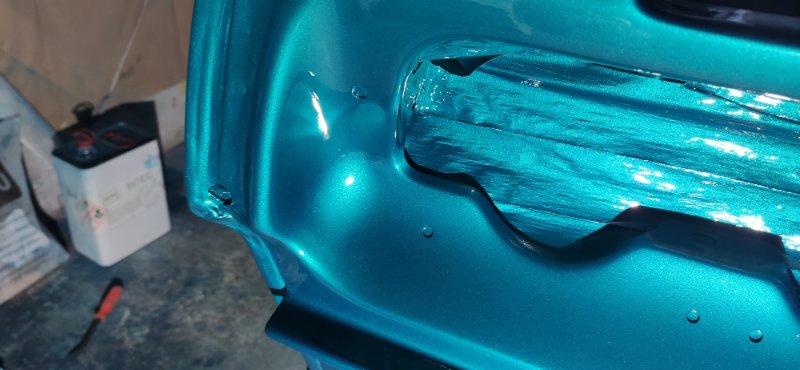

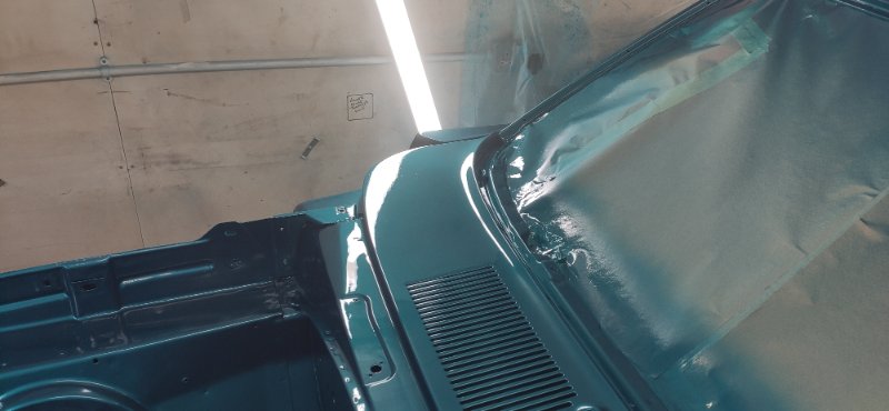

I put the clear on last night. I'm happy with it considering the working conditions I had to deal with.
The gloss is lovely. Little bit of texture here and there to sand back but unfortunately there are a lot of dirt nibs that I hope will mostly polish out.
Here's some pics that make it look better than it really is
- IMG_20250119_224246.jpg (52.09 KiB) Viewed 21278 times
- IMG_20250120_063946.jpg (66.67 KiB) Viewed 21278 times
- IMG_20250119_224031.jpg (58.53 KiB) Viewed 21278 times
- IMG_20250119_223828.jpg (52.12 KiB) Viewed 21278 times
