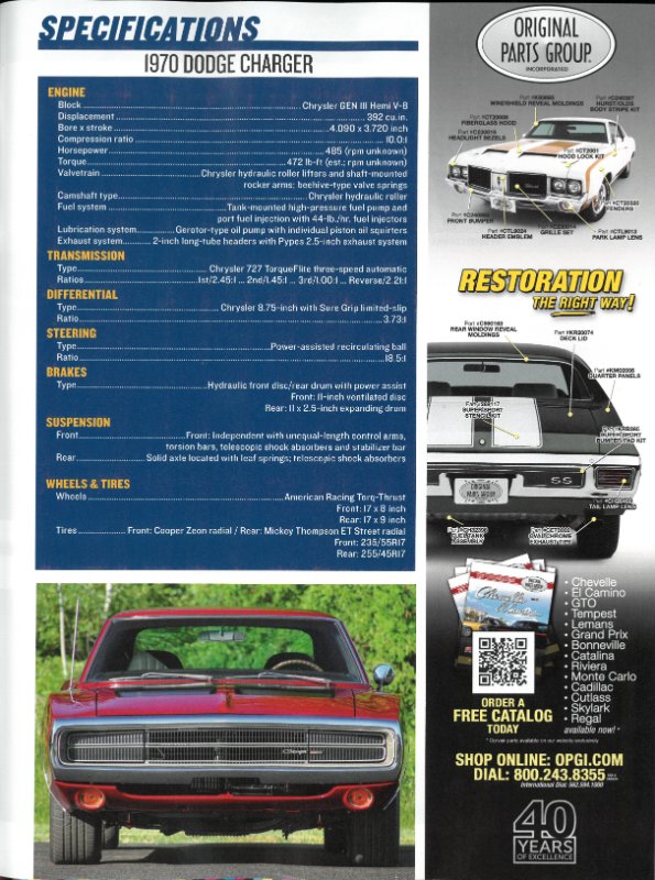

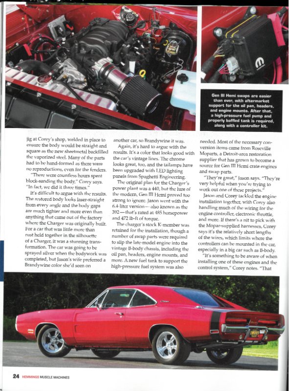

Hi Morgan,
Saw this article in the latest Hemmings Muscle Machines and thought of you...
:-k
70 Charger gen3_1.jpg (102.81 KiB) Viewed 889 times
70 Charger gen3_2.jpg (96.67 KiB) Viewed 889 times
70 Charger gen3_3.jpg (130.76 KiB) Viewed 889 times
70 Charger gen3_4.jpg (141.35 KiB) Viewed 889 times
70 Charger gen3_5.jpg (126.78 KiB) Viewed 889 times
Posts: 4240
Re: Gen3 swap - just general chat
Ooh ! Thanks. Will digest…
Posts: 4240
Thats interesting. He used a 727 gearbox so didnt cut any tunnels about; needed a manual valve body.
The ECU etc seem to be aftermarket and available. All under bonnet (some of the breakers yard engines are mated to the donor car and come with all sorts of dashboard gubbins to make it work).
Engine mounts, oil pans etc all now readily available so no k-member cutting about.
I dunno. It is attractive for a longer term bet... it just feels a bit of a voyage into the unknown compared to 'rebuild and sniper' on something more traditional.
:-k
