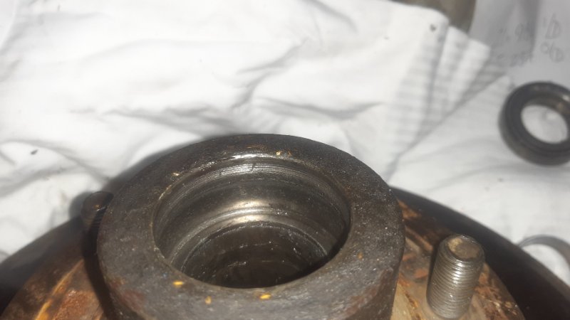

While doing the front hoses noted that drivers side wheel bearing had some play once inside found the nut was done up all the way tight :scratch: outer race looked very new and loaded with fresh grease, seems that the outer race was bottoming out on the tapered section of the spindle :scratch: so decided to knock the races out and measure......

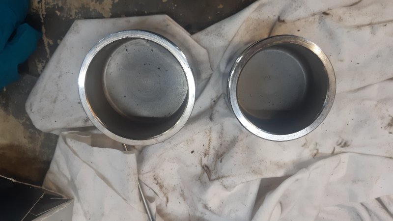

This is what I found, the outer cup was mahoosively loose and the outer part of the hub looks like it's been "pushed" in and because they couldn't get the correct size cup in someone fitted one that would go through the smaller section but then was loose where it should be seated either that or the seat has worn ????? I'll whip the other off and bore mic it. Either way not a problem I can either get a new disc or re-machine the old one

Always good to hear another viewpoint with helpful information, but unfortunately the hub is bananaramerd
I'm guessing that at some a bearing has let go and worn the bore for the outer cup away although in a very uniform way almost like it's been machined :scratch:
Drivers side is 0 .1" bigger than passengers, I could and might try machining it out to the next available bearing size about 20 thou bigger than present o/d with the same i/d, depends whether I can get it running true on a lathe
Or maybe just get a new one? Shame as it looks as though they're the original discs, they're definitely Chrysler made

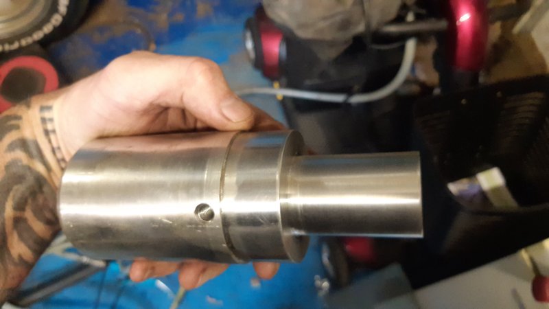

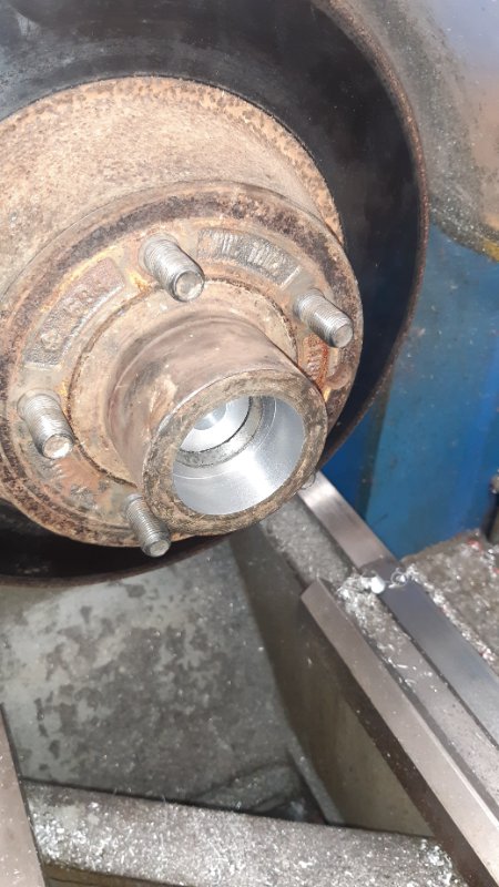

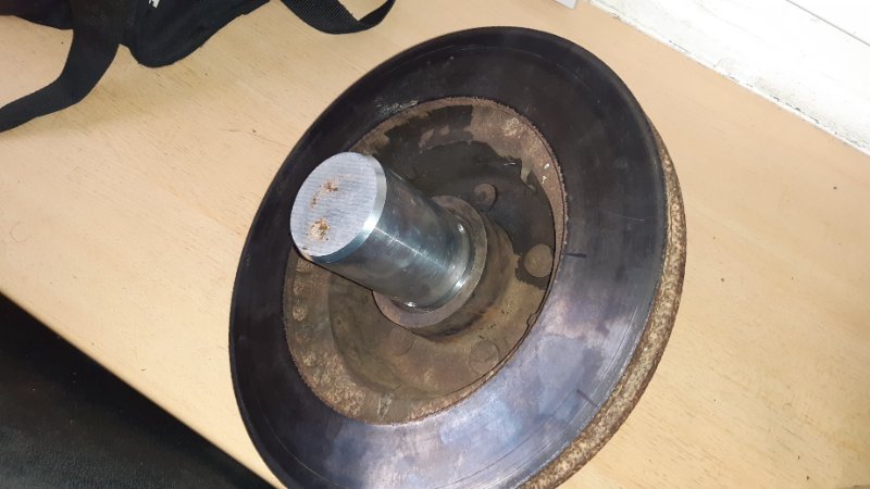

Decided to give re-machining the bearing diameter a go as I had nothing to lose so turned up an ally mandrel to do two things, one to be pressed into inner diameter and almost protrude through so I had a concentric diameter to clock up when held in soft jaws on the lathe
Well it worked better than I could have hoped for with disc face & clocking diameter only running out .002"
Bearing diameter bored out to new bearing size and mandrel pressed out again
Chuffed to bits 8-)

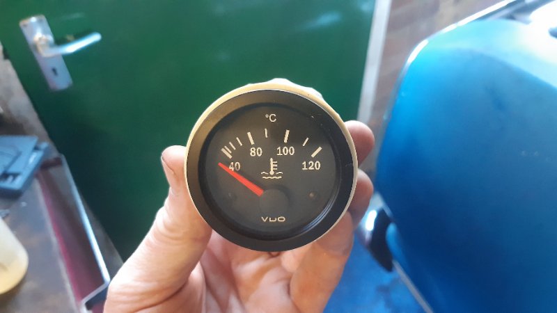

so replacement on its way in the background been looking at getting gauges working oil pressure and fuel :thumbright: ammeter already bypassed, temp gauge is toast and struggling to find someone to fix it so will go aftermarket then long term replace all with aftermarket and either cut dash bezels to suit or make one??

Dashboard wise I have a non functioning temp gauge and long term am going to replace all gauges for new but for now got this
And have decided to fit them into the original dash bezel which will involve some cutting but think this is the best long term solution also probably going electronic speedometer so need to research that

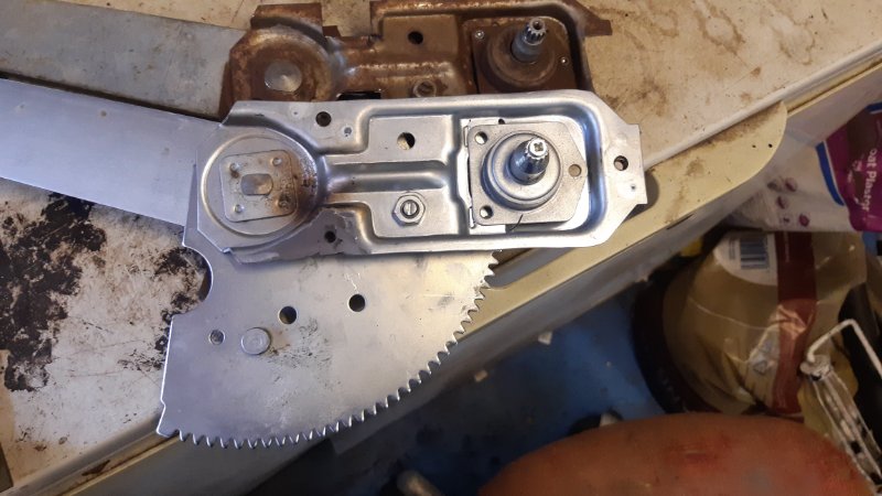

Drivers door & window wrestling has been my latest adventure. The drivers window regulator was slightly lacking in teef :D
I tried welding some more on with moderate success as teeth on small gear worn out
New regulators are available for '77 and onwards trucks but are slightly different as they are riveted in. So welded threads in and then fought to get it in. With hindsight I think it would have been much easier if I'd removed the vent window assy and if I have to do the passenger side I'll try that

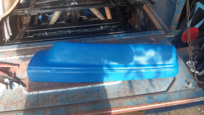

Also made a new arm rest and as you can see upholstery is not in my skillset :shock:
