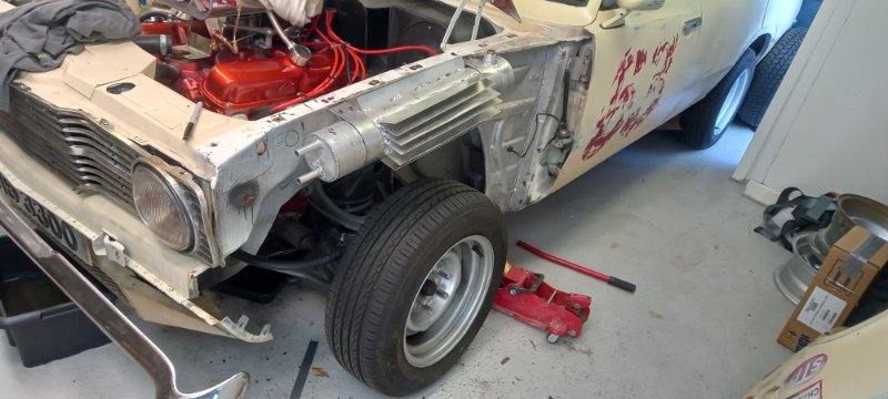

After talking to a guy who builds steam engines..
He said add some more water to the system, as the header tank on the nissan rad is too small. resulting in not enugh coolant in the system .
So I made this which added 41/2 ltrs of water , Using the buypass hose in and outs
All is good now :thumbright:
