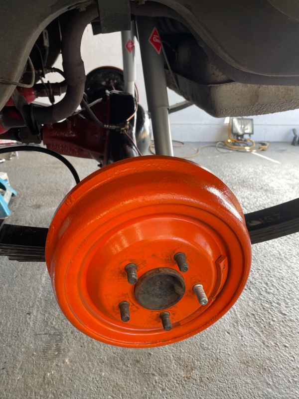

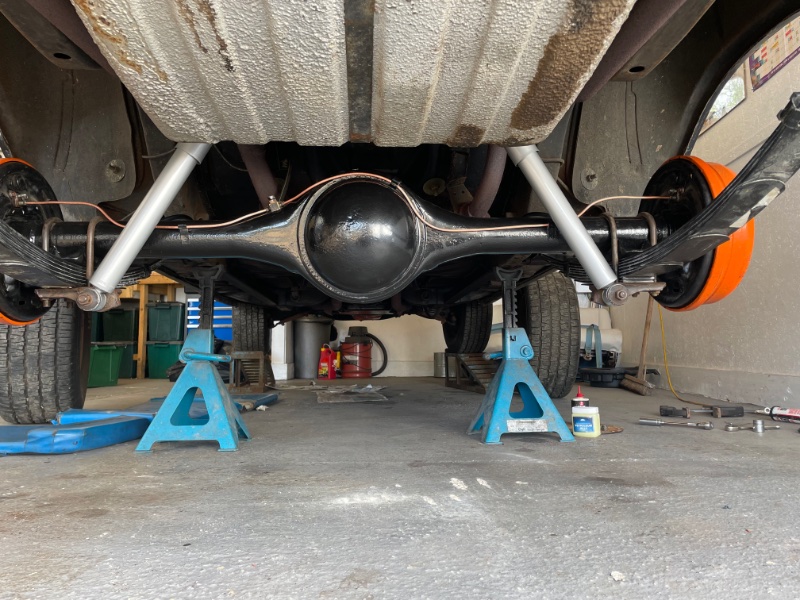

Axle all done. Now has larger 11” brakes, 3.55 suregrip, new green bearings and long KYB shocks.
Posts: 14459
Re: Jason's Polara
Another benefit of the later axle is it’s an inch wider so no more rubbing on the inner arches. On to the front…

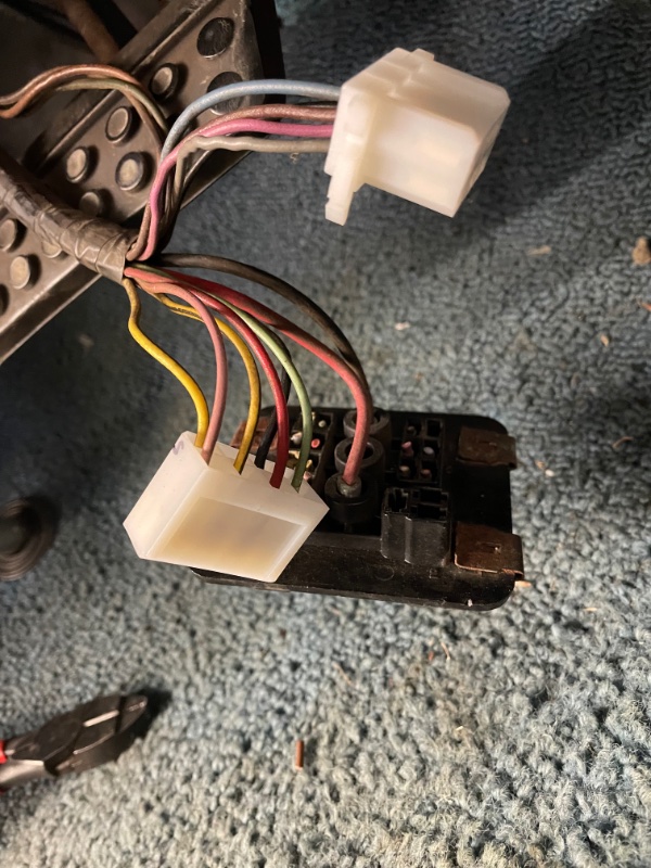

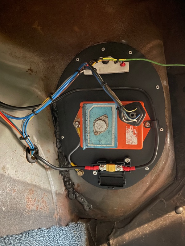

Bulkhead plug is nasty so that’s going in the bin to be replaced by some multi plugs under the dash

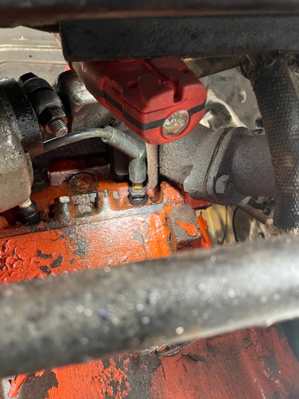

Ally water pump and housing fitted and brackets modified to take a Denso alternator.

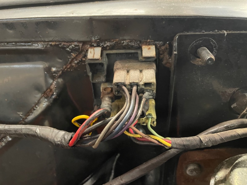

Doesn’t look like the plugs have been changed since buddy holly died….

Posts: 14459
Re: Jason's Polara
Wiring reroute nearly complete, engine bay starting to look a lot less busy now.
