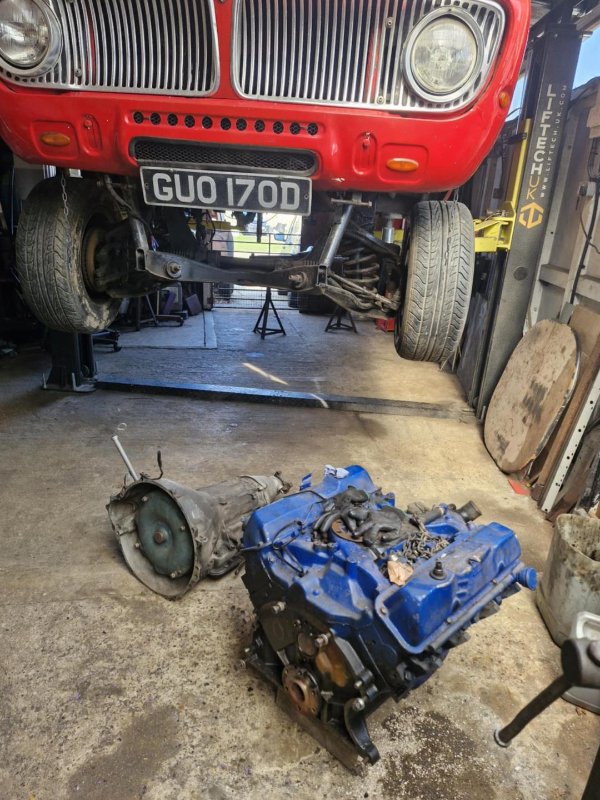

today we looked over ashley's engine and box to see what he needs to get it up and running. then we went over the road to 'check stock' and got some of the bits. then onto the rockauto website and order a dizzy, water pump (his looks to have been weeping), engine mounts and some gaskets. we still need some other bits but that's the main ones and we'll sort the rest here in the uk.

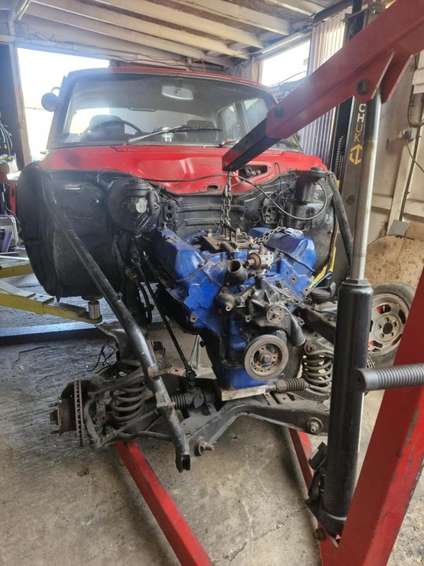

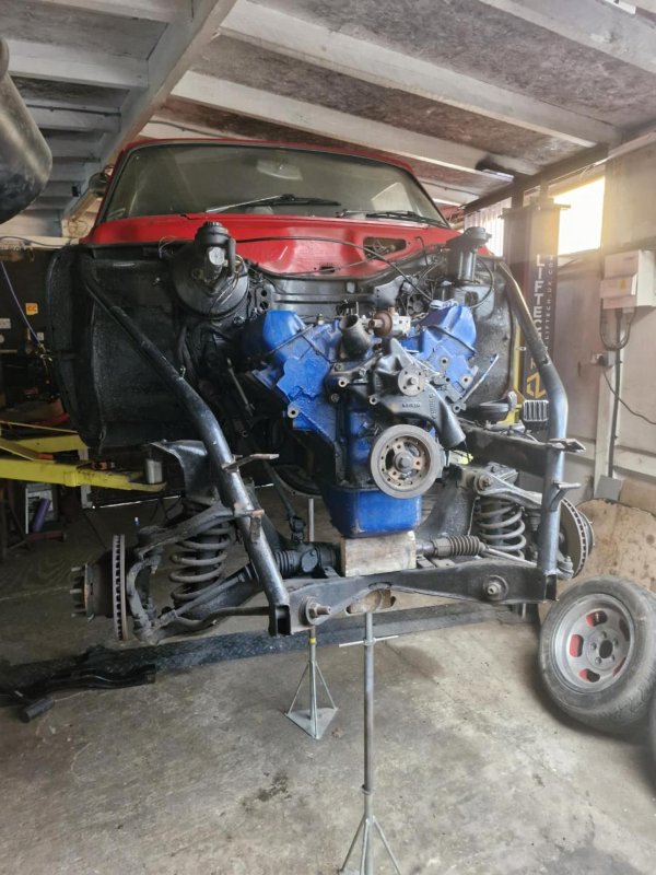

we did some more today, the engine and box are bolted together after sorting bellhousing bolts (sbc head bolts, lol). the flip front is off and over the road and lastly the engine and box are sat in place levelled up waiting for the new mounts to arrive. the gearbox crossmember will need altering (for the 3rd time) but that's par for the course so not a problem.

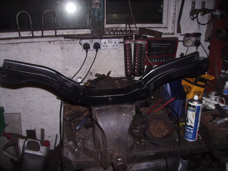

about all that could be done while waiting for bits from the states is the gearbox crossmember. so a new centre section made from 2mm sheet with a tube welded in the middle was spliced into the ends of the old/original zephyr crossmember to marry up to the c6 mounting. nothing exciting really, that crossmember has had a zephyr 4 speed box, an fmx, a c6, a th350 and now another c6 but a different mounting. poor old thing's had a hard life, lol.
