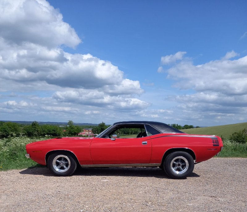

I have 275 x 60 x 15 on the back of the Cuda and as ever the trick is getting the back-spacing right... and the right rear springs of course!!!
Cuda - Superstocks.jpg (108.87 KiB) Viewed 15571 times

Hopefully those rear springs will ride down with wear ;)

I sincerely hope NOT!

That’s a monster of a stance, Pete. :rr:

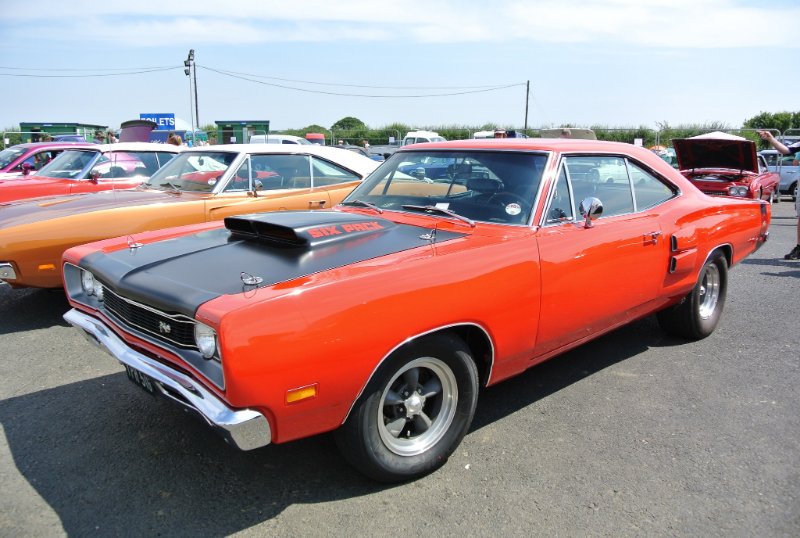

My 6 Pak Super Bee at the Nats - but with "Big and Littles" on it and - as ever - Superstock springs.
Coronets can take a very wide wheel and tyre on the rears if the off-set is right. These are 8.5" ARE's but with a 30 x 12.5 tyre on them.
Pictures stolen un-shamably from Sean Middelton, hence the Proto credit!
Pete Super Bee at the nats 2 - Sean Middleton.jpg (92.55 KiB) Viewed 15332 times
Pete Super Bee at the nats - Sean Middleton.jpg (69.42 KiB) Viewed 15332 times
