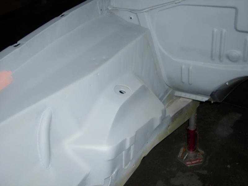

This is the sort of modification needed if you want to get the engine in the correct position and also be able to take the Pass Side Rocker Cover off for maintenance work >
Shock Tower.jpg (23.9 KiB) Viewed 12121 times

Yeah that looks relatively simple to achieve, as long as there’s nothing in the way on the other side ?
I’m guessing there reinforcing metal to support the shock?
Posts: 22174
Re: Hemi into an "A" Body - How hard can it be???
newsatten wrote: Tue Oct 29, 24 2:42 pm I’m guessing there reinforcing metal to support the shock?
Yes, we will need to reinforce the area if we have to cut the Suspension top mount back for clearance. There are several ways of going about this - some people actually install a tube to contain and support the Shock.

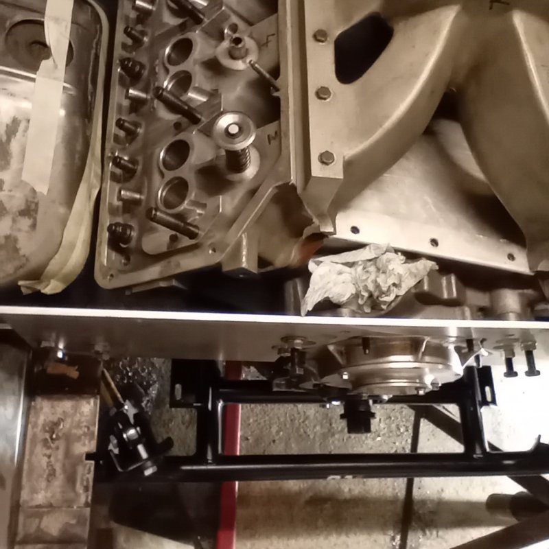

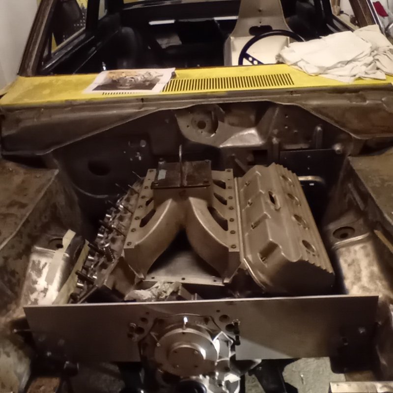

Well, after a lot of gnashing of teeth, measuring, re-cutting, and measuring again - and cutting and grinding again and again, it's IN IN!
Lots of casualties of war:
Engine mount will need to be cut off the (expensive) "K" Frame, Steering Box mount will need to be Bobbed, Brake Master Cylinder will have to go for a long walk, a completely bespoke Steering Column has been fabricated, and it is going to be a massacre of the Pass Side inner Fender and Shock Tower, but it is progress of sorts....
Hemi - Hemi Motorplate Fixed 1 - small.jpg (91.24 KiB) Viewed 10807 times

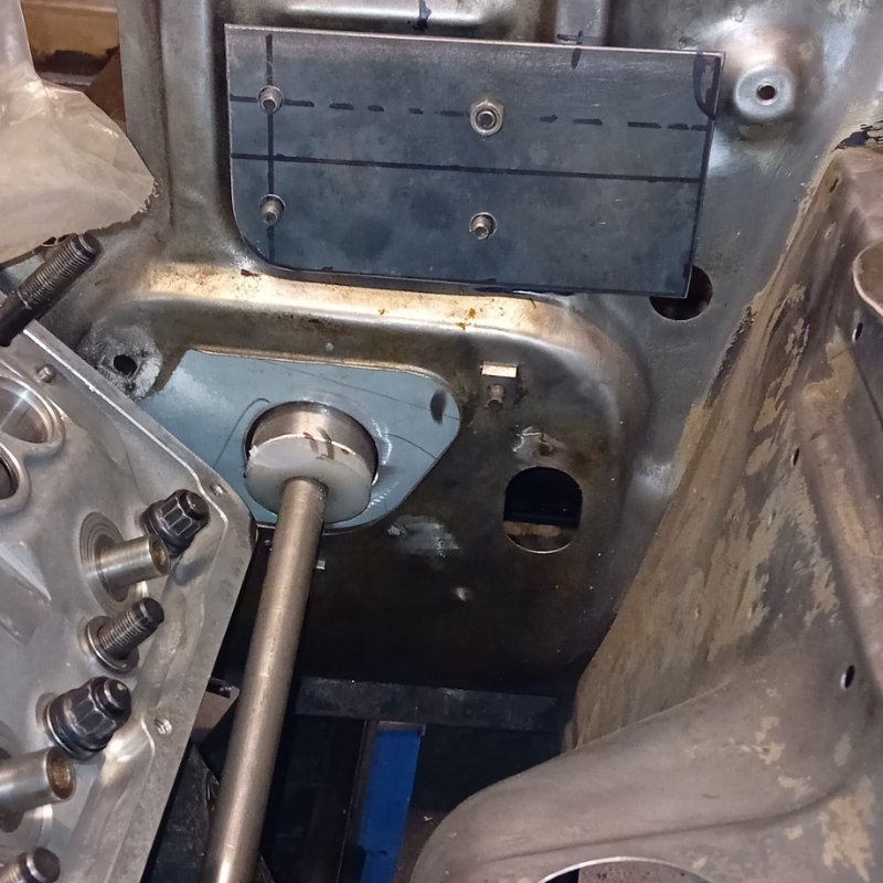

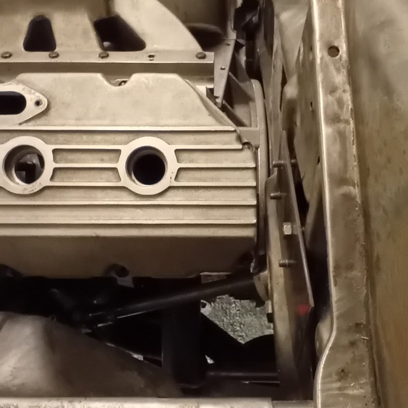

Posts: 22174
/inner Fender....
Hemi - Motorplate Fixed 4 - small.jpg (96.5 KiB) Viewed 10807 times

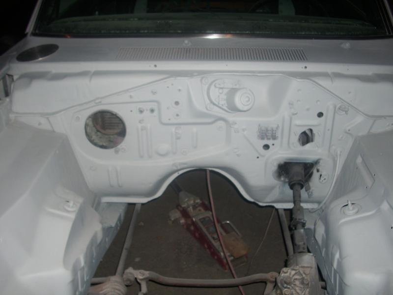

Driver's side Bulkhead...
Hemi - Motorplate Fixed 6 -small.jpg (80.98 KiB) Viewed 10806 times

Where is the Master???
Hemi - Motorplate Fixed 8 - small.jpg (106.76 KiB) Viewed 10806 times

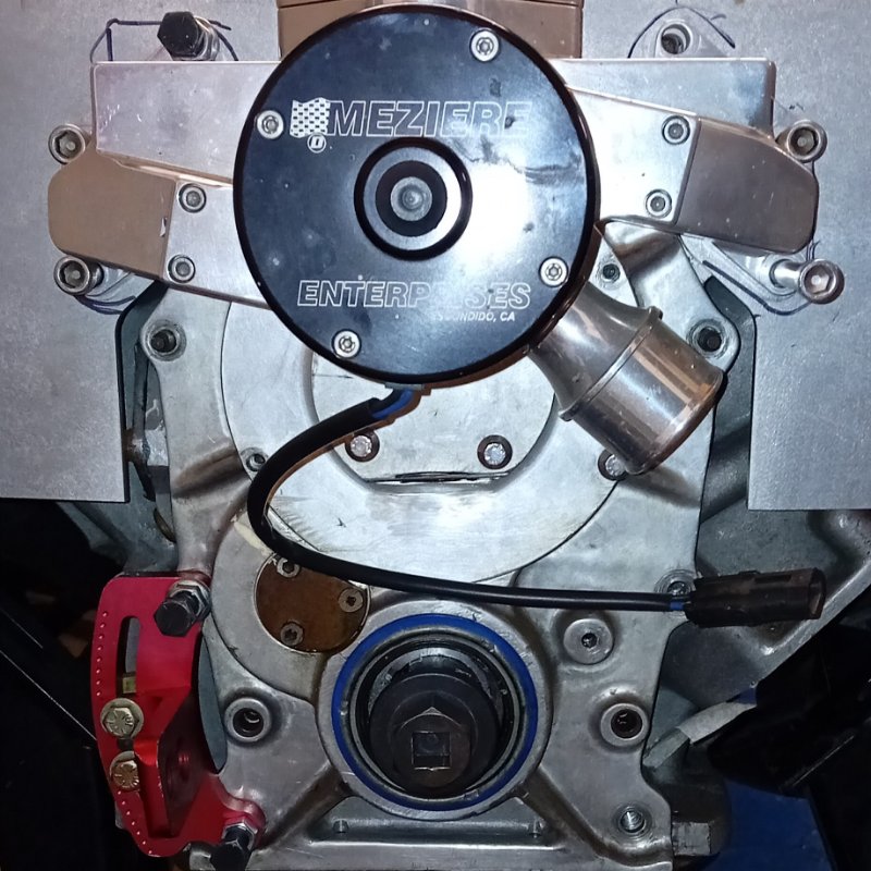

Posts: 22174

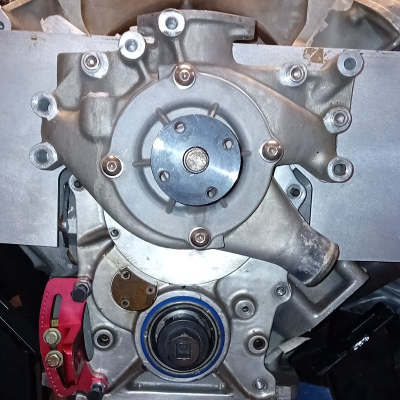

One Water Pump option....
Water pump option 1.jpg (135.89 KiB) Viewed 10806 times
Posts: 22174
Old School Water Pump...
Water pump option 2.jpg (126.67 KiB) Viewed 10805 times
