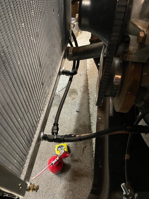

Champion 3 core rad installed, I like these as they are bolt in, stock hoses and shrouds fit and they are fully welded and are a sensible price. Only downside in my case is I need about 1/2” more clearance to fit a viscous fan, I should be able to rework the mounts to shift the engine back a bit, job for another day.

I have a 2800 stall convertor to fit so a bit of additional transmission cooling isn’t a bad idea. I don’t want the trans running stone cold either so the fluid goes trough the standard cooler in the bottom of the rad and then through an auxiliary cooler mounted out front. 5/16” Kunifer for the hard lines following the original route along the side of the engine oil pan changing to AN6 PTFE lined hose to link everything up.

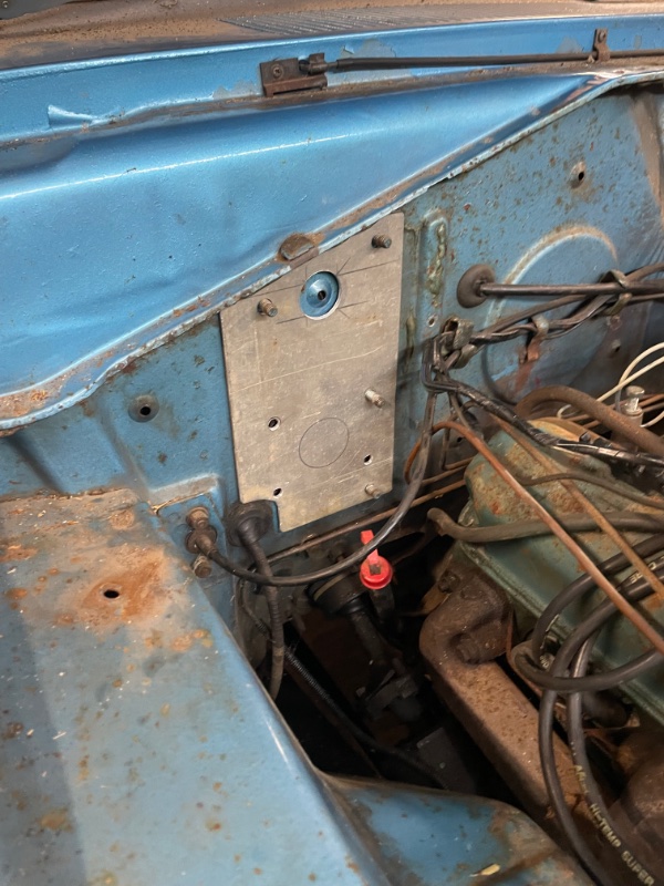

I hate American power brakes anyway but when it’s a monstrosity like this blocking access to everything on this side of the engine it was on my to do list. Whilst struggling to work around it the front brake pipe broke off so it went to the top of the list…
Posts: 14537
Re: And another RHD Barracuda…
First job is to replicate the original mount with an adaptor made of 1/8” ally plate. This picks up the pedal box mounts and additional bracing points and allows me to fit a manual master cylinder in the correct location. Mopar master cylinders have pipe exits to the right, straight into the valve cover if it’s RHD. The only exceptions are Superbird/Daytona and some Hemi cars, not going there. Bit of reasearch brought up a Dorman M98908, correct bore size, connections on the left and readily avilable. Original application is 1980s Lincoln/Ford, 2 bolt mount rather than the usual Mopar 4 bolt.
Weirdly the pedal box already has 2 bolt holes in the correct location for the Ford Master so I assume manual brake RHD cars used something similar.
