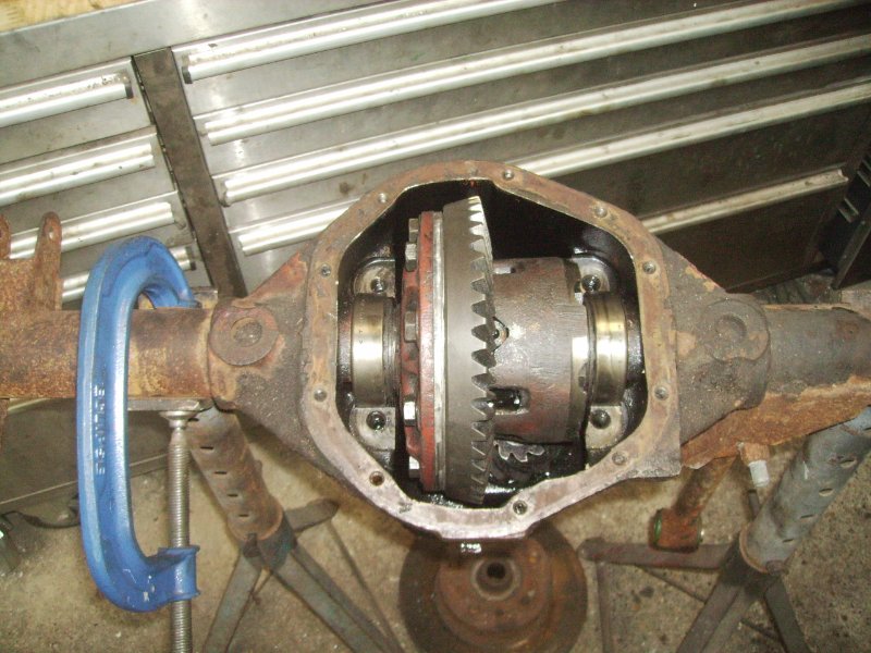

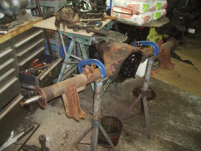

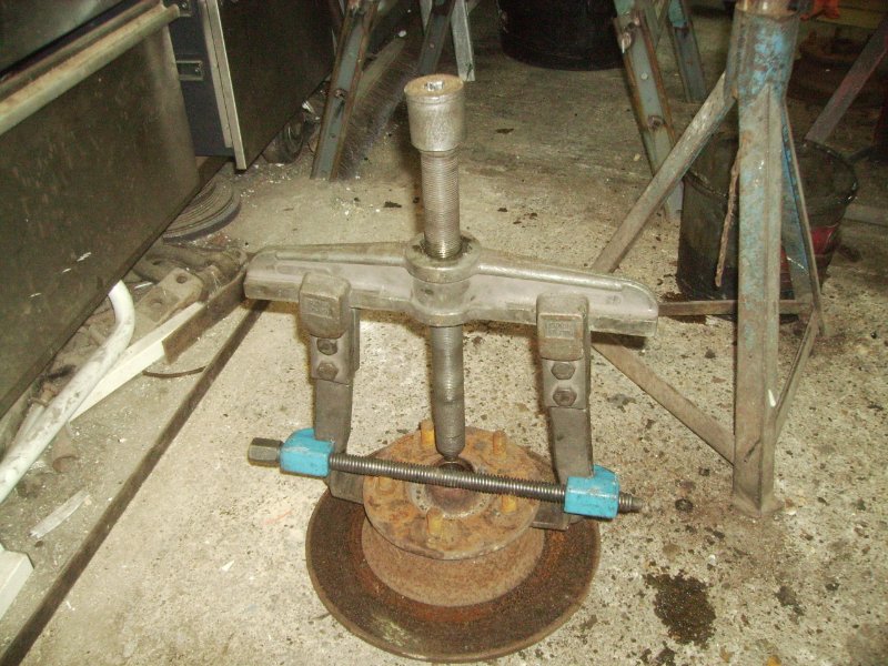

we made a start over the lst 2 days with a open to lsd swap. the lsd is now removed from the jensen interceptor axle and the mk2 daimler axle is now draining ready to pop the 1/2 shafts and open diff. the daimler axle is from my mates 't' beach racer come strip toy. on the strip it'd only do peg leg burnouts/launches so lsd was the way to go. we used my big boys puller to remove the flanges/discs from the 1/2 shafts along with a coil spring compressor. oh and of course we warmed the flanges to help too, lol.
neil.

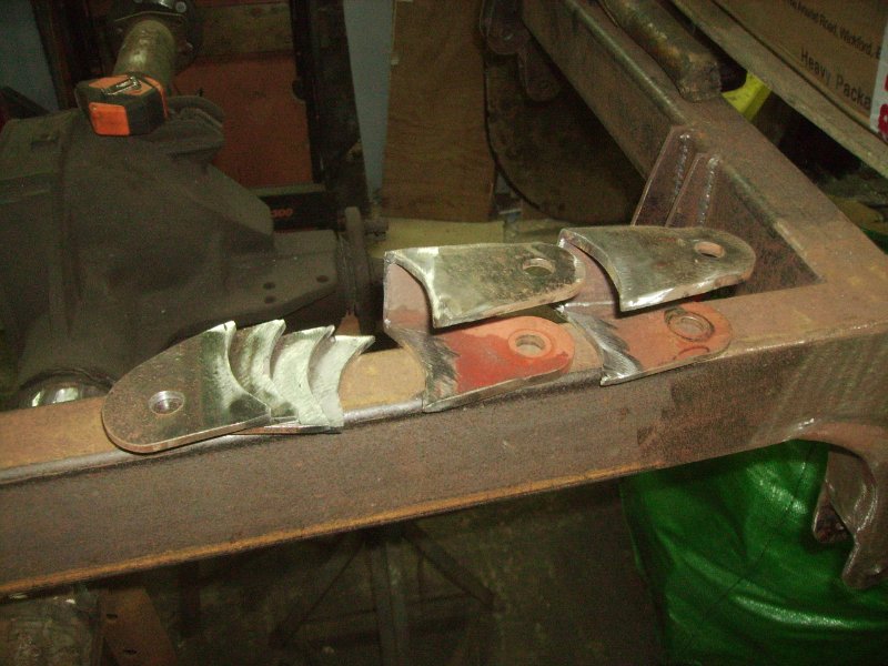

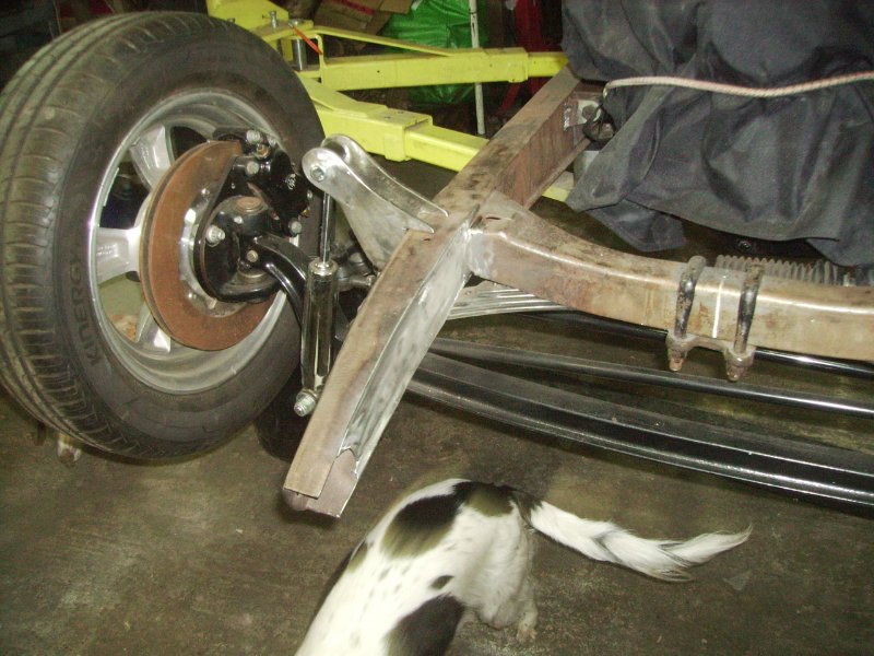

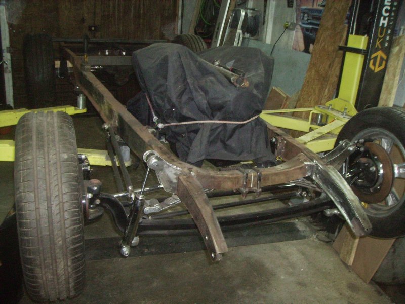

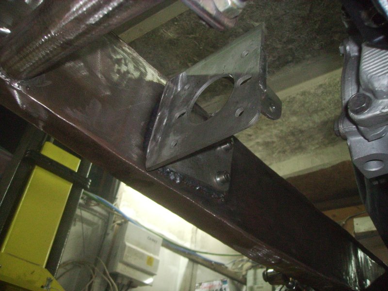

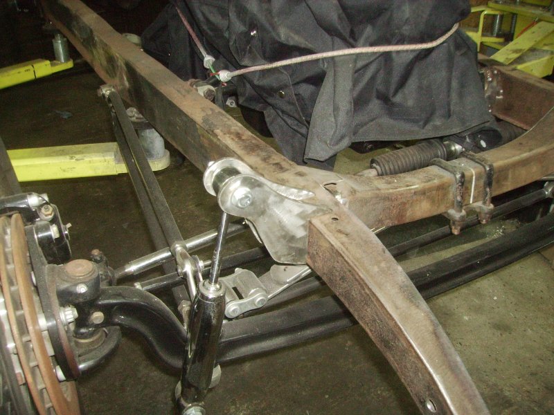

we made a start on the A chassis this afternoon. we step boxed the front of the frame rails to match the rest. next we cut the 4 shock brackets from 6mm plate and they're now bolted in place ready to weld to the rails.
neil.

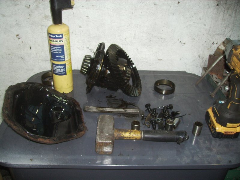

the new 'shims' for the ring gear are made and the bearing shims juggled side to side 'til the gear backlash is right. this was made easier as we'd flap wheeled the inside of 2 used bearings so they were a tight sliding fit on the diff allowing them to be removed and refitted while changing shims. we'll get the new bearings pressed on now we have the shim situation sorted. we ended up with 1x5mm and 2x1mm crown wheel shims (see pic) as that's what sheet i had to get me closest to the just under 7mm we needed. that's the reason for the bearing shim juggling as we'd got the bearing preload set with the required shims already. as soon as the longer ring gear bolts arrive we can get it all buttoned up.
neil.

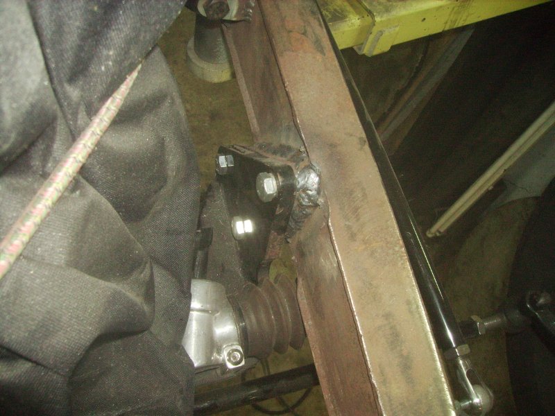

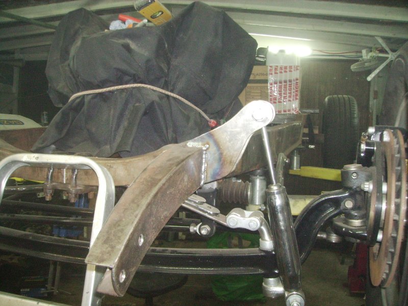

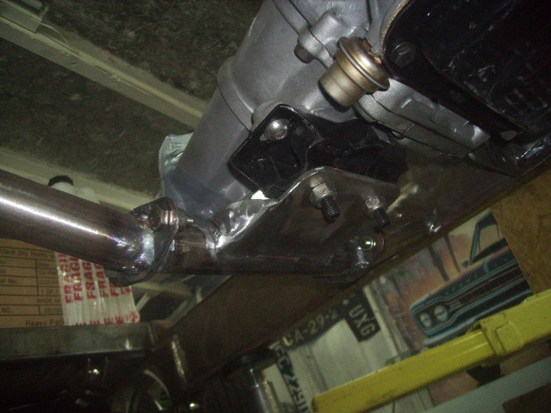

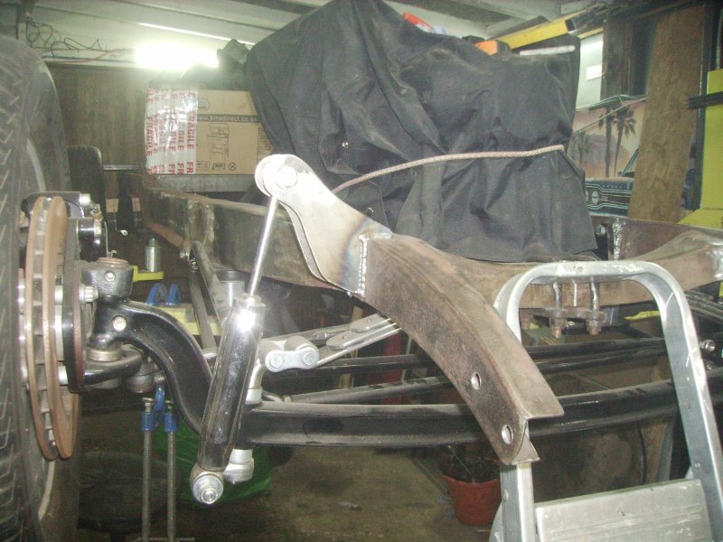

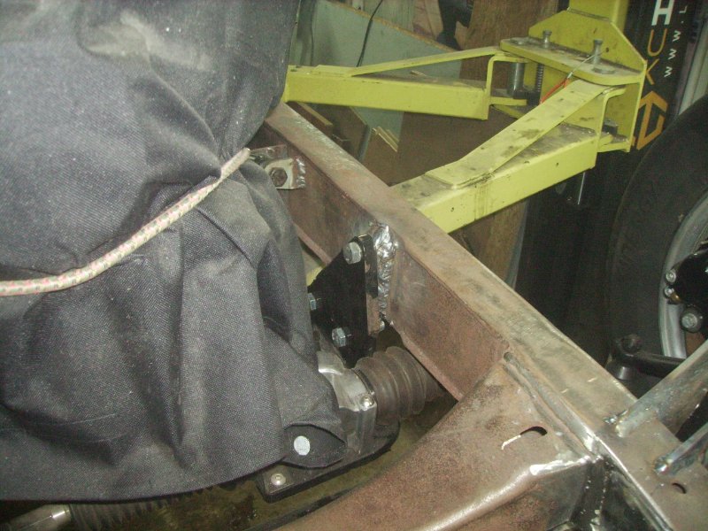

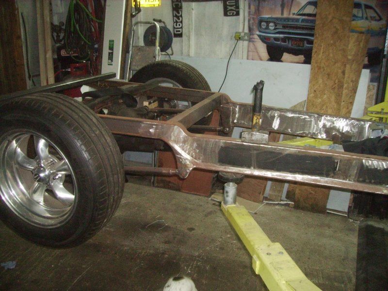

today we welded the front shock mounts to the chassis, the unisteer rack bracket to the chassis, the pedal box bracket to the chassis and the pedal box itself where it'd been narrowed from being a manual pedal box to an auto pedal box. lastly we cut the centre from the gearbox crossmember and welded on flanges to make it removeable. that was after we'd pruned off the old gearbox mounting bracket and made a new one which we of course welded to the centre of the crossmember. so today was lots of welding really
neil.

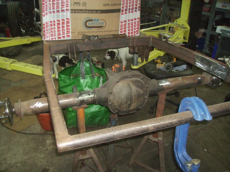

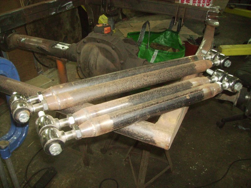

today we cut the rear crossmember, transverse spring and axle brackets off. this was followed by the 4 link bars and axle brackets. we positioned the axle level side to side on 3 axle stands, the 3rd under the pinion flange to allow setting the pinion angle to match the gearbox output shaft. lastly we cleaned up all the axle brackets ready for reattaching tomorrow.
neil.

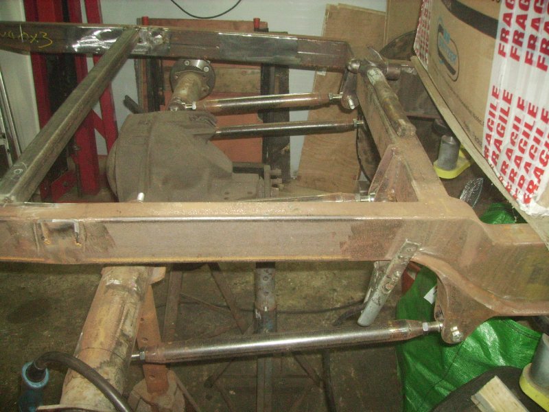

after all measurements were checked and double checked we tacked all the 4 link brackets in place. then we offered a coilover roughly where it'll sit behind the axle to decide where the crossmember needed to be. this was cut to length and also tacked in place. we'll knock up the coilover brackets and get them tacked both to the axle and crossmember next, then blow it all apart to be fully welded. lastly here we have to make and mount a panhard bar which'll just leave the rear discs and scorpio calipers to mount each end of the exploder axle. we're getting there. :thumbright:
neil.
