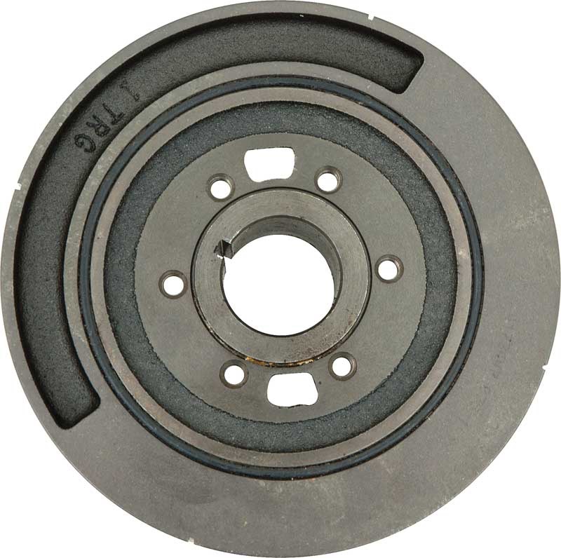

360 was an external balance motor: the damper and the flexplate or converter will have been specially weighted to balance off the rotating assembly. i.e standard it would have a 360 specific damper with an offset weight and torque converter with an offset weight
aftermarket uses a standard converter with a flex plate that has the offset weight added, instead of it being on the converter, some of them look like a circle plate with a crescent cut out
manual the motor would have had a flywheel with 1 big or 3 smaller milled out holes in the back...... if there was ever a 360 manual car or truck
whereas the 318 was internally balanced.
if its been rebuilt they may have internally balanced it or they may not
when fitting you need to take this into account
if its mainly just a standard 360 with a nice new cam lifters, and inlet and carb, hopefully it came with the damper and converter parts
if it has been modified to internal balance......well i think....you could use your 318 parts....
there will be a way to tell by looking at the damper but i don't know how...as i have never owned one,
The hub or radial ring will have a thick bit somewhere but i don't know if you can see that from the front or rear of the balancer

My 360 had a damper like this. The style Dave has highlighted is another possibility.
- IMG_2809.jpeg (161.69 KiB) Viewed 4922 times
Re: Fuel line replacement
Highly unlikely it has been internally balanced, it would take a load of Mallory metal and would be very costly. Weighted flexplates are avilable to work with a 318 torque convertor but make sure you know if its a 904 or 727 you are bolting it to as they use different diameters.
