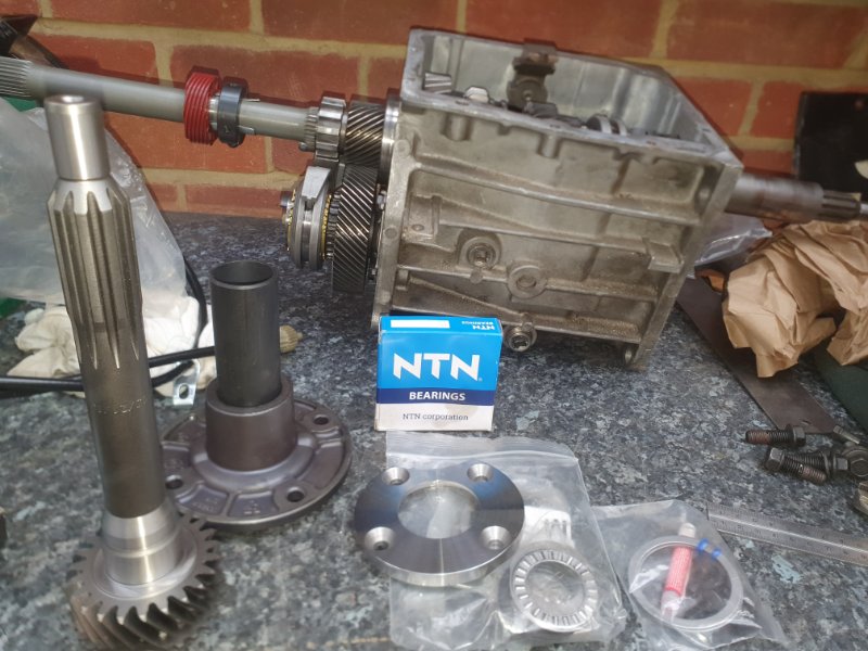

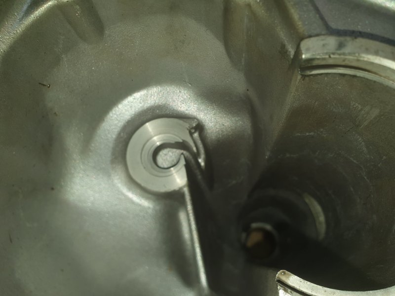

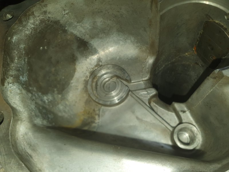

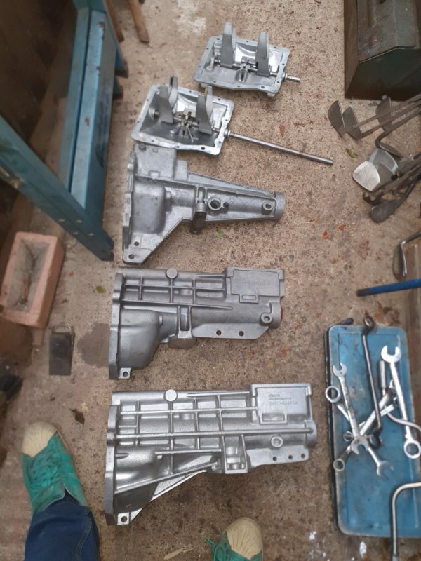

well i had done nothing for over a year so took friday off a messed about with T5 gearbox.
2001-2004 mustang box
i want to be able to trial fit, in car, any one of the 3 housings i have chevy truck, Aussie GM, and Aussie ford.
The chevy S10 truck housing is a hot-rodders favourite. Perfect for putting a T5 in a truck with a bench seat. (or a TVR) trouble is most hot rodders stick with the older weaker chevy t5. they can bolt them to chevy 350 or 4 or 6 cylinder using oem bell housings
this gives me a problem. i wanted a last-few-years ford t5 for its 300 Ftlb strength and much younger age.
$400 transmission was purchased ages ago safe in the knowledge that it was probably Knackerd
turned out it wasn't bad at all, apart from some chipped teeth on the input shaft no other visible damage...

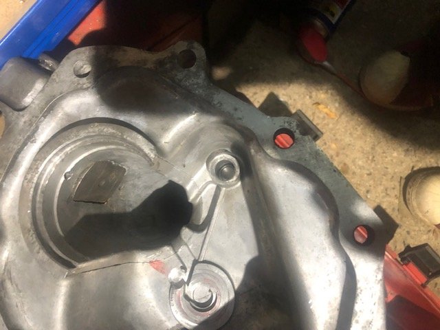

i want to try this housing because i am perfectly happy to cut a new stick hole further forward in the tunnel. in the area that they hit with hammers and cut-n-shut on the production line. what i don't want to do is cut out the torsion bar chassis member in the middle of the tunnel.
trouble is the Chevy housing won't fit a late mustang t5 due to a problem with housing depth in the spiral section that goes behind 5th gear
it also has the speedo drive in the wrong place. engineering shop needed
The Aussie GM housing is almost perfect except the shiftrail wants to go through the torsion bar cross member. the idea was to cut the shifter rail housing out and use a kinked shift rail off an Australian Chrylser specification 4 speed single rail. this is still the plan however i saw the Aussie ford housing which is longer has a further back shift gate box, ford style as well, and may facilitate the same work with a bit more space to spare. so it is a new arrival.
trouble is it does not have the speedo drive boss machined as the car it was used in, used a magnetic pickup in a hub or diff. engineering shop needed
the latter 2 housings fit perfectly, they are designed for a late ford style 5th gear with reverse idler brake, the spiral in the housing is flat and has a section cut out of the perimeter for the tab on the brake retainer, but both will need a different bush and seal for the yoke i have

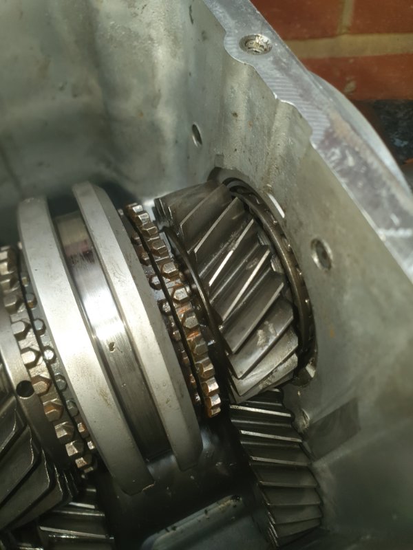

the input shaft teeth are chipped. not the end of the world and quite common. BUT having mis interpreted an assertion by a well known US expert regarding spigot bush/pilot bearings, and had his idea backed up by lots of internet postings confirming, i purchased a pilot for dodge and one for mustang and found out via TIB3300 that you can't just do the swap of the bearings. it turns out this only works if you buy both from a specific transmission specialist in the US.... annoying.
so it gave me an excuse to get a new input shaft.
T5s die when the counter shaft tries to exit the case in a south easterly direction. the bearing retainer is a pressed steel spider that also stretches and you loose preload. so i will take off 5th and use the 8mm thick steel plate from Paul at 5Speeds.com. shimmed correctly should be good for 320-350 ftlb i.e way overspecified for my little motor. standard 4 speed good for 250 continuous.
after a morning of dismantling and measuring the work to add in the new retaining plate was supposed to take place in the afternoon but instead it took a few hours to find a local engineering shop willing to undertake some off the other bits of work
vising the local guy was a waste of time 1/2 hour spent explaining only for him to say i'm really busy as he stood smoking, in front a a silent and empty machine shop.... he wanted the whole job, fit box to car, or none of it. The reality didn't match the website of smiling classic car owners and interesting bits of car being milled drilled and welded
eventually found http://www.denebank.co.uk/ who only do one off jobs
perfectly happy to:-
machine down and shrink fit 3/4 inch sleeve to end of new input shaft in a material suitable for use in a roller bearing
replicate the spiral shape of the ford housing behind 5th in the chevy housing
make me a speedo drive hole in the aussie ford housing. you can't really drill it when one side of the hole breaches the output shaft tunnel in the case. need a proper milling machine
They were even happier when i said i didn't need it by monday... seemingly most want it back next working day
1 tail housing will be used and the rest will go back on ebay when the day comes...with a few of their inadequacies fixed.
with the gearbox on the bench every time i pass maybe i'll get on with it this time

- Tailshaft housings Top Chvey S10 Mid Aussie GM bottom Aussie Ford
- 20210604_112246.jpg (182.46 KiB) Viewed 10063 times
- World class housing for a ford style revers brake
- 20210604_112352.jpg (131.33 KiB) Viewed 10063 times
- Non world class housing for a chevy with no reverse brake
- 20210604_112358.jpg (142.48 KiB) Viewed 10063 times
- The problem loads of gubbins and a TANG that hits the chevy housing
- 20210604_112412.jpg (151.04 KiB) Viewed 10063 times
- Damage to teeth on input shaft
- 20210604_112421.jpg (151.42 KiB) Viewed 10063 times
- New input shaft beraings and a counter shaft retainig plate from Paul cangialosi
- 20210604_112548.jpg (177.34 KiB) Viewed 10063 times
- The spigot bearing issue
- 20210604_112710.jpg (166.64 KiB) Viewed 10063 times
Re: Dave999's Aussie Charger
Whilst I understood about 20% of that (I am getting better) I'd just like to add that a good machine shop is an awesome thing. I needed something skimmed on the charger and fellow did it in a fully-kitted workshop in his garden !
I think at this level of modification though Dave you are 'committed' - no takebacks !
I agree, I am continually amazed at Dave's technical knowhow and explanationness (I just made up a word).
I very much consider myself a parts fitter by comparison. I stop at filter changes for transmissions and will venture no further.
gearboxes scare the bejeesus out of me but luckily i can change the bearing support with a big screwdriver some torx bits a dial guage and snap ring pliers
the kit has peal-able shims
you stick in the original with too much new shim and peal it down with a craft knife until you get a preload in bounds with the book
i think it will be awkward but do-able
input shaft on the other hand is a bit of a pig. internally filled with loose roller bearings which if they fall into the case will stick to a magnet in its base, which is only easily accessible if you take out the main shaft, luckily i have a spare set of rollers .
shaft also needs a cup n cone bearing fitted which i think can be done with a bit of pipe and a mallet.
it too needs to be shimmed.... but only once the other end is done and the rear case is bolted up..
i had planned to do it this weekend but, we have a big damp patch in a wall in the wooden building in the garden that liz uses as an office plaster board behind book shelf is a right mess, investigation proved good if rippled exterior paint with not a lot of wood behind it rotted out from the inside, like a volvo 740, presume water getting in somewhere up top and sitting in the internal insulation.
so i have about 30 meters of ship-lap coming and my weekend will be shed/garden office restoration. once done though i can build a shed next to it and it will be MINE all MINE..it will be donated to everyone else so i can have the other shed with electricity and the workbench in, they just don't know the plan...YET
method to my madness

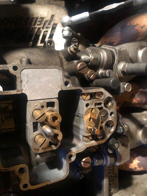

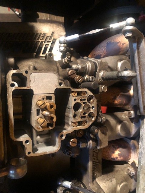

I had replaced the accelerator pump rods with longer throw after the HRDs last year, the aim was to get rid of an off idle flat spot
some winter driving has indciated that it did indeed, get rid of it, but the pump shot is now too much when the air and engine is cool, and i can easily flood it. Which i found out at the lights right in the middle of town...
Carbs orginally came equipped with 10 mm pump shot rods which were for a DCD not a DCOE. flat rods ! ? pic to illustrate, dunno why, must have been a parts shortage or something.
I moved to 15 mm rods in october... and sitting in ethonol rich fuel since then has corroded off their plateing.
I wanted DCOE style rods with the round shaft...i waited 3 months for some appropriate 10mm shot rods to arrive and fitted them.
reset Float height and droop
height at standard is 12.5mm from top cover... set at 11.5 to raise level in bowl 1mm. which should bring in the main circuit earlier
all good.
Went for a drive flat spot reduced, at least by different means and i don't drown my plugs with an over long pump shot.

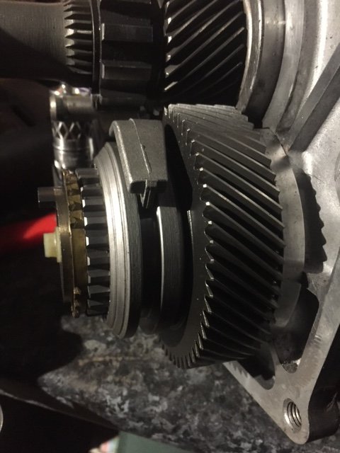

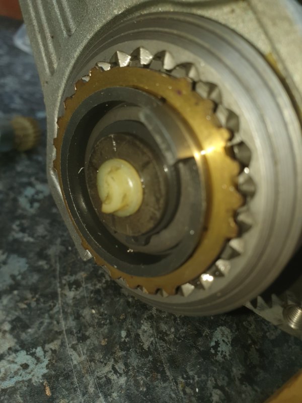

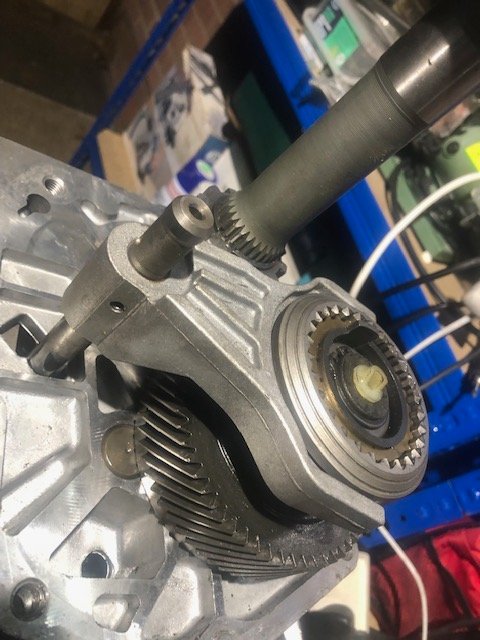

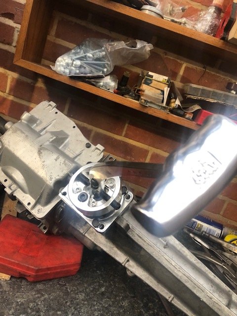

next up to avoid having to do any hard work i hid in the shed and messaed about with the T5
Its been sitting on the bench laughing at me for 18 months and progress has been slow
I've decided to go with the front shift tail housing
this is a 1980s housing and the transmission is a 2000-2004 version
previoulsy i had the housing modified to fit
I'd also removed the 5th gear, its syncro and slider and the 5th reverse shift fork to fit a steel counter shaft support kit.
all work appeared to be successful.
the rear housing and shifter was all fitted up about 9 months ago and i selected every gear and found i could not get into reverse...
i walked away....
since then all parts i have touched have been dismantled and rebuilt numerouse times to establish what i'd done wrong...until i was well and truely fed up with the whole lot...
top cover 5th gear sycnro slider and strut pins etc etc
still couldn't get reverse.
So Turns out it was a simple fix. I just needed a long period of inactivity

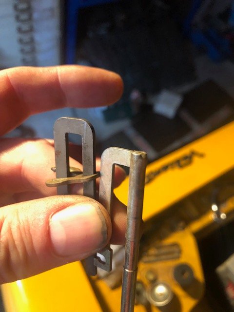

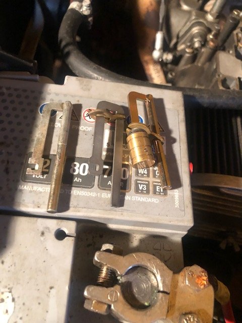

The reverse/5th shift rod that holds the aluminium shift fork on the back of the trans is longer on later versions of the transmission becasue the tail housing orginally fitted is of greater volume...
the issue was when changeing into reverse the shift fork movement was not great enough to engage 5th gear becasue the shaft it was on was running in to the housing when bolted down.
3 ways to fix....
Dismantle transmision completely and swap to early set up.. NO
bore case to greater depth... rather you than me... looks to be 5mm thickenss that i'd need to take down to 2-3mm.....
remove the unused profile to the end of the shaft without removing the smooth section that is of appropriate bore for the hole in the caseing it fits into....That will do it...
so the trans was dressed in dust sheets and out came the grinder the file and some 1200 wt-n-dry....
in my excitement i failed to take photos but I now have a trans that will shift into all gears...Yay!

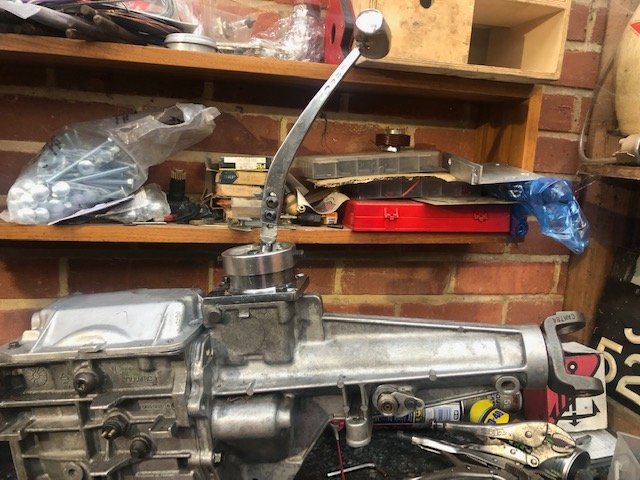

next was to put on a better shifter than the rusty old chevy one
shifters for ford transmissions cheap and often chinese
shifters for chevy transmissions different size and bolt spaceing and way more expensive
I chopped up a ford base and drilled it to fit the chevy housing
then disovered bad threads in 1 hole in the housing. the only failure on the day... i can deal with that helicoil here we come.
Topped it off with a CUBE "get your shift togther" Its an Aussie Brand, swept back stick, and a Scat branded T handle off a custom VW shifter
Now the whole thing needs to come apart (gears will stay in place) for a flush out and the application of the torque wrench and appropriate sealant
all good.
3 ways to fix....

- Corroded 15mm, Flat DCD, new 10mm pump shot rods assumebled with spring and piston.
- IMG_0169.jpg (60.16 KiB) Viewed 9452 times
- Top of DCOE with no accelerator pump in it
- IMG_0170.jpg (68.58 KiB) Viewed 9452 times
- Top of DCOE with acclerator pump installed.
- IMG_0171.jpg (67.22 KiB) Viewed 9452 times
- flat DCD rod to left round DCOE rod to the right.
- IMG_0172.jpg (73.14 KiB) Viewed 9452 times
- The aluminium shift fork is mounted on a shaft/Rail that has a profile end which hits the housing
- IMG_0167.jpg (99.57 KiB) Viewed 9452 times
- the 5th/reverse shift rail fits into the hole in the casing near top of picture
- IMG_0168.jpg (55.51 KiB) Viewed 9452 times
- Scat Knob, Cube shifter Hcked chinese ford base
- IMG_0173.jpg (74.75 KiB) Viewed 9452 times

- See that shiny steel bhind the big 5th overdrive gear..thats the new steel support for the contersshaft bearing... shims under it tyo set counter shaft end float/preload
- IMG_4507.JPG (55.36 KiB) Viewed 9435 times

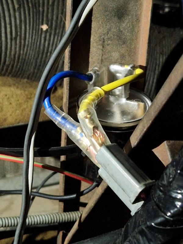

- Flasher, should have made a better job of trimming the wires after crimping, could not face taking the jackets off again.... its robust enough. photo wrong way round needs to turn 90* anti clockwise
- 20230121_164322.jpg (184.13 KiB) Viewed 9367 times
