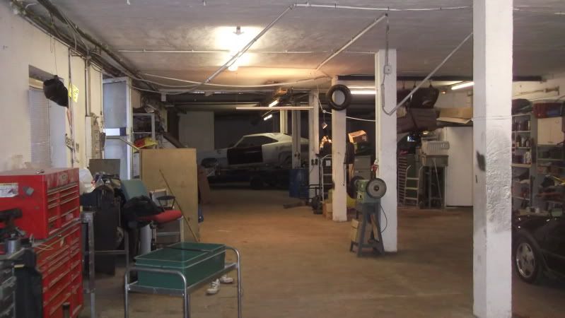

I am now renting the garage next door so i took the wall down and have been cleaning brickdust up.

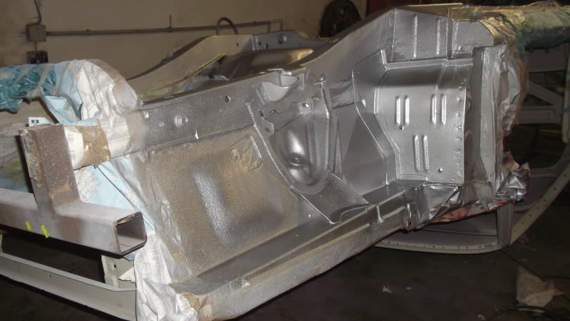

So first sorry Jim its not 2 strips of original factory primmer but it will stop it from rusting
1st rub and rub again
2nd 2k primmer
3nd seam sealer
4th Stone chip (smooth) Smooth my arse.
5th Mclareen f1 chrome finish paints
6th Scratch proof clear lack 3x
Look more like solar reflective flat roof paint but im happy and makes a change from black
<a href="http://photobucket.com" target="_blank"><img src="http://i73.photobucket.com/albums/i205/ ... /027-2.jpg" border="0" alt="Photobucket"></a>
<a href="http://photobucket.com" target="_blank"><img src="http://i73.photobucket.com/albums/i205/ ... /028-2.jpg" border="0" alt="Photobucket"></a>

Yes i did get permission im now renting both garage
Now have 40m long by 10m wide with big door and no ramp :thumbright:

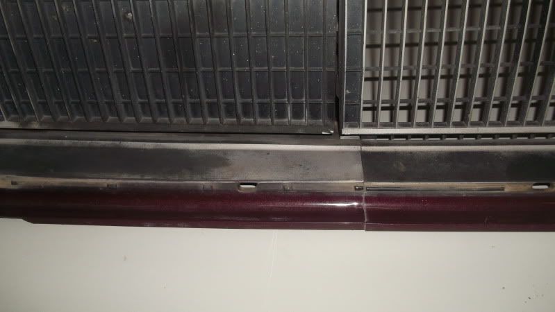

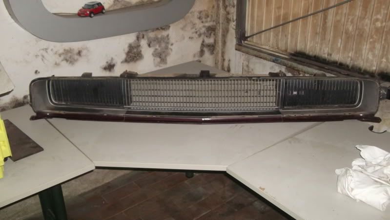

Q. :help: :help: :help:
The grill is painting body color at the bottom
What is the correct color for the grill parts ??????? :help: :help:

Bottom edge of grill is painted satin black and when I did my grill resto I painted all the silver with wheel silver. This is one of the most fiddly jobs.
All the info you need is here.
http://www.dodgecharger.com/forum/index ... ic=39926.0

If you have brought the bolt kit with the big plastic washers for the top and bottom of the grill the bolts that come with the kit are 6mm short so make sure you have some other bolts. I e-mailed the place I got mine from and they didn't even reply to my e-mail.

ANTON wrote:Bottom edge of grill is painted satin black and when I did my grill resto I painted all the silver with wheel silver. This is one of the most fiddly jobs.
Perfect many thanks :thumbright: :thumbright:
