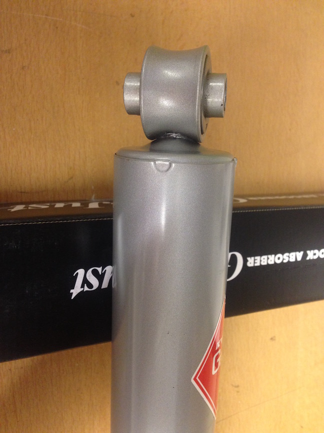

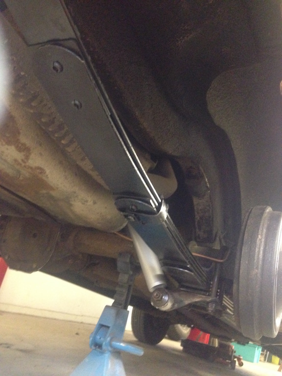

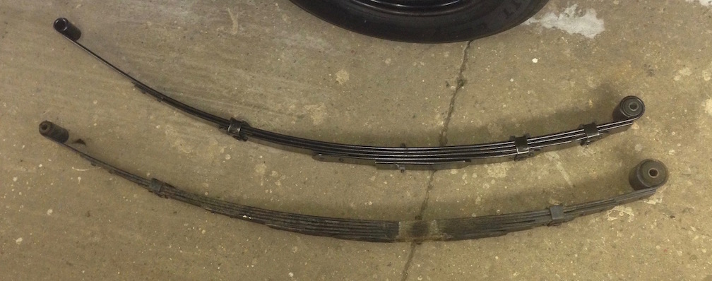

Fitted a pair of "002" & "003" super stock springs as fitted to the Hemi A bodies. You can see how much these differ from a stock spring, it's not just a higher ride height. As this is a street car I used KYB shocks instead of the usual longer drag shocks. A pair for a Dodge Dakota were long enough with just the tube to press out of the top bush and a couple of washers either side and they bolt right in. I didn't buy the cheapest rear spring bushes, instead I went for AC Delco which I thought would be decent quality, they are too loose in the spring so don't buy those....
Out of interest Blue , how did you get to the Dakota shocks ?
:read2:
Posts: 14537
Mancini list a KYB shock for use with S/S springs, when I checked their part no. that was the original application so I ordered a pair from Rock auto when I was getting some other stuff.
Interesting in the Dakota shocks. I ordered just normal Dart ones when i picked all this up a while ago.
Keep me updated on the bush you go for for the shocks please Blue. I need to order the same as ive got the same SS Springs! :thumbright:
Posts: 14537
All I did was use a hydraulic press to push out the tube, removed the shock stud from the car and pressed that in instead with a couple of washers each side to take up the width. Job done no need to use a different bush, the tube and the stud are the same diameter.

I guess the Dakota shocks were an inch or so longer?
Posts: 14537
More like about 3" longer, the standard shocks are way too short.

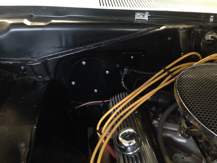

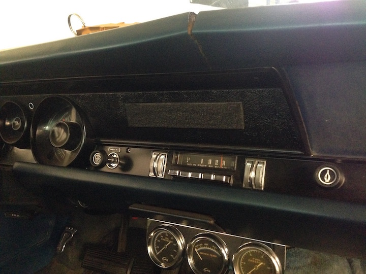

Posts: 14537
I tried, I really did but it's just no good, heater delete is the only way forward...
Posts: 22176
That Radio looks heavy.
You can see which way this build is going.....
Posts: 1680
:lol: :lol: :lol: :lol:
It does look a tad on the weighty side don't it???
