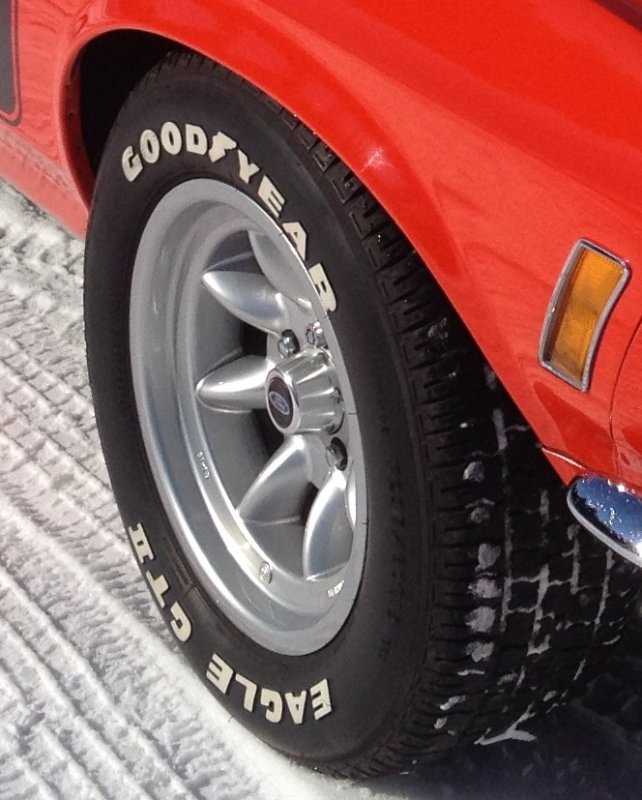

I'll get the wheels in time for the Nats if I'm lucky . There are two styles of Minilite available apparently:
1) The MA (Minilite Alloy)
Mustang 02 8.0x15 Anthracite.jpg (66.85 KiB) Viewed 1810 times
and
2) The TA (TransAm), with pointier spokes.
The TransAm (unsurprisingly somehow...) Is one I want, and there's currently a 4-week wait for the 5-stud blanks to arrive with Minilite.

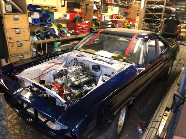

Bit more progress.

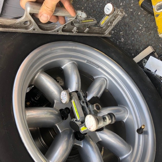

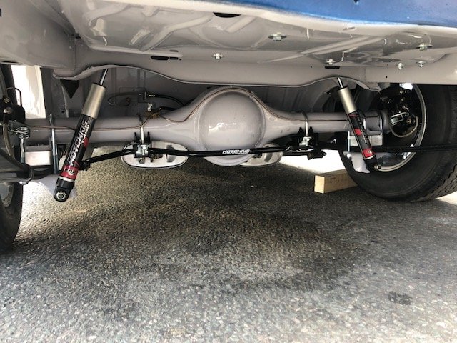

Rear end finished. Apart from custom Panhard Rod / Watts linkage , which will have to come later

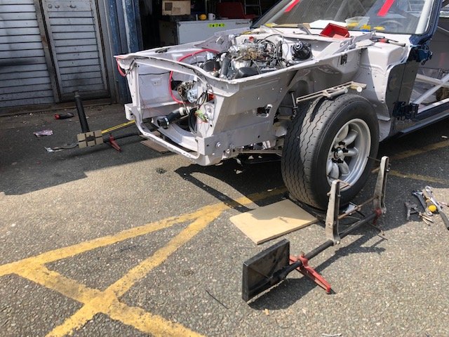

Aligned the front end before fitting the wings - much easier to get to all the bolts etc
2.5 degrees negative camber, 6 degrees positive caster. Thank you Hotchkis !
Sorry for some reason this pic won't rotate properly.
Toe in about 1/4 degree

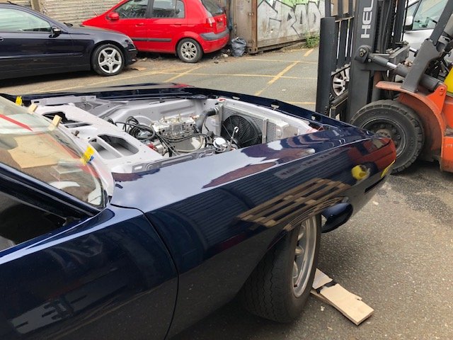

Got the outer panels fitted and broadly aligned. Not perfect , but then it is a race car.
Radiator back in after re-welding of brackets due to pinholes.
The car's going back to the painters now for touching in, re-clearcoating, and polishing.
First minor issue - the exhaust is way too loud. It's around 105 db at 4,500 rpm and will need to come down by 5db or so, which is a lot. I've got some slim resonators which I'll plumb into the H-pipe next to the prop, where I think they will just fit . If that won't work, I may have to go conventional rear-exit exhaust, with a second pair of silencer boxes where the fuel tank used to be.
Posted: Tue Jul 09, 19 4:47 pm
by Matt74
Looking great!
Good thinking to do the alignment before fitting the wings.
Posted: Tue Jul 09, 19 7:26 pm
by ScottyDave
Yes it's looking sweet :thumbright:
Posted: Wed Jul 10, 19 6:51 am
by cadboy
Love it :thumbright:
colour is very nice

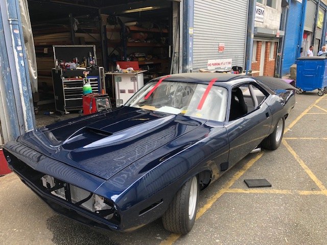

Posted: Wed Jul 10, 19 7:52 am
by Dom66
That last pic looks great, you can really see the effect of the work you did on the rear arches :rr:
Posted: Wed Jul 10, 19 11:25 am
by Pete
That sticky-outy Exhaust looks good and authentic but will make the noise level worse.
You may need to run a system under the car and just have those stubs for show....
Posted: Wed Jul 10, 19 7:15 pm
by DaveB
Awesome Matt :thumbright: ,I wasnt aware there is 2 styles of minilites,you learn something everyday :thumbright:
Posted: Wed Jul 10, 19 9:13 pm
by sublimemike
That hood has turned out really good.. are you going to fit some hood pins?
