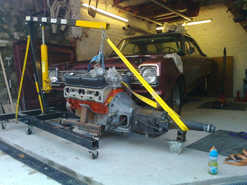

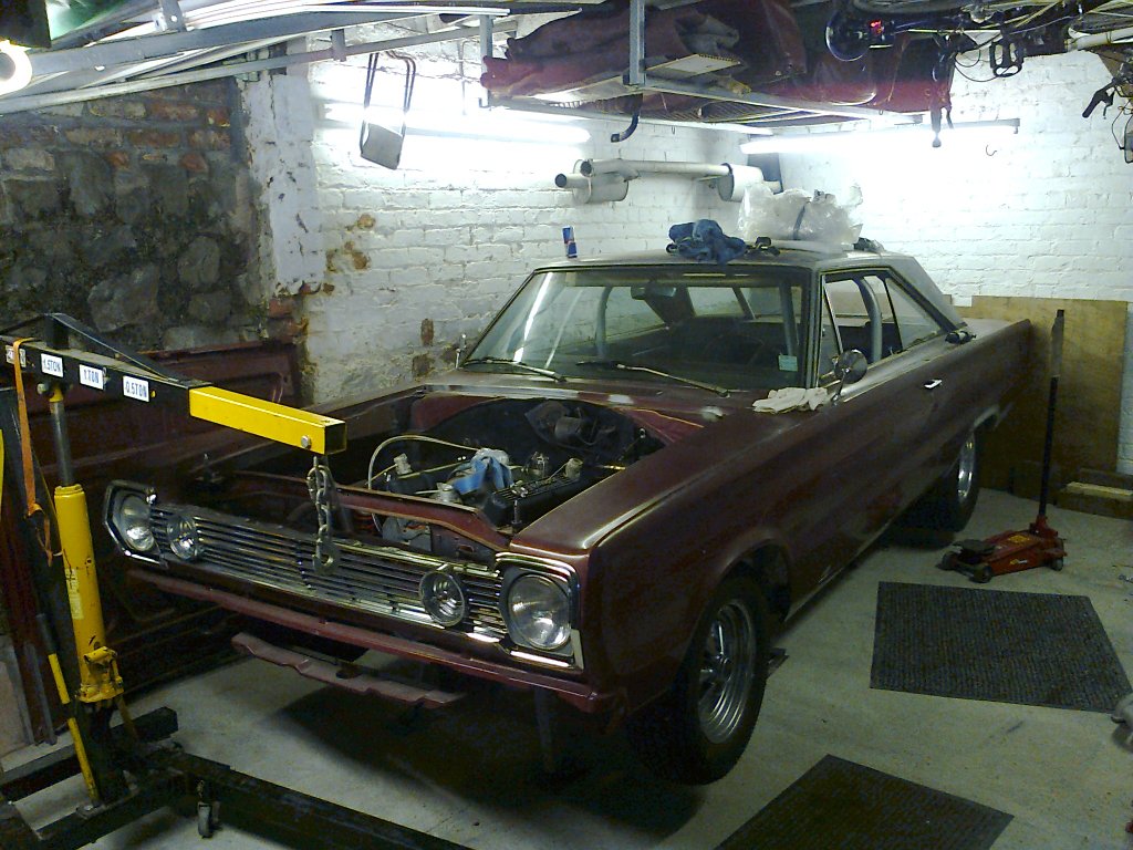

MOTOR'S IN! :D
First i got the rear 6" up on chassis stands.
Then i hooked the motor up on the stand with a ratchet strap around the tail so i could alter the angle of the dangle.
This is where i paused til my able assistant Fil arrived... We cranked it up in the air then nudged it in, letting out the ratchet as we lowered it into the hole. I'd left the wheel under the tailshaft which helped and it slid in nicely until the dissy was almost at the bulkhead and the sump was gonna hit the rack. I unbolted the rack and left it hang and that just let us drop the motor the last couple of inches.
Then we jacked up the front of the car til the chassis was horizontal and liftet the motor and jiggled it until it was dead level, correct height and 1 1/2" right of centre (I'll check that's right tomorrow...)
I butchered my engine trolley for the mounts and used two bits of chunky angle iron levelled with bits of 1/8" plate to support the motor.
I spirit levelled the car front to back and left to right and did the same for the carb plate. It all seems dead right now :thumbright:
The Z-bar even lines up with the access hole in the inner fender!
engine in 04.jpg (172.13 KiB) Viewed 1010 times
engine in 03.jpg (191.85 KiB) Viewed 1010 times
engine in 02.jpg (184.91 KiB) Viewed 1010 times
engine in 01.jpg (182.18 KiB) Viewed 1010 times
