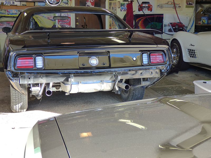

I put my foot down and did black, so now she wants as much silver/argent as possible. the tail panel will look different that this , I want to do argent on the flat panel, and also use the factory tail light grilles I had these painted to see what it looks like ,I like it, but the wife thinks it is to much darth vader

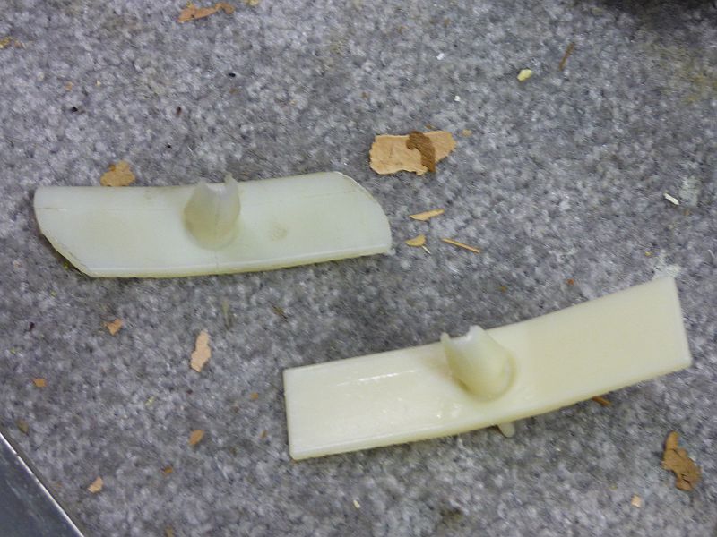

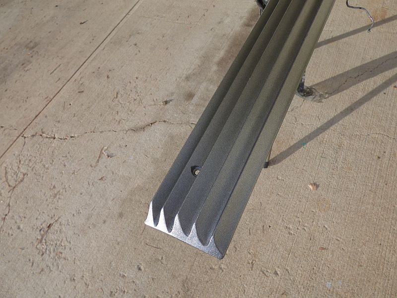

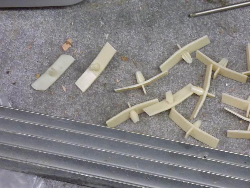

But I did find a part that is not available,the clips that hold the Gran Coupe rocker moldings, these parts are usually thrown away or rusted so bad they can not be reused ,and that is the case with mine. and then I see cars with holes in the rockers.
The rocker moldings are very rare to these cars they look like vents , I like em so I have been on a search for a way to mount them, and I did manage to find a forum that had a guy that found these trim fasteners, with a little modification they will work great .
http://www.hillcofasteners.com/prod/Uni ... 08581.aspx

The holes in the rockers for these mouldings are ideal for pumping waxoil in for rust protection. :thumbright:
Dave wrote:The holes in the rockers for these mouldings are ideal for pumping waxoil in for rust protection. :thumbright:
Yea I put por 15 while it was on the rotisserie,and spun it round and round, and then followed by 6 cans of this while there was a hole front and back before welding those holes up

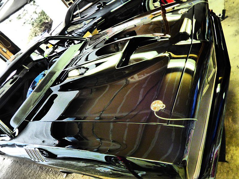

Ok ,next thing got the rockers painted,and got the hood back.

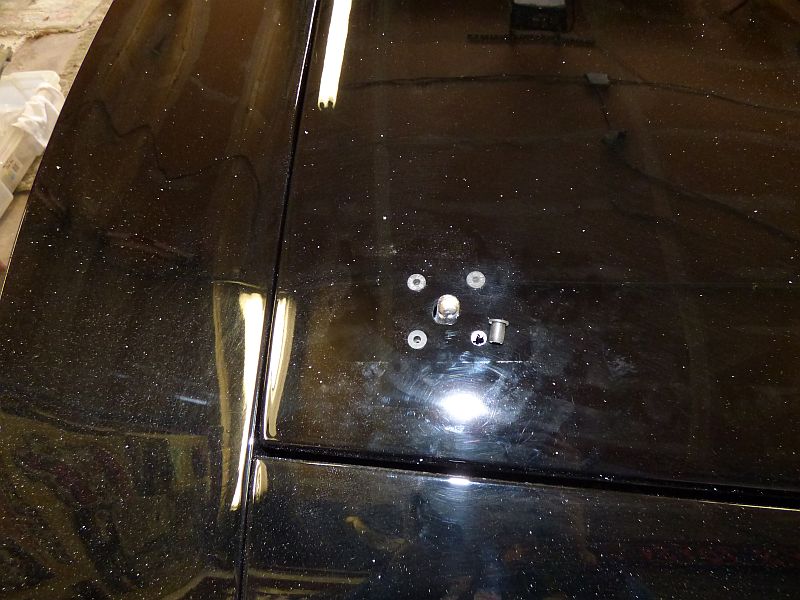

I used well nuts to fasten the hood pins,rather than ugly pop rivets.
Worked very well,and they will stay in place .
The hood took about 2 hours , we had to reset the whole front clip,got things lined up using the prior small holes drilled in the hinges,make for easy line up.
The hood came out alot better than I expected ,very happy about that,and when the wife saw it she was stunned. :shock:
