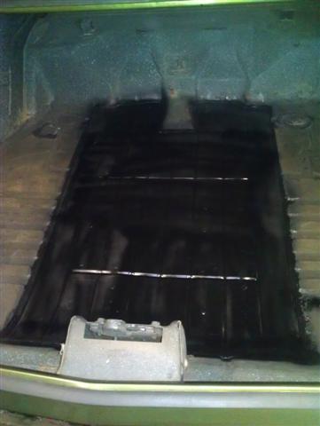

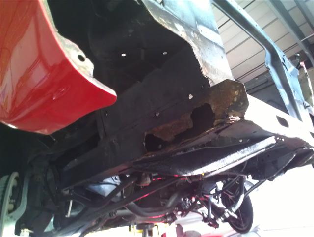

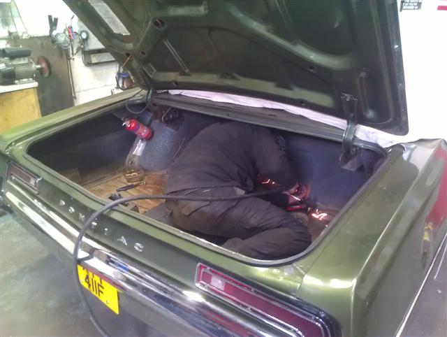

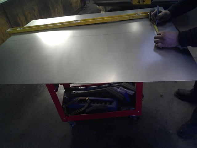

Middle section of boot floor, this was fun to make.
Almost there.
Almost there.
IMAG2560 (Small).jpg (48.86 KiB) Viewed 2141 times
Nearly there.
Nearly there.
IMAG2547 (Small).jpg (84.79 KiB) Viewed 2141 times
Rolled cut and almost ready for welding in.
IMAG2521 (Small).jpg (69.28 KiB) Viewed 2141 times
IMAG2515 (Small).jpg (46.79 KiB) Viewed 2141 times
I see Anton's sitting down on the job as usual ! :D
Great work as always :thumbright:

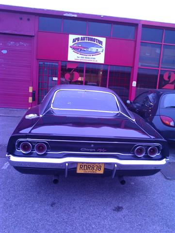

This Charger was back last week for some dash work and engine mountings, the owner wants to bring it back real soon, for a disc brake conversion and a diff re-build with some 3.73s, he also wants a few other things sorted.

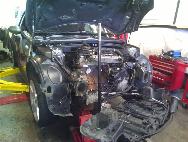

It's not just all about American cars, the front of this Mini had to come off just to put a smaller pulley on the supercharger

Loving that boot floor section, great work. :thumbright:

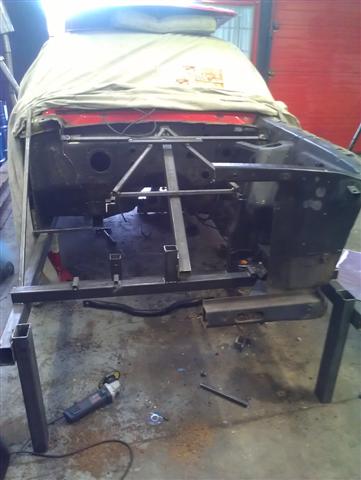

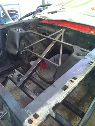

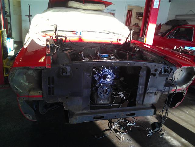

2 more from last week, Mustang is everything off from the bulkhead forward and all new metal welded back on, disc brake conversion and a power steering rack along with a big list of other stuff chassis rail the lot.

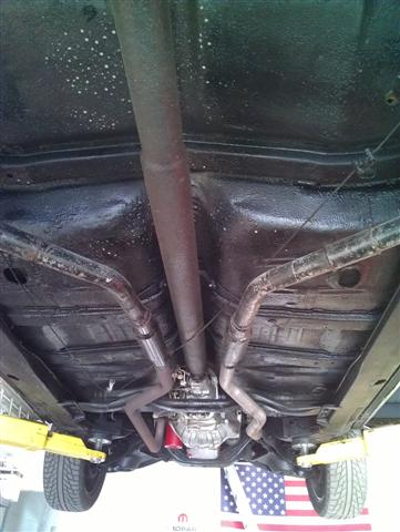

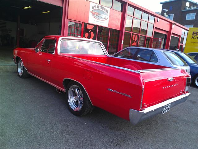

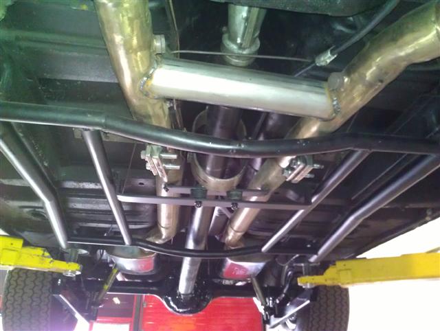

El Camino is just a full exhaust system for now.

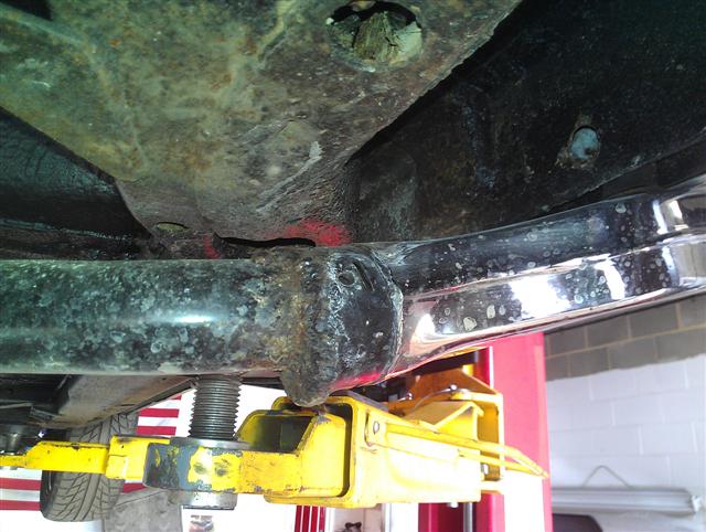

In this pic you can see the state of the old exhaust
Nice bit of welding.

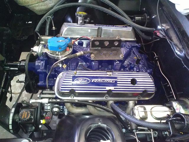

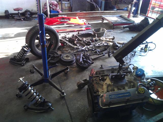

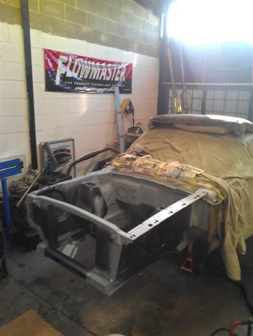

Bit of an update, lots have come and gone since I last posted, lets start with more of the 66 Mustang.

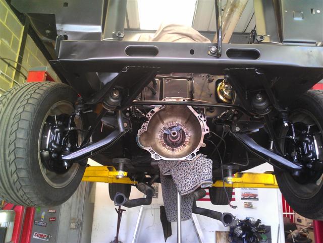

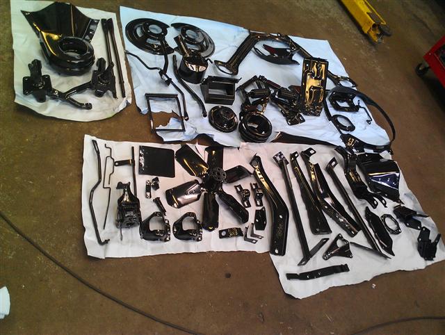

Posts: 7500

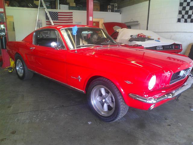

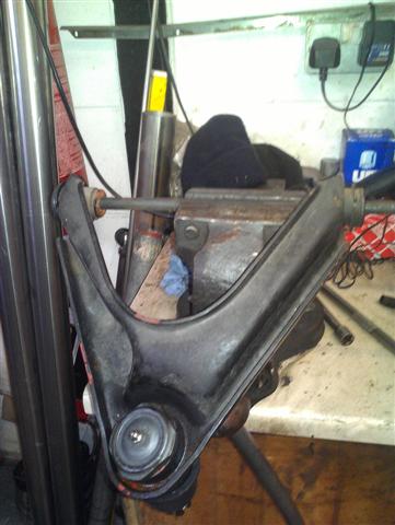

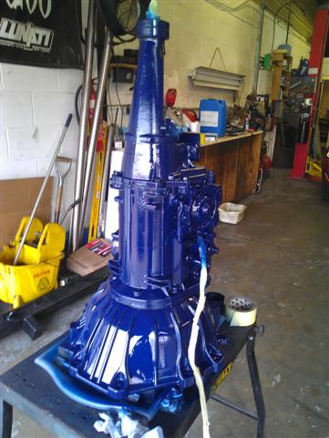

More of the Mustang. A lot of work went in to this one, Complete disc brake conversion, power steering box conversion, front end rebuild, everything was cleaned and painted before it went back in.

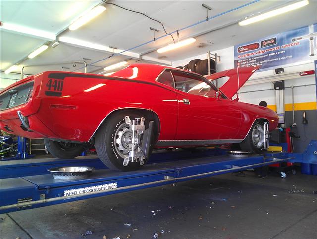

Posts: 7500
Steve's Cuda was pretty straight forward, fit pertronics in the distributor, get it running right, change the rad, whole front end poly bushed, changed all fluids, get the interior light to go off ( some silly sod had put the wrong bulb in ) and just make sure it drove nice.

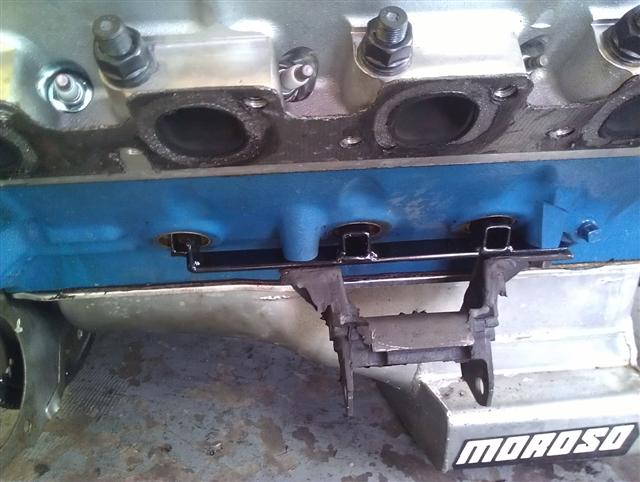

More from Richards Torino. Richard wanted it so that the core plugs would not blow out so Anton made up a bracket to prevent this from happening, the exhaust boxes were changed and the engine bay got a coat of paint, I'm sure there was more than this but I can't find the pics.
