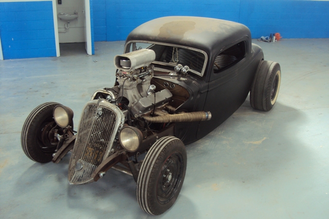

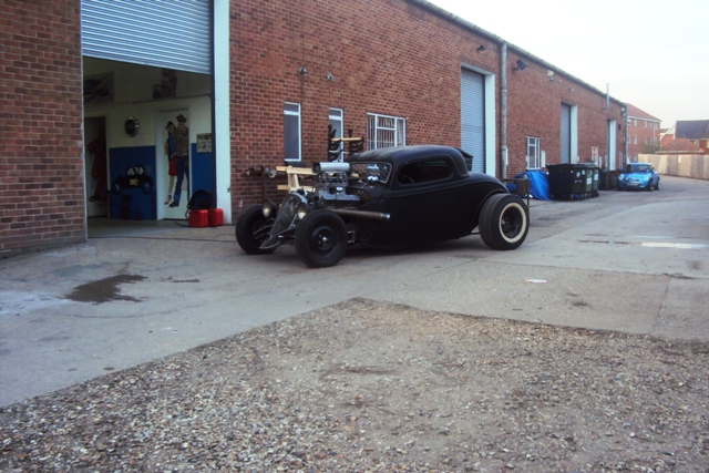

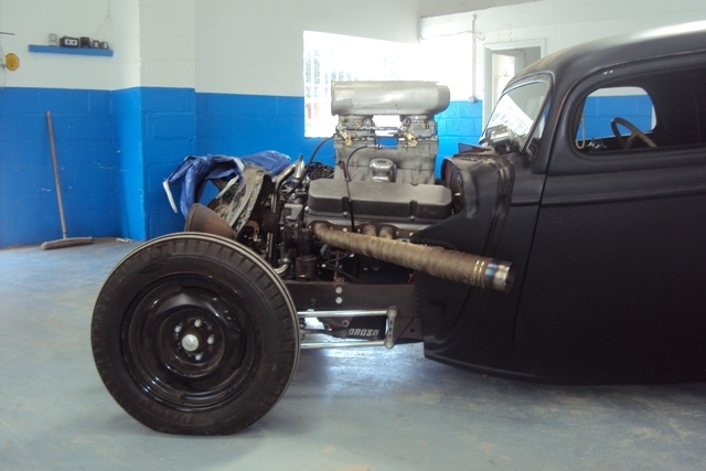

A quick update on the Coupe,
I took the car for a quick spin, and i can confirm its mental :D
I wasn't sure how it was going to go, but boy it doesn't hang about, i was shocked to be honest, mind you its probably half the weight of my Charger, i can't wait to open it right up on the track, but before that hopefully get the car on a dyno to check the carbs are jetted right and see what the bhp is 8-)
I did take a couple of pic's, so i'll post those.
Front and rear glass is now in, the car has been undersealed, the seats are bolted down, and it sounds like all hell has broken loose on anything other than tick over 8-)
I might need to look at the pipes again :)

The spec for mine is,
512ci
+30 pistons
10.5.1
Lunati cam (i'll have to dig out the spec on that)
Tunnel ram
Twin 650's
Stealth heads
Roller rockers
350 gears
And hopefully the car weigh's the best part of Bananarama! all 8-)

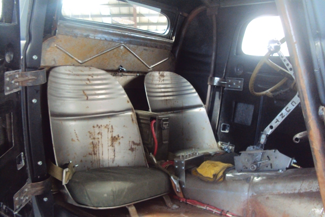

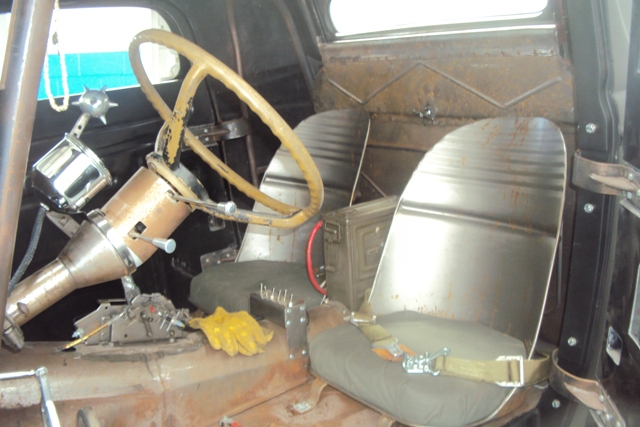

Hi Everybody
I'm back from Manchester, six hours on a cross county train is not funny, anyway i went over to do a couple of jobs before Wheels day, but i could of done with a little more time to be honest.
I did manage to get some better shots of the coupe, you'll notice an extra plate under the gas pedal cos it was flexing the floor which kind of made the pedal tilt over, they also lengthened the pivoting bracket on the firewall to take some of the pressure of the pedal as well, which seems to have worked, i couldn't get any shots under the car but next time it goes up on the ramp i'll sort those picture out then.
I did manage to get inside and outside video footage, a friend of my has one of those bullet camera's which i strapped to the cage above my head, hopefully both videos will be edited together, because of the roof chop the inside camera only picks up internal footage.
As soon is its done it'll be uploaded on to youtube and then onto here via a link, so only picture for now, see you all at Wheels Day :thumbright:
