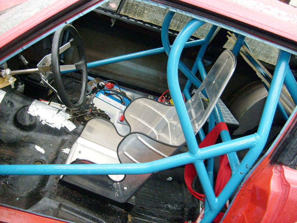

Got me a nice lightweight Kirkey seat in there now instead of that heavy old Jaz jobbie. 4 11 gears are in.

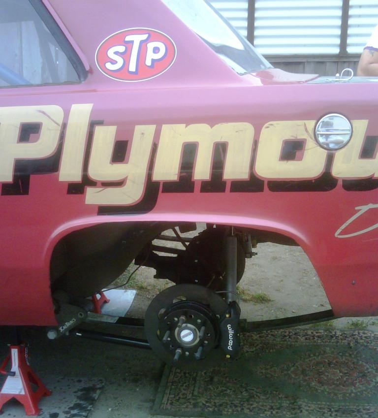

Lightweight alluminium spool and lightweight rear Wilwoods next week ( can`t use slant 6 drums as it is Ford rear end ) ready for NSRA Nostalgias.
Should then tip the scales at 2300 lbs

I was using old 28 spline half shafts when I ran the 10.554 and snapped one clean in half. Have upgraded to Strange 33 spline and Strange spool, but only got them from Hauser on Wednesday ... still waiting on shaft seals which won`t come til next week.
Then got to fit it all and fit the Wilwood rear discs

Strange spool / Strange 33 spline half shafts / Wilwood rear discs all fitted
Couple of tidy up jobs, then onto the scales
