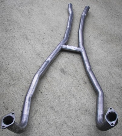

Also spent a bit of time under the car on Sunday, getting the exhaust sorted.
The plan was to see what we need to do, or to get done, to get the various bits we have into a useable system.
The front section (from the cast manifolds to the mufflers) that was on the car before all this started, was getting pretty rusty, and was originally made by Pipe Craft in Essex to fit to the 70-71 cast manifolds that we had on the car.
Looking at that part of the system now, I find it hard to believe a professional outfit whose sole purpose in life is/was to make exhaust systems, could have made such a poor job of the bends & welds!
So when we saw an Accurate front section to suit the manifolds we now have (68-69) on ebay (thanks to Miles on here for the heads up
), we jumped at it and got it as the only bidder.
Offered it up and it fits fine around the starter, torsion bars & prob but was a bit close to the kickdown linkage, so we've modified that to give about 1/4" clearance (see pic).
Surprisingly, the mufflers we had on the car fit fine with the new front section and the 'PipeCraft' over axle pipes that were on there before. They're not pretty either but will do for now. Certainly good enough to get it to the MOT. If we find it's blowing once we get it started and needs any major reconstruction, we've got Barry 'the bender' Grimes on stand-by to sort it out for us.
Gonna give the mufflers and the prop another lick of paint before we fix it all on for good, so I'll get some more pics up once it's finished.

- bit close...
- DSCF8251a.JPG (143.25 KiB) Viewed 1471 times
- 'library pictures' !
- ACCURATE.jpg (77.75 KiB) Viewed 1471 times

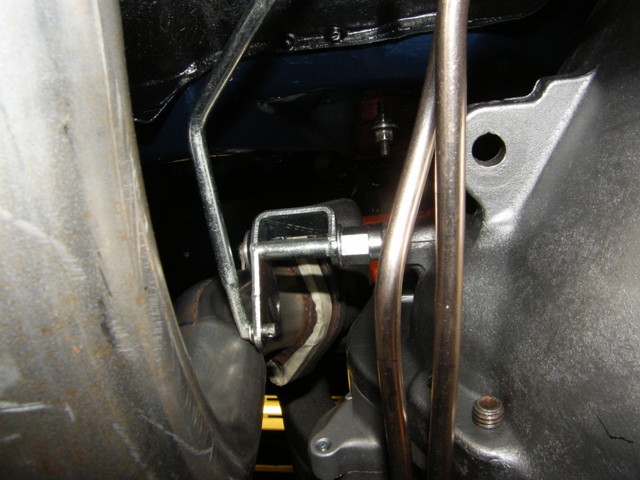

Speed Flow trans cooler with pukka rubber hoses & home-made hard lines
Transition from hard lines to rubber hoses should be hidded when battery tray is refitted to stock location (been in trunk since '87
