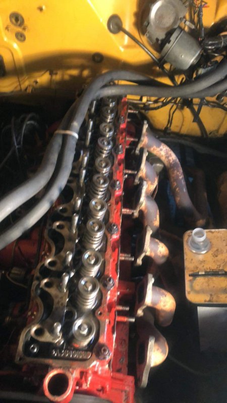

Anyway
filled engine to the brim
no leaks overnight so presume not a core plug out
all looked great no obvious problems, radiator ok, Cap ok, top and bottom pipes ok, radiator drain tap ok engine turned over by hand OK......
bizzare
But i haven't taken a day of work to spend it all looking at an engine that looks ok.
off came the carbs exhaust head
hours of cleaning. 2 litres of brake cleaner.... is an old holey vest a lint free cloth? i dunno, but when it stayed white, i'd cleaned enough getting to that point takes a very long time.
3 foot straight edge applied, granted its from wickes so probably not as straight as necessary.. proper one is 100 quid. can't get my 0.002 feeler under the ruler across any of the bridges between cylinders. preumeing not warped
can't see any cracks
took out some shares in copperkote and a "used once" MLS gasket from the spares pile
and on it went again. ARP snot on stud threads, nuts and washers, and torqued in 3 stages
just got to put back induction and exhaust dump oil and coolant a refill and will be good to go
yes there is a chance this won't work
Got a monotorque gasket coming for a potential re run in the autumn season....but hey the MLS cost me a fortune.
there are times when i'm not that fond of this car
what an adventure

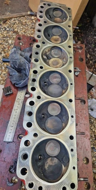

what an adventure

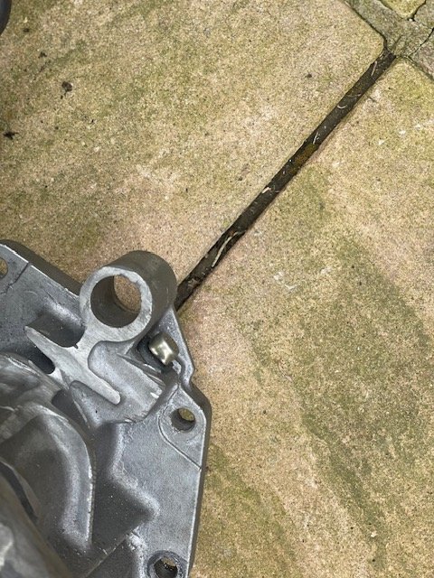

- back to where we started or is that the same photo i dunno
- IMG_0565.JPG (79.92 KiB) Viewed 25193 times
- clean? clean... not the chambers the gasket face. Not a hemi, but a Semi
- IMG_0564.JPG (97.12 KiB) Viewed 25193 times
- That'll do.... looks worse than it is
- IMG_0563.JPG (80.31 KiB) Viewed 25193 times
- after the first going over razor and steel ruler to remove stuck gasket face
- IMG_0562.JPG (88.6 KiB) Viewed 25193 times
- Start
- IMG_0561.JPG (48.79 KiB) Viewed 25193 times
- Not Happy but keeping myself amused, read the whole internet
- IMG_0555.jpg (39.04 KiB) Viewed 25193 times

BUT on the + side
has resulted in a motor that goes just a little bit better... i must admit i was smiling on my return from another quick blast yesterday managed to scare myself in the wet ...
I guess I live and learn...
running better than before. so pleased about that
no idea why, all i did was take it apart and put it back... quick clean and re gap of the plugs that's all
why this has made a seat of the pants difference i wish i knew why.
took it out for a 45 minute run....no issues apart from the horn and wipers have packed up ......
Got back popped the hood and found both heater tubes slightly ballooned at the point where they enter the heater with a dewy like covering much like an advert for fresh fruit....Oh no.
man handling the pipes produced a bigger exit of coolant
placing them back and it stopped some what.
AAAAAAAAARRRRRRRRRRRGGH ugh etc etc well.... no..... i can't print what was actually uttered.
when cold no indication of an issue hard rubber pipes with some flexibility but set in position.
These pipes have a longitudinal ribbing as standard so no visible perishing. No staining nothing
When warm seem fine idle it for 1/2 and hour to get it warm, stat open, no problem, pipes are a bit more bendy, but no indication of leaking
When exceedingly hot seem to turn to sponge and allow coolant to well out from the center of each rib.
when bent from natural resting place lots of liquid....
now this is probably the cause of the issue. Or has it been caused by the undoubted overheating and steam production when i got stuck in the first place... either way i'm kicking myself
i can imagine if the pressure and temperature was higher a considerable rain storm would occur under the hood
and given that on 2 occasions previously i have dissapeared coolant with no indication as to where it went on very hot days, in very slow traffic....
selectively leaky spongy pipes might have been the problem all along.
i can't understand why a leaking pipe doesn't splatter the screen, yet a leaking radiator cap does....
when you bend a pipe to check its ok you bend it. you can't bend it the the other way to see if the grooved pattern along its length is hiding anything.
given that these pipes were made for approx 4 years in the 1970s, by one Aussie manufacturer i should have known, They could be 50 years+ in age or be crap repros but either way. should have thought.
new pipes 3 meters of 5/8 purchased... job done
and i retreated back into the house to curse the fact that i all i did was run it up to warm, before i started on this gasket replacement route
Far too hasty. wrong assumption, regardless of previous suspicions, leads to two days work that were not necessary
a good example of starting the work not liking the car, with your head in the wrong place. This leads to mistakes. act in haste repent in leisure
BUT on the + side

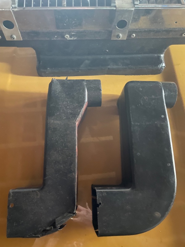

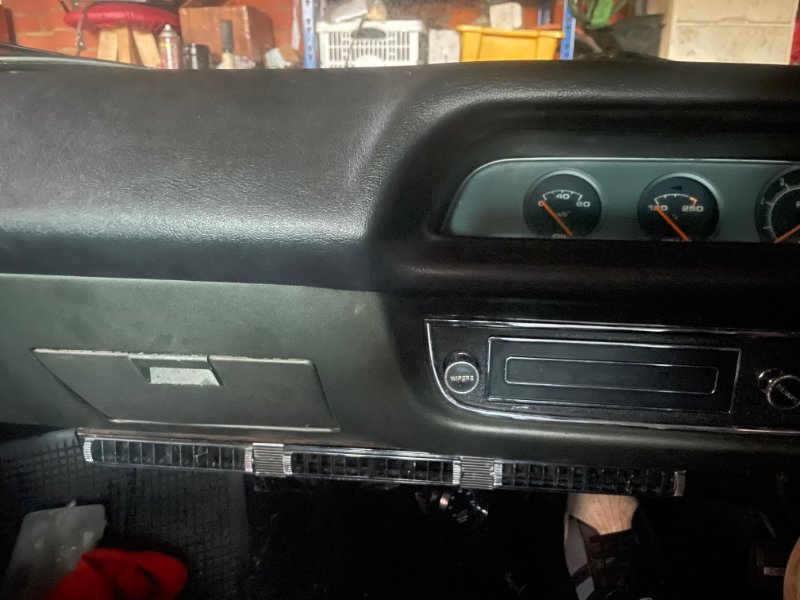

Trying to fix up the de mist and aircon unit vents
Plastic manifold on the car is the wrong one. It's too fat and won't allow fitment of the diffuser
The thin one necessary for the job is in a right old state
They are polypropylene. I.e. pretty awkward to glue
So I chopped up the fat good one, and plastic welded a chunk of it to the thin one
Ugly. Very ugly. But robust
ill sand down the mess later
- IMG_0648.jpeg (116.37 KiB) Viewed 19377 times
- IMG_0657.jpeg (160.33 KiB) Viewed 19377 times
- IMG_0656.jpeg (164.92 KiB) Viewed 19377 times
Re: Dave999's Aussie Charger
you could now wrap it with self amalgamating tape for that proper 'belt and braces' finish, lol.
neil.
neil.
a long time ago (2003) in a galaxy far far away
i drove west from Sydney down the parramatta road and got lost in suburbia land...
i met a man who sold me an aircon/heater unit and the heavy weight metal and plastic vent/diffuser for a H51 RHD car
he also sold me a screen and some other gubbins a load of bits of dash lighting etc
i did some work in my underground sydney garage, which involved turning the aircon box into a box of spares which i have never used.....
the aim was always to get the push button unit and the under dash stuff working even if i didn't have the under hood stuff to go with it
at least i'd have demist and an ability to switch off the heater..
well finally finished that job 20 year later
the repaired plastic manifold (above) went on
i could then fit up the diffuser under the dash. its heavy...!
remount my lambda gauge on the bottom of it
next i fitted some small plastic vacuum T pieces that i got from china into the red and white vacuum pipes, replacing what was crumbling, and re plumbed in the tubes through to the engine bay
whacked the black one onto a vacuum port on a carb
and started it
mouthful of 20 year old leaves later all good
all vacuum activators are lazy
one might not work
but i can now have hot feet hot face or hot screen....
success

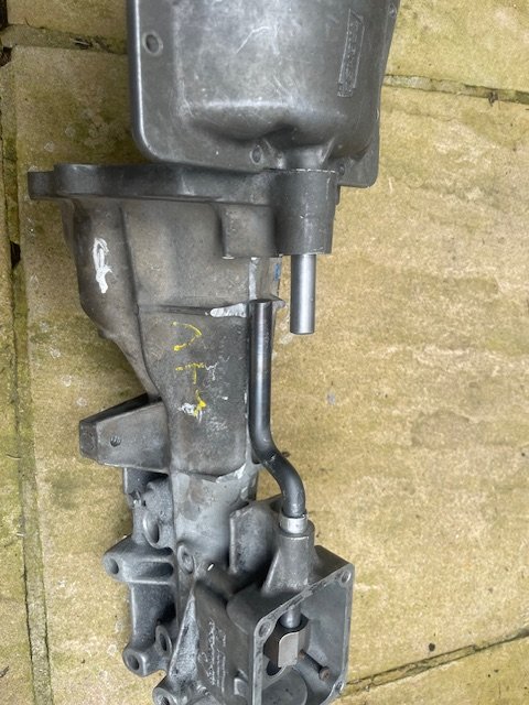

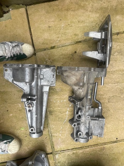

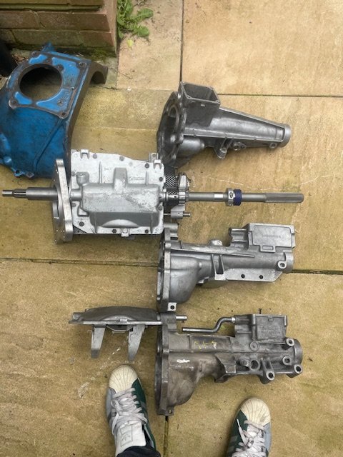

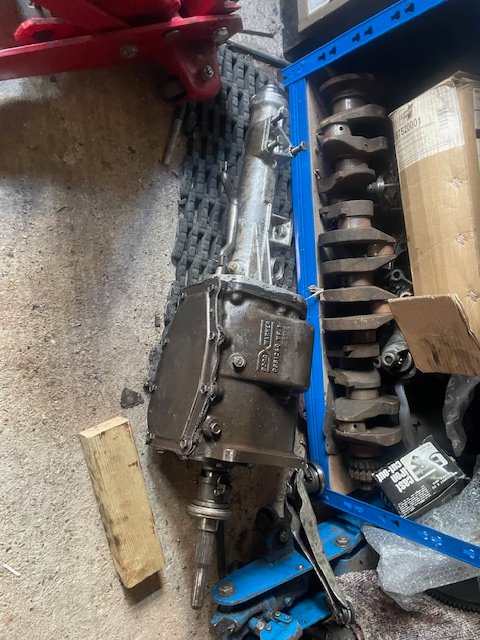

here are some pictures of the stuff i nearly did but then didn't
i.e a lot of messing about
illustrated below

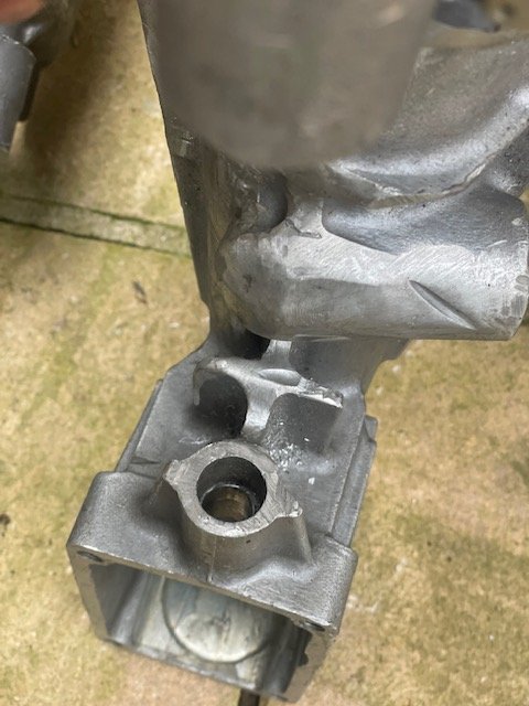

An australian t5 tail housing, modified by removing the shift rail tunnel and putting nice bushes and seals in the cut off ends left behind, and a nice bent shift rail to clear the cross member.
BUT the speedo housing/cable/drive and cross member wanted to share the same space when installed
SO
I modified a chevy camaro t5 tail housing in the same way. they have the speedo drive in a different place.
used the same bushes and seals and a nice bent shift rail
Much the same housing as the aussie one apart from a chevy shifter gate/detent plate and a stupid offset by 25 degrees rear mount.
All looking good, got the thing more or less ready to go.....NICE.
But the tail housing tunnel is so narrow and it has a flat roof from halfway down. it can't contain anything but an original chevy gear, mounted on an original chevy output shaft with a tiny spring clip. I don't have a Chevy output shaft on a Ford T5. Hence the aftermarket gear and adapter i have won't fit the tunnel this far back.... aaaaaaargh the replacement gears only fit in if they are further up the output shaft like on a ford box.
SO
i got Chevy S10 housing same shifter as the camaro, well at the base a least. but this time right up front.
put in box and then you can cut a hole in the tunnel in front of cross member.... all will be well. Honestly it will.... The speedo gear adapter fits, along with a chevy gear, and doesn't lock the output solid once the tail shaft housing is bolted down.
Yay!
put it in

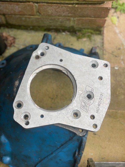

the fat 19mm bellhousing adapter i purchased to get the australian tail housing to line up with the rear mount is too thick.
i need the box forward 8-10 MM hence need a steel bellhousing adapter of 6-8 mm
it pushes the s10 shifter box back into the double skinned section just in front of the cross member hoop....
too much money spent on stupid plans this year
fergodsake
so i gave up again
and
because i'd pulled out the close ratio 4 speed back in february
I decided on a change
I refreshed the wide ratio 4 speed
cleaned it all up, inside and out, layshaft pushed back lowered secondary gears pulled out input shaft, bearing off and cleaned, inside input shaft rollers checked greased up and back
checked all the gears main and cluster
checked clearance on the syncros
all good.
took shifter housing to Cramers in watford to be re-bushed 3 weeks ago... heard nothing...as per usual..... so swapped the one off the close ratio box across, which i didn't want to do they kind of wear into the job they do ally housing with oilite bushes mix n match is not good.
aligned it on the wide ratio box. new plastic button and saddle on the gearstick (like a type e ford rocket box shifter) and shoved the wide ratio box in
Back on the road 9 steps forward 9.5 back...
working on a plan
illustrated below

- The Cut off Shift rail housing on the Aussie Tail front
- IMG_0733.jpg (114.17 KiB) Viewed 8167 times
- Cut off housing Aussie tail rear with the speedo drive hump in front. Right in the wrong place
- IMG_0734.jpg (60.67 KiB) Viewed 8167 times
- Fat adapter has Ford dagenham pattern for bell and Ford T5 for box. i bodged it onto a 3 speed bellhousing for an Aussie 3 speed box
- IMG_0735.jpg (82.06 KiB) Viewed 8167 times
- 3 speed bell and other side of adapter
- IMG_0736.jpg (75.99 KiB) Viewed 8167 times
- Aussie housing left T5 middle S10 housing right
- IMG_0732.jpg (93.72 KiB) Viewed 8167 times
- Aussie housing illustrating frustrating speedo drive bulge
- IMG_0731.jpg (93.57 KiB) Viewed 8167 times
- Chevy Camaro housing with new shift rail set up note the offset rear mount and better position for speedo drive
- IMG_0730.jpg (90.68 KiB) Viewed 8167 times
- Chevy camaro housing close up. need to make new bush
- IMG_0741.jpg (87.74 KiB) Viewed 8167 times
- Compare the chevy camaro with the chevy s10 stick position. note the 21 degree offset to the rear mount on the camaro...what a Pain in the as that is
- IMG_0742.jpg (96.61 KiB) Viewed 8167 times
- Borg warner single rail australian 4 speed close ratio with shifter cup removed. This is A small, Steel cased Toploader. good for 285-350 Ft/lb depending on ratios and it fits an Early A Body auto trans, floor/tunnel with no modification other than a hole for the stick... why am i making my life so hard :)
- IMG_0744.jpg (158.15 KiB) Viewed 8167 times
- spruced up wide ratio borgwarner single rail 4 speed with shifter cup added note kinked linkage which was inspiration for the T5 plan in the first place
- IMG_0745.jpg (110.35 KiB) Viewed 8167 times

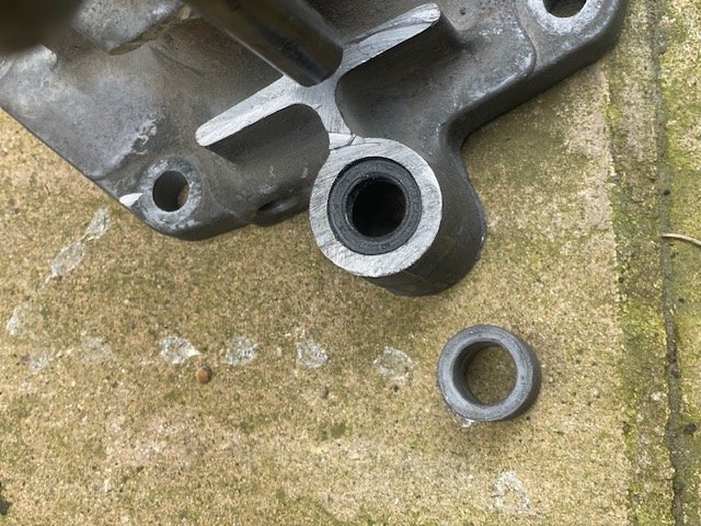

- Aussie housing with the nylon bush i made and the seal installed. the scroll section next to the main tunnel is flat. so this is a world class housing
- IMG_0740.jpg (67.29 KiB) Viewed 8167 times
- seal pressed in
- IMG_0739.jpg (101.64 KiB) Viewed 8167 times
- Map gas torch a jack handle and a length of 12mm steel rod and i made a new shift linkage. next move was to buy something to join it up
- IMG_0738.jpg (86.73 KiB) Viewed 8167 times
- adapter in place
- IMG_0737.jpg (54.45 KiB) Viewed 8167 times
