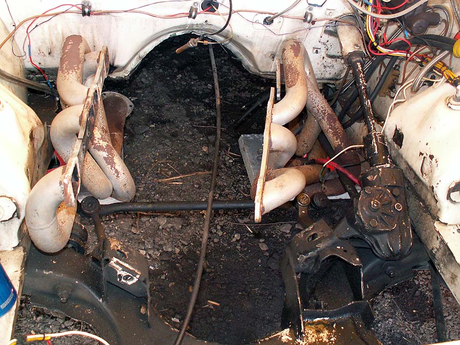

Update

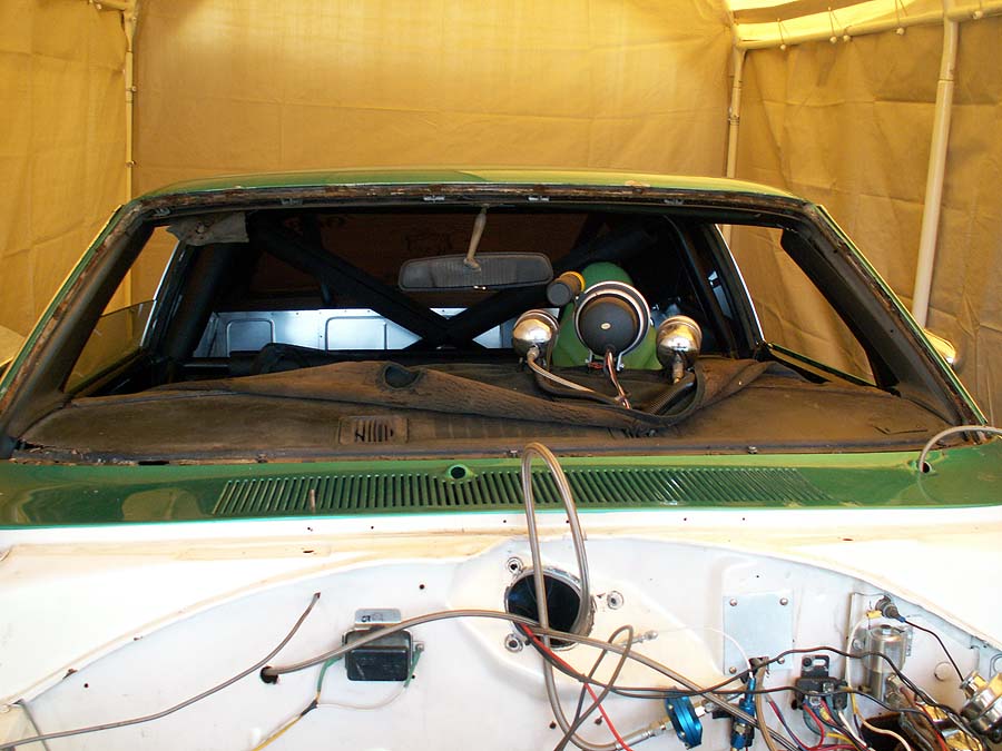

OK here are some sorry pics of the old girl.
She looks a bit different after today though stripped out the everything you see so there are a few bits up for grabs
Steering col, steering box, 440 headers rear view mirror dash torque arms, front drum brakes, front shocks.
Also some rather nice aluminum replacement inner wings.
Cas cut out the floor and the bottom of the right leg ready for repair and the 12 point gage and rear engine supports more pics to follow.

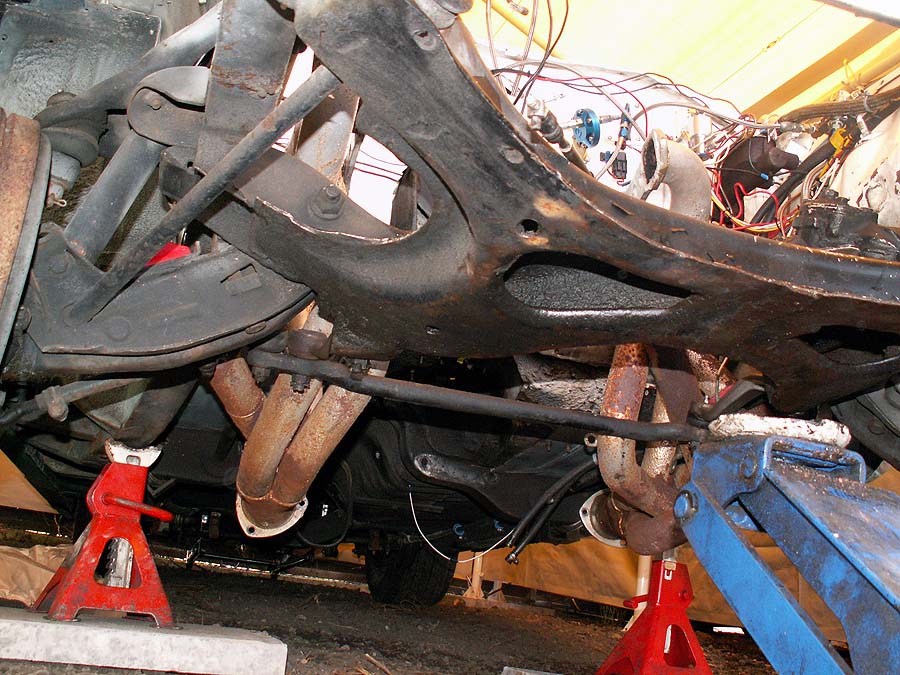

Basically I have shed the old K frame and front hubs. then set about making my own A frame set up.
After a bit of searching I found that the Jag XJ6 had seperate ball joint on the top and a spindle mounted ball joint on the bottom so got a whole front clip for £60, removed the top and bottom wishbones spindles and discs and scrapped the rest.
AS I wanted to keep the same geometry I made new tubular A frames, the same length as the original top and bottom arms.
The top is a direct replacement for the old top wishbone but as you can see it has the Jag top ball joint bolted in place.
The lower A frame has the cut off end of the old JAG bottom A Frame arm also bolted in, it also has the original shock mount which will be used for the coil overs.

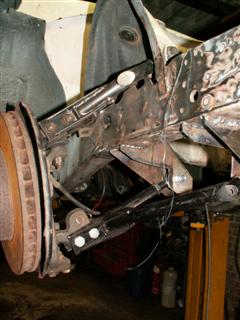

One of the advantages of using the existing tower is that the camber adjustment can still be used.
I then had some bottom brakets made to support the lower A frame which places the centers in the same position as they were in the K frame the joining angle you see is is just to keep the brackets aligned while i fit them the the chassis rails.
454605 034 (WinCE).jpg (11.18 KiB) Viewed 2578 times
More
here you can see the brakets being measured and fitted to the chassis rails.
We measured from the rear axle to ensure the wheel distance is the same both sides and we got it to within 1 mm.
As you can see the old tourque arm holes came in handy.
OH and I loose the torque arms as well

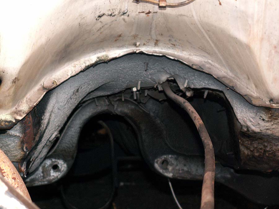

Here is a shot of the lower A frame brackets finished with the jig angle removed from inside the engine bay.

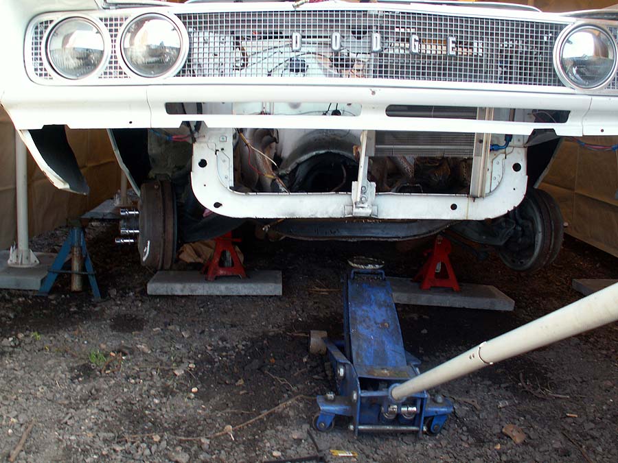

The last picture is the old girl back on 4 wheels.
OH lastley the pcd of the JAg front hubs is the same ande the old wheel nuts fit as well result :thumbright:

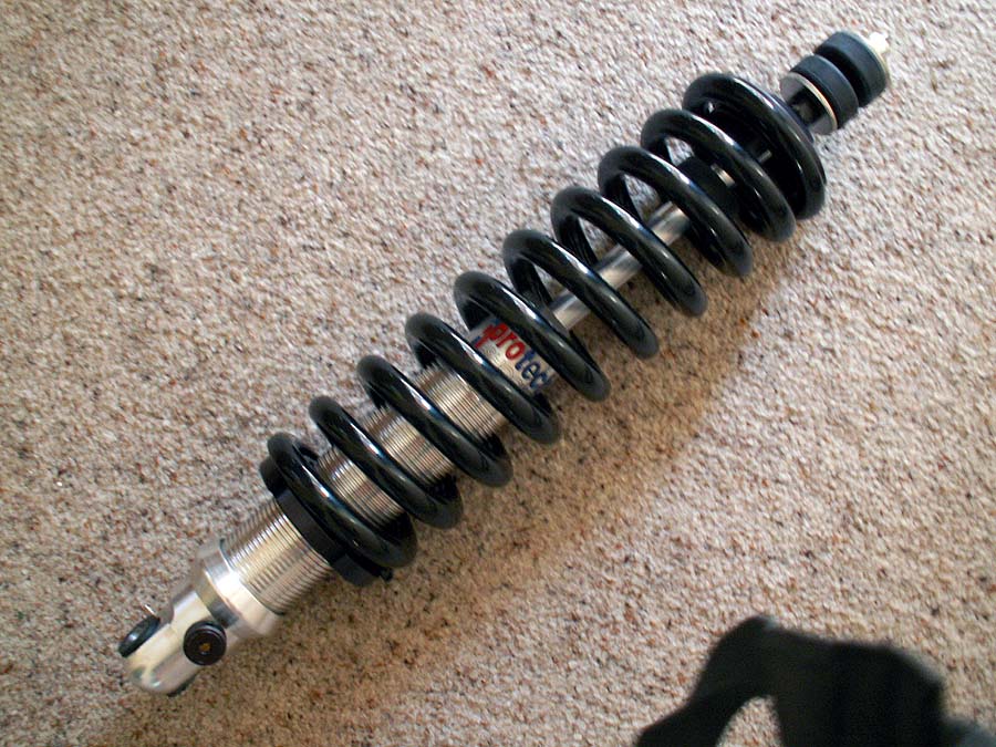

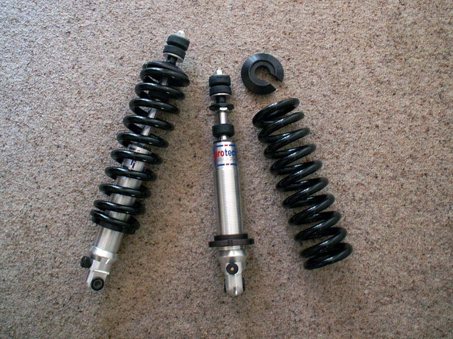

Shocking
Shocks turned up today. :thumbright:
Shocks 002002.jpg (163.55 KiB) Viewed 2434 times
Shocks 001001.jpg (167.84 KiB) Viewed 2434 times
