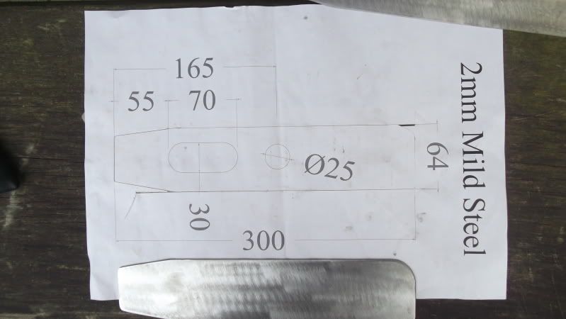

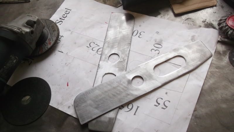

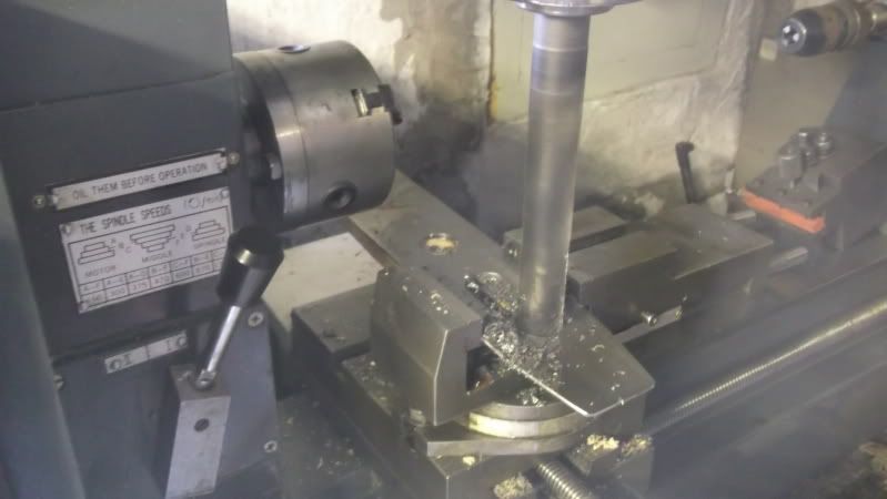

A big big thanks you to Anton for is advice and the template for my bottom arms saved me alot of time.

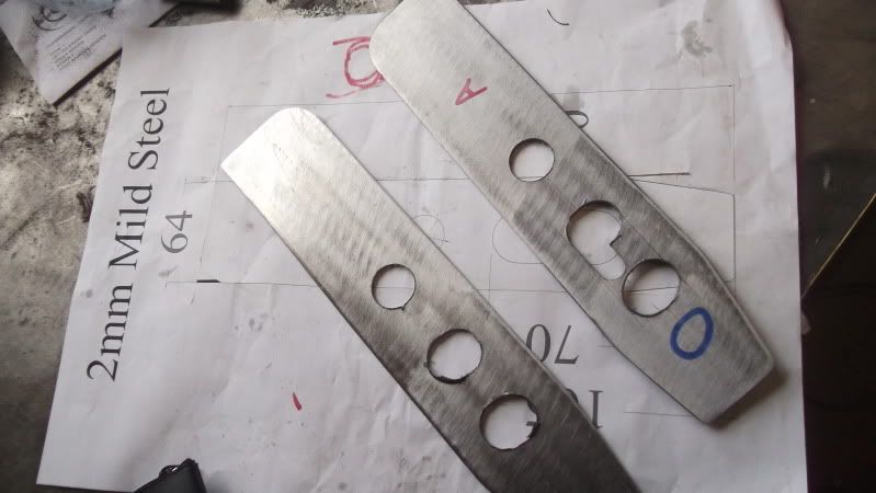

I copyed Antons template made them out of 2mm steel
Played with a milling machine then gave up (too slow) and went to angle grinder and file

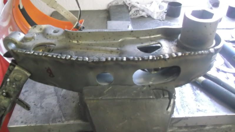

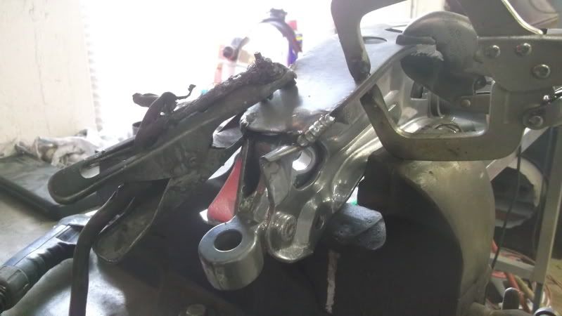

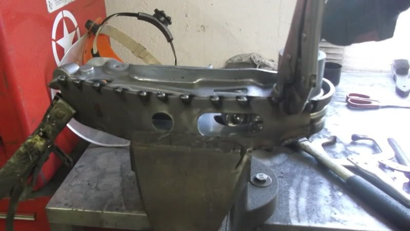

Welded them on. Lots of clamps
also welded the stud things and bump stop plates
When finished i grinned all welds flat for that factory look.
Then sand blasted again and powder coat

Will ( Kev said) it looks like you had a reamer in there not a milling head are you sure you got the right tool in the job ? and nice to see it set up mate keep at it , and no I have not touched the car yet its been peeing down with rain !!!!!!
John Rutledge
JohnR wrote:Will ( Kev said) it looks like you had a reamer in there not a milling head are you sure you got the right tool in the job ? and nice to see it set up mate keep at it , and no I have not touched the car yet its been peeing down with rain !!!!!!
you 2 need to both get your arses out here i ant got a clue.
reamer sounds a bit kinky to me no thanks
The picture was of a normal drill bit just drilling some big holes before i got the file out.
The P of the poo was made with a proper milling head i first drilled a hole with it then using the side surface of the tool. Drove the steel into it.
It was a brand new tool and only 2 mm plate i through it would have chewed trough that. but was really slow. Yes the thing was spinning the correct way.and i used proper cutting oil. Think i need to read up some more about lathes and milling machines.

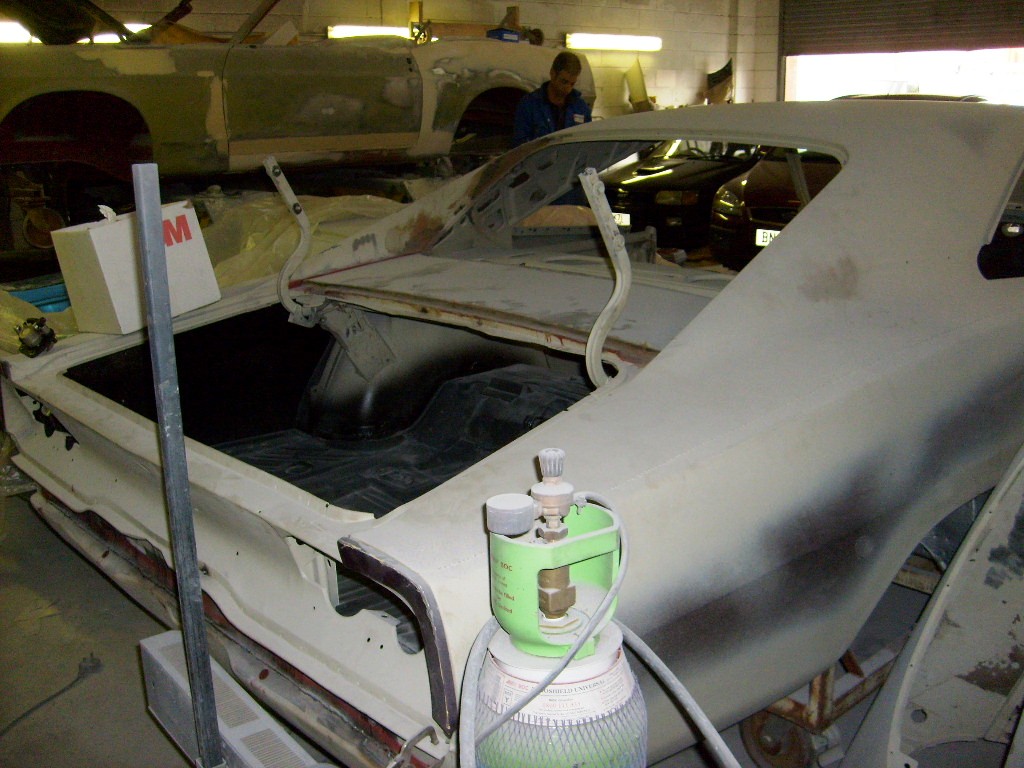

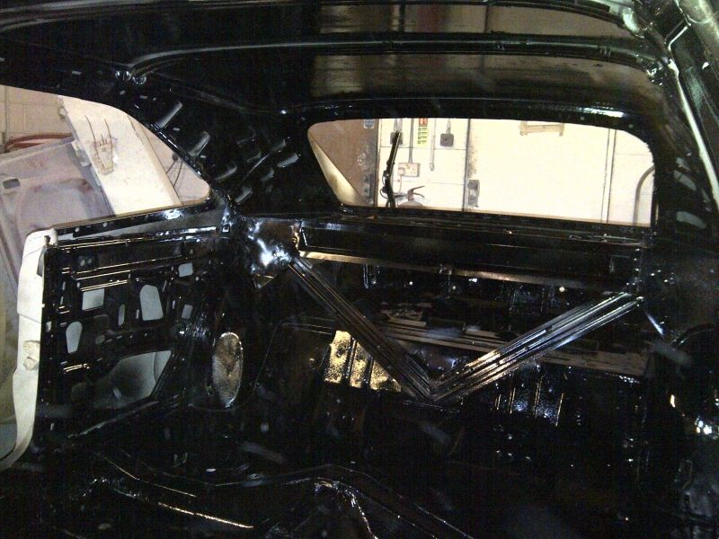

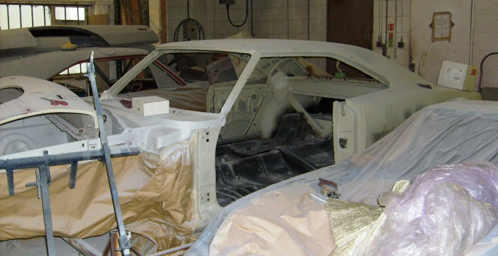

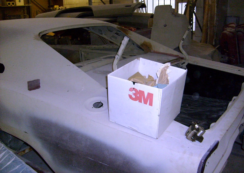

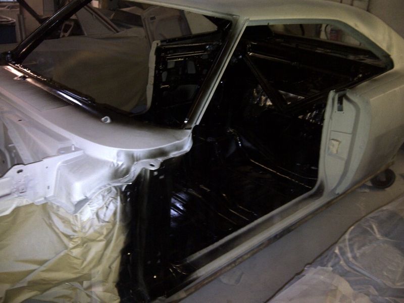

Charger is coming alomg Wil .... bit cluttered but you get the idea

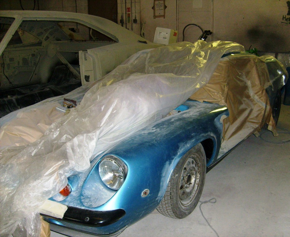

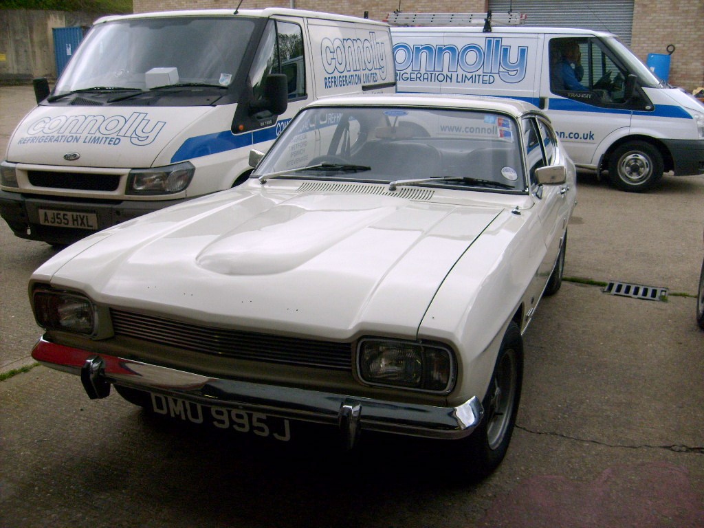

Here`s a Capri that he`s just finished, so you`re in good hands

Lookin' good. Love the capri too! :thumbright:

Jon Connolly wrote:Charger is coming alomg Wil .... bit cluttered but you get the idea
Jon thank you so much for popping in.
Its horible being so fare away.
Engine bay in primmer and black inside :thumbright:
I see the new rear disk brake kit also there :thumbright: :thumbright: :thumbright:
Looking so forward to it being back with axles and wheels on
Nice work on those plates Will.

THAT BONNET ALIGNMENT IS LOUSY ON THE CAPRI, :roll:
Posts: 9564
or the wings
