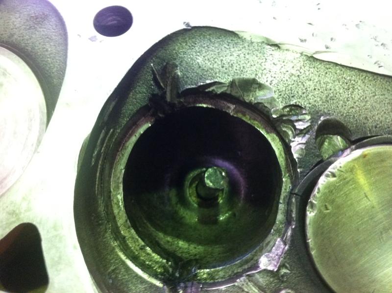

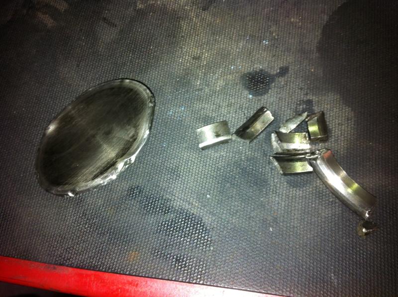

RV3's demise turned out to be exhaust valves too tight in the guides and sticking.
That ended a bit more seriously tho :shock:
Rogue Trooper
Posts: 1792
Post by Rogue Trooper »
:roll: :banghead: :drunken:
1934 Coupe
1954 F100
1972 Norton Commando Fastback
Your Mum Says Hi.
Mopar a God amongst insects.
Oh s***! :cry:
Gutted for you.
So the seat dropped out- never seen that before, unless it was knocked out by the bust valve?
latil
Posts: 12076
Post by latil »
Oh FFS :( Tight valves then :shock:
