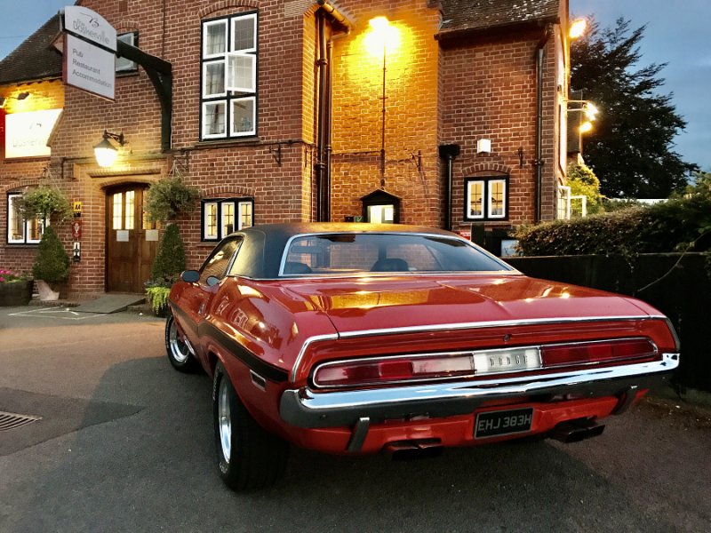

Picked my car up today. Turns out there was a vacuum leak from the carb. One of the ports should have been blocked off under the carb. It’s was causing pinking, over heating and fuel vapour escaping. Drives like a different car now, loads of power and goes like stink.
Very happy :).
