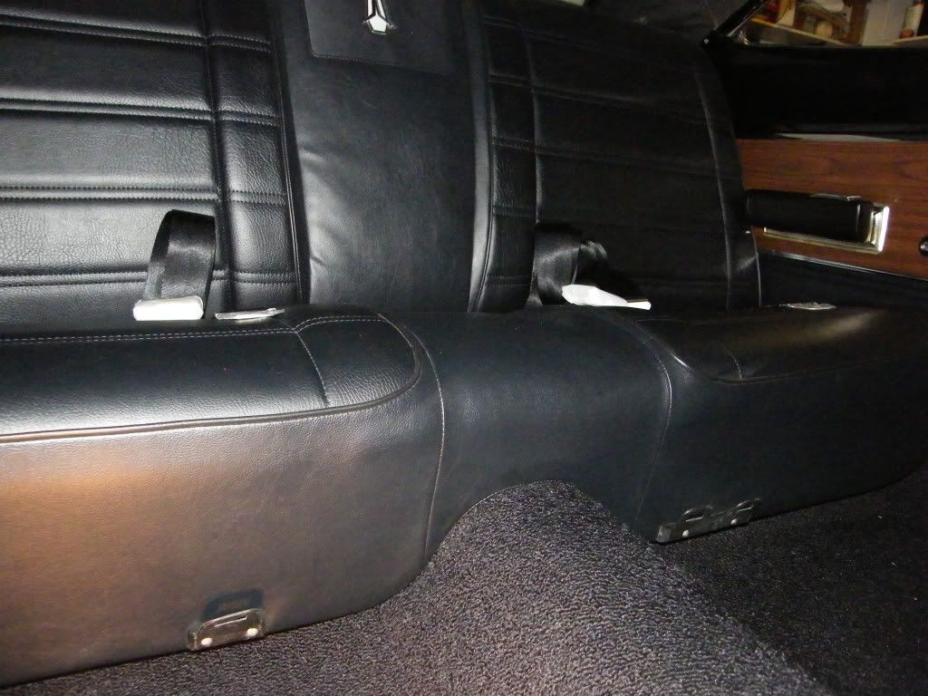

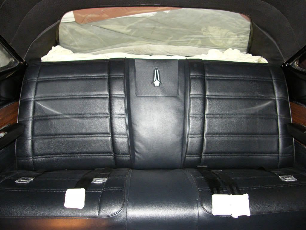

Bit more progress but not many pics to show for it
Next weekend I'll hopefully get some pics of the finished rear 'door' panels which Stu has fitted. Arm rests still to go on but they're waiting till the rear seat base is in.
Top/back section of rear seat is in ok but we struggled today to get both sides of the base in - dunno what's stopping it go fully home into both of its 'brackets' in the floor
Dont think it's the extra carpet we've put under there cos that's already been trimmed back to clear, but it's certainly tighter than it should be

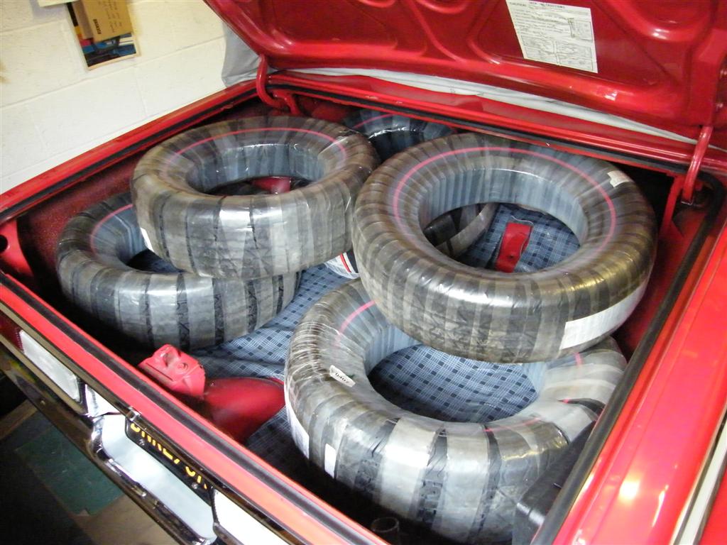

One successful job that was accomplished today was to collect the tyres we ordered from Summit, from Ron @ STS Imports.
215/70x15 & 235/70x15 BFGs. Not exactly the widest tyres that will fit under a b-bod, which i know we'll get slated for, from some areas
but they are the widest you can get in redlines. Or at least proper redlines that are legal to import, with proper red lines that arent just stuck onto plain tyres (eg Diamondback)
Not quite ready to fit them yet so for now they'll stay out the way in the Polara's trunk.
Yes that's 5 tyres in there. Try that in your cuda/challenger

Must have been that extra carpet we tried to use as insulation under the seat base that was stopping it going in, cos once we'd removed the jammed-in seat base (one side was stuck, the other wouldnt go in at all
), then took the extra carpet out, we got the seat base in relatively easy

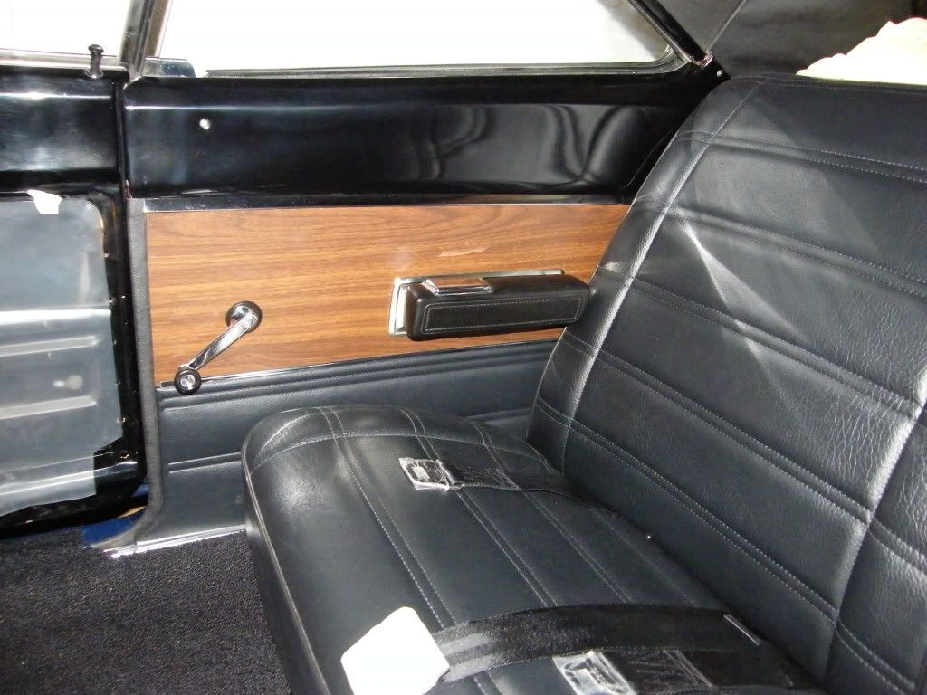

So with the arm rest fitted, that's the rear of the interior finished.
Seat fits nice & snug over the tunnel now
Although the front door panels could wait till after the car's up & running, where it's positioned in the garage (ie close to the wall), it would be tricky to fit the passenger side door panel once the front seat is in, so thought we may as well crack on & get the front panels fitted next.

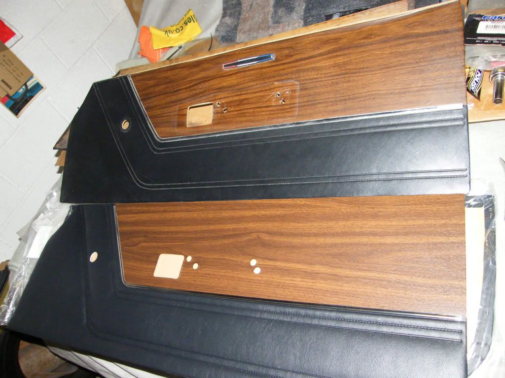

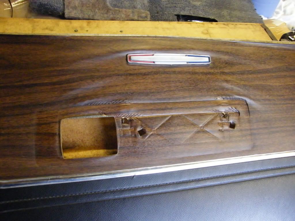

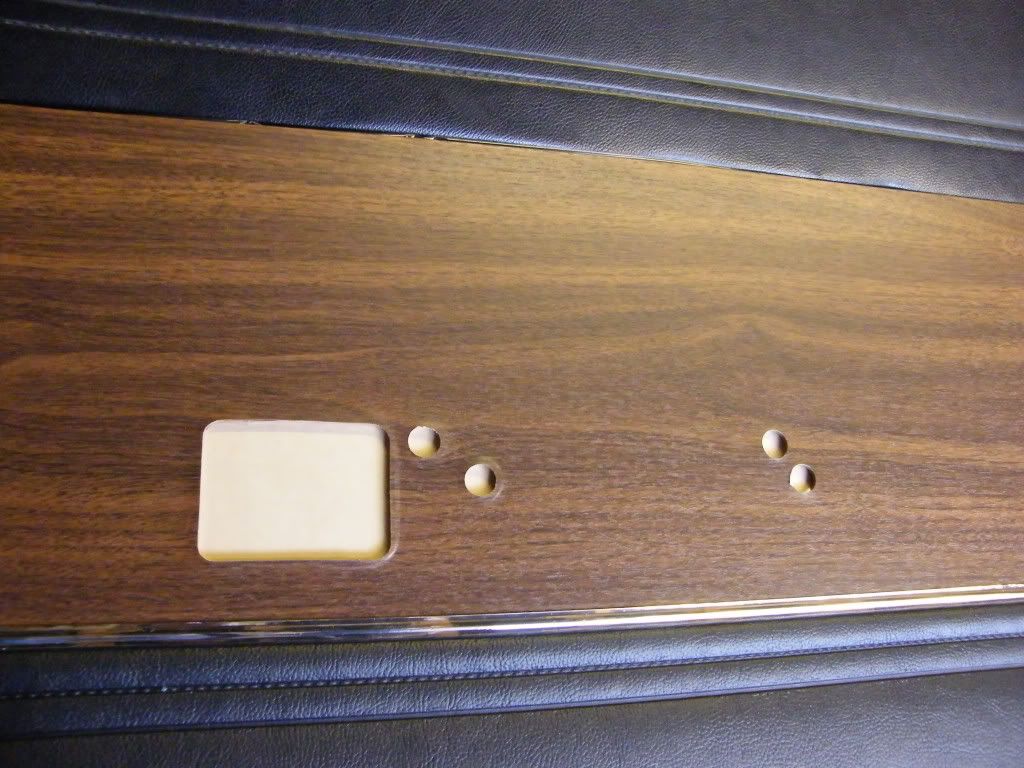

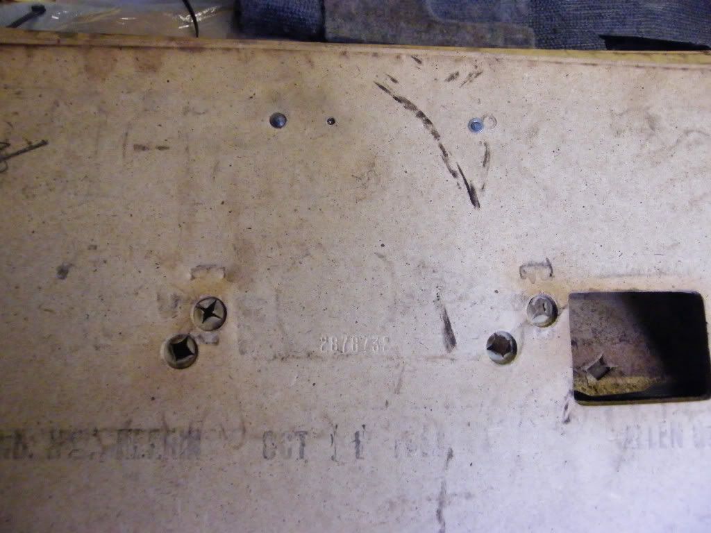

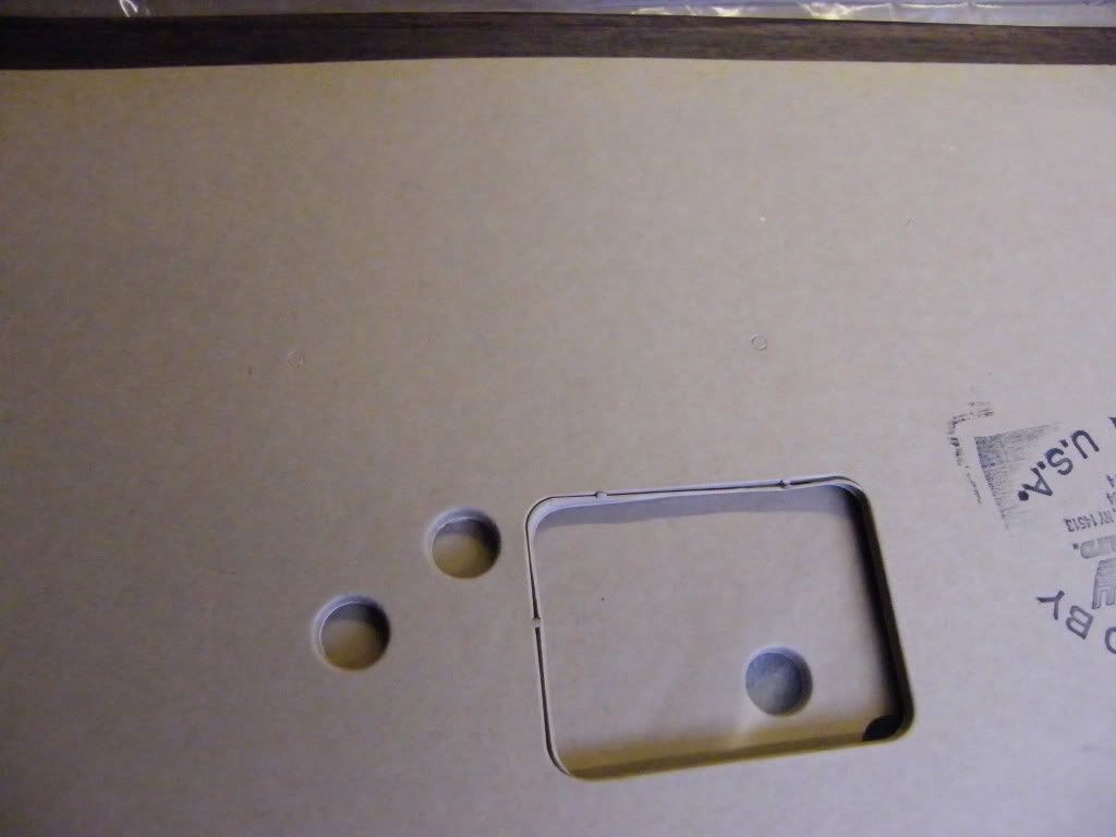

Next obstacle is to transfer the emblem that's on our original panels to the new ones. Quite a common theme with these resto panels & seat covers; having to reuse some existing hardware, so no great surprise, but these badges are riveted on
Stu's emailed Legendary so we'll see what advice the have.... if any... before we start grinding the old rivets off
Driver's side cleaned up, lubed & ready for new panel.... but not until we've refitted the old emblem
pre-punched holes just about visible, but way out of position (too low)

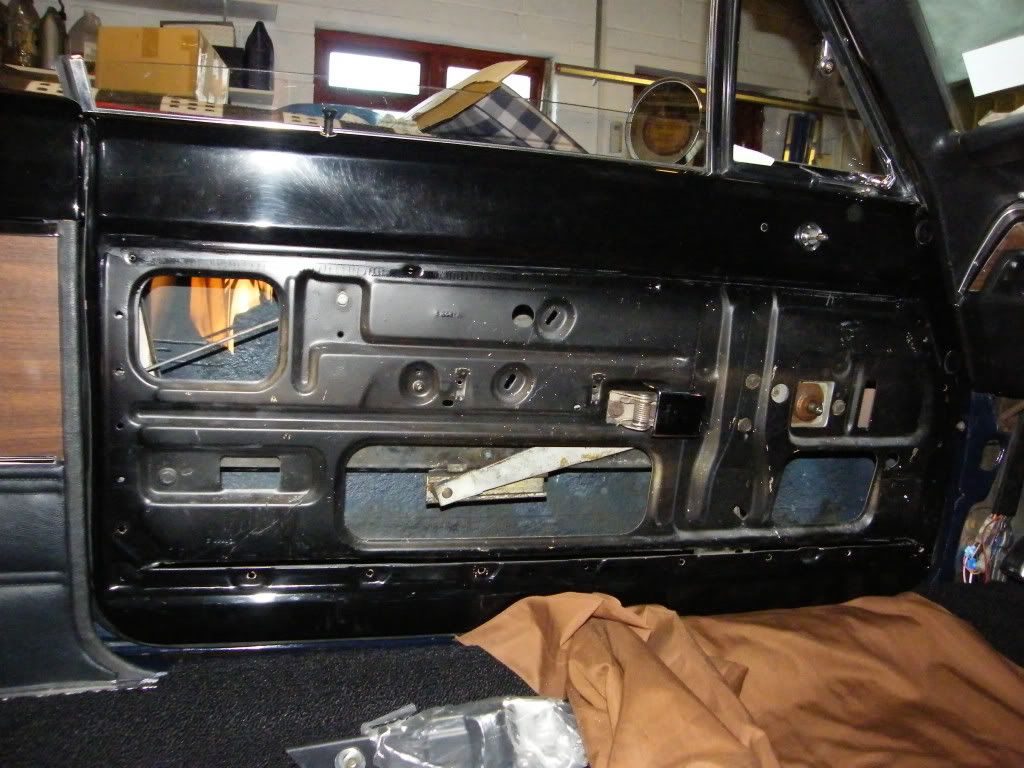

Hey Guys
All looking great.

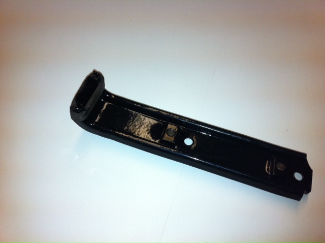

It looks like the widow up position stop is missing from the front door it mounts tot he door in those two diagonal slotted bolt holes. if you need a picture of what it look like let me know and I will take one of mine.
If you don't have it and you wind the window up too far and close the door you could smash the glass. The stop to adjust the down position is on the regulator by the window winder the nut with slotted screw in the middle.
All looking great.
yes a pic would be useful. But when we wind the window up with the door open, I'm sure it stops at the right position - ie not too high. We've had the car for nearly 27 years so thought we'd have smashed the glass by now if there was something missing
Unless Stu lost it while he was fiddling around

With the emblem,how about carefully drilling the backs of the rivets off then with a depth stop drill the emblem to take self tappers from behind?

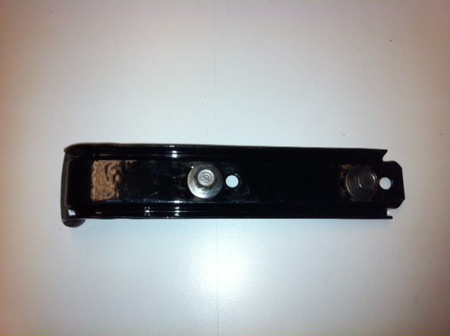

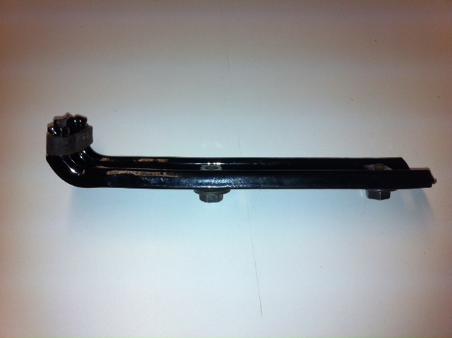

Here are the pictures of the stop bracket you seem to be missing.
When I don't have this adjusted right my window will hit the rubber stop at the top of the quarter window and them the back of the window will go up a bit higher and snag on the stainless steel trim above the door opening.
