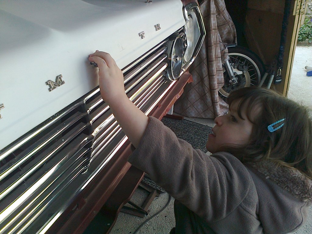

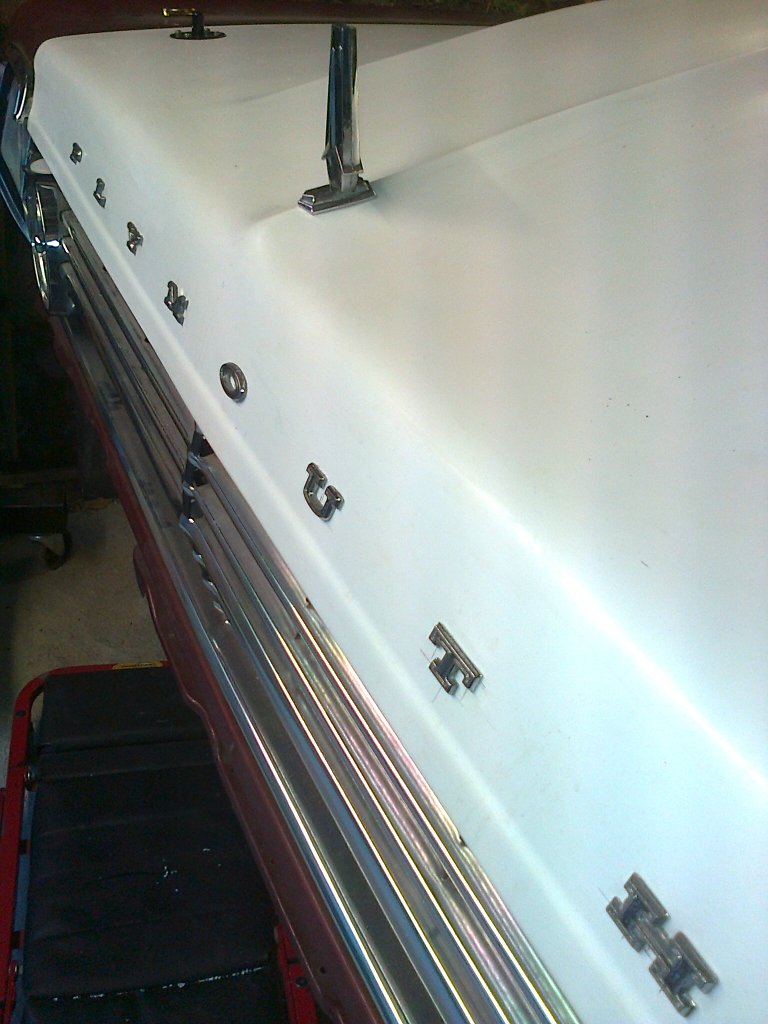

Sorry no updates for a few days- you'll be glad to know it's cos i've been busy on the car :D
Hood emblems are all fitted. It needed some delicate filing to get the mascot to sit right because the angle of the cowl hood is much steeper. It also lined up directly above the strengthening bar :roll: . I hollowed the bar out enough to get the mount inside, cos it has a retained nut i could then araldite the mount in but allow the nut to spin free.

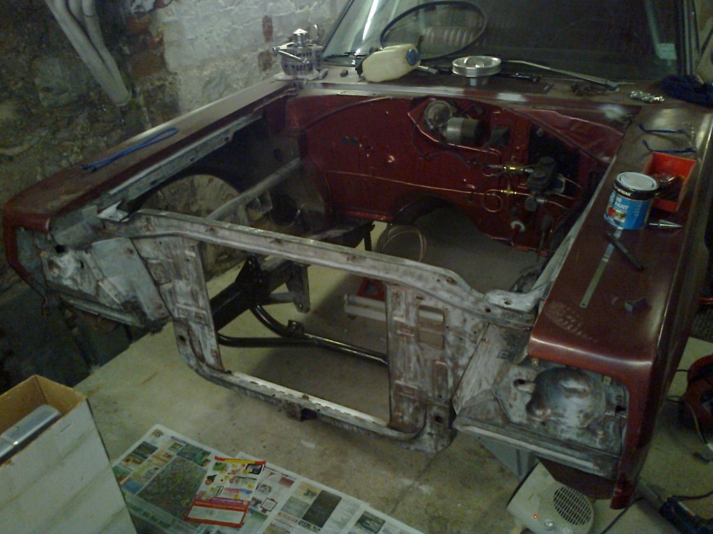

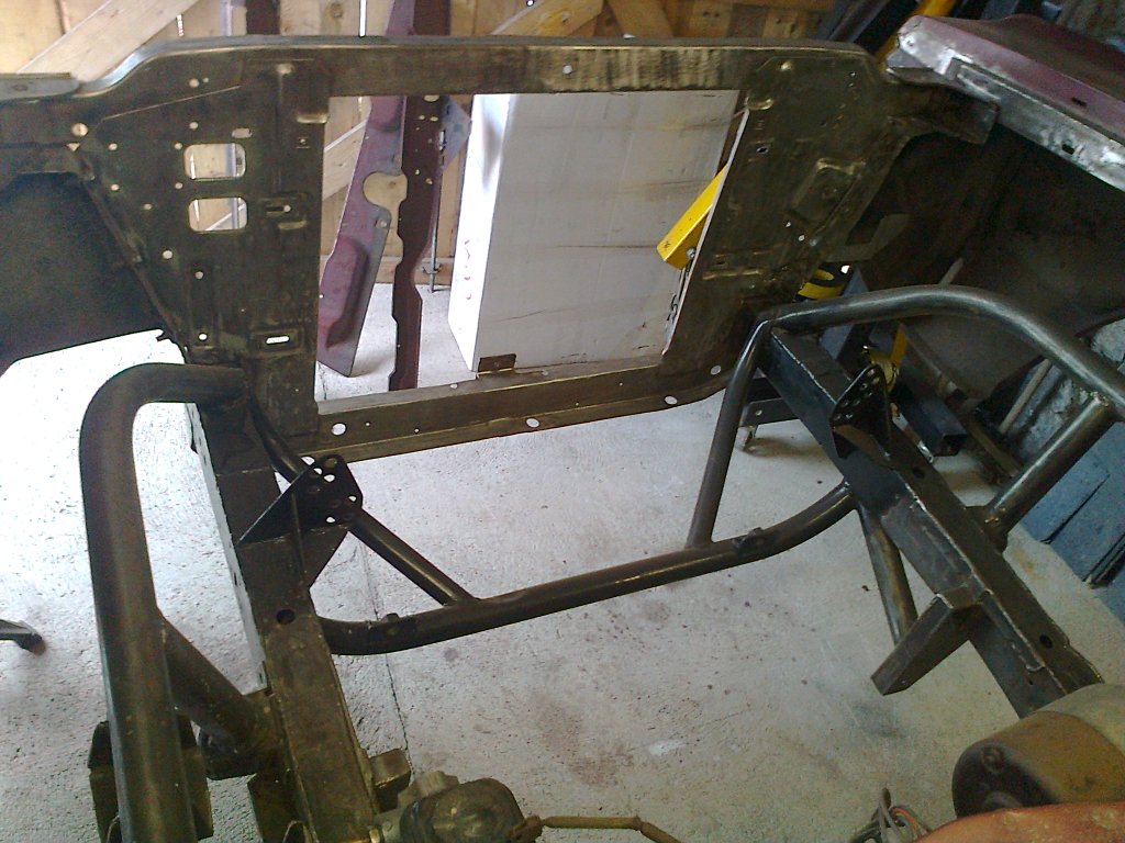

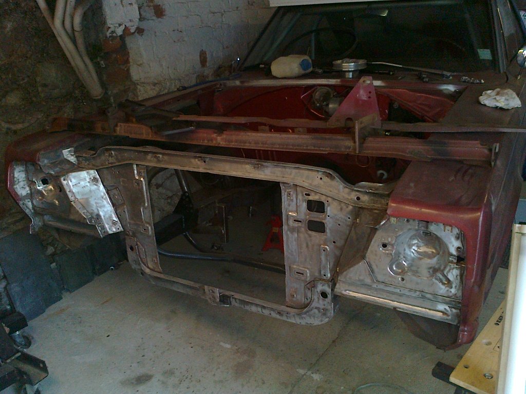

Oh, then i found myself wiyh a few spare minutes so i bare-metalled the front end... :roll:
Hood. Fitting badges 2.jpg (112.37 KiB) Viewed 1432 times
Hood. Fitting badges 1.jpg (172.56 KiB) Viewed 1432 times

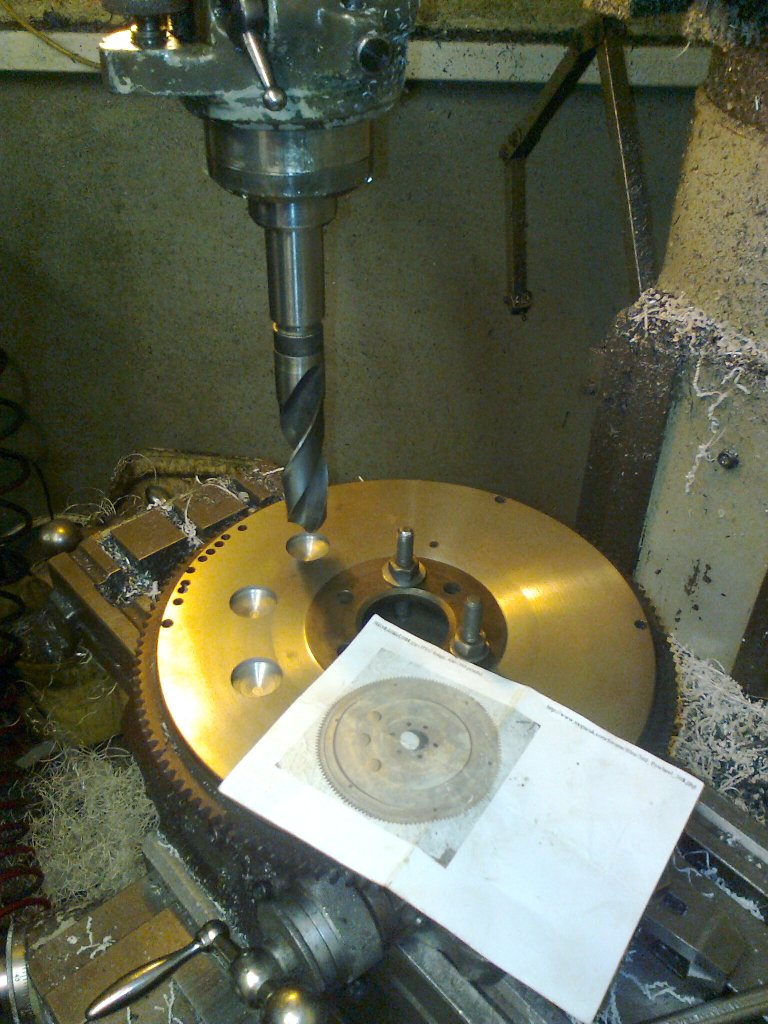

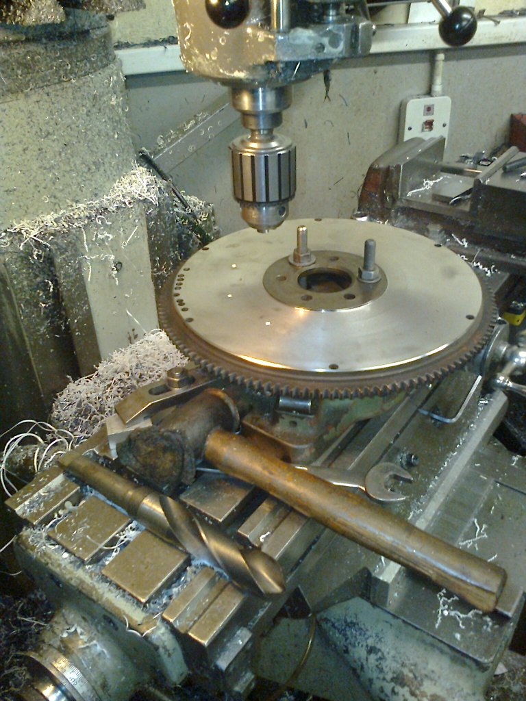

Meanwhile i took the flywheel up to Terry's. The guy who was gonna neutral balance it couldn't fit it on his machine, so we opted for plan 'B'.
First he skimmed the back to remove the bit that has been angle-ground out, leaving just the 9 drillings.
We measured these and calculated the volume of metal removed.
Now as you all know, of course... The effect of weight on a rotating mass is relative the the distance from it's centre, so we measured the distance from centre of these holes relative to the inch-and-thirteen-sixty-fourths holes, this was almost exactly x1.33333.
Then we just had to calc the volume that we should be removing, and subtract the corrected volume of the previous drillings.
Divided by three, this meant he had to drill the 3 big holes almost 4mm shallower than in the diagram to give the same balancing effect.
Should be as close as Chrysler ever managed it :thumbright:

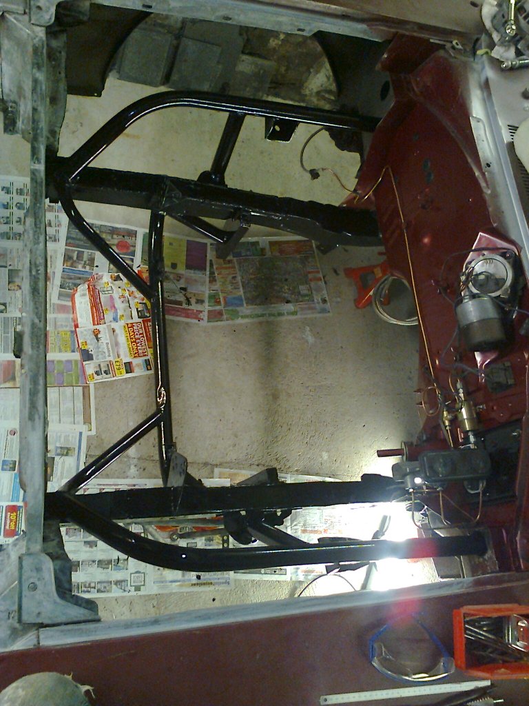

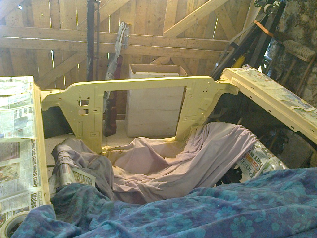

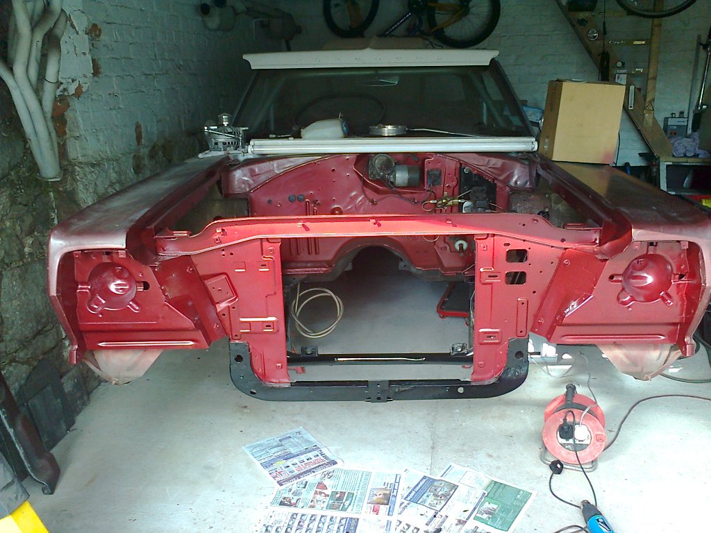

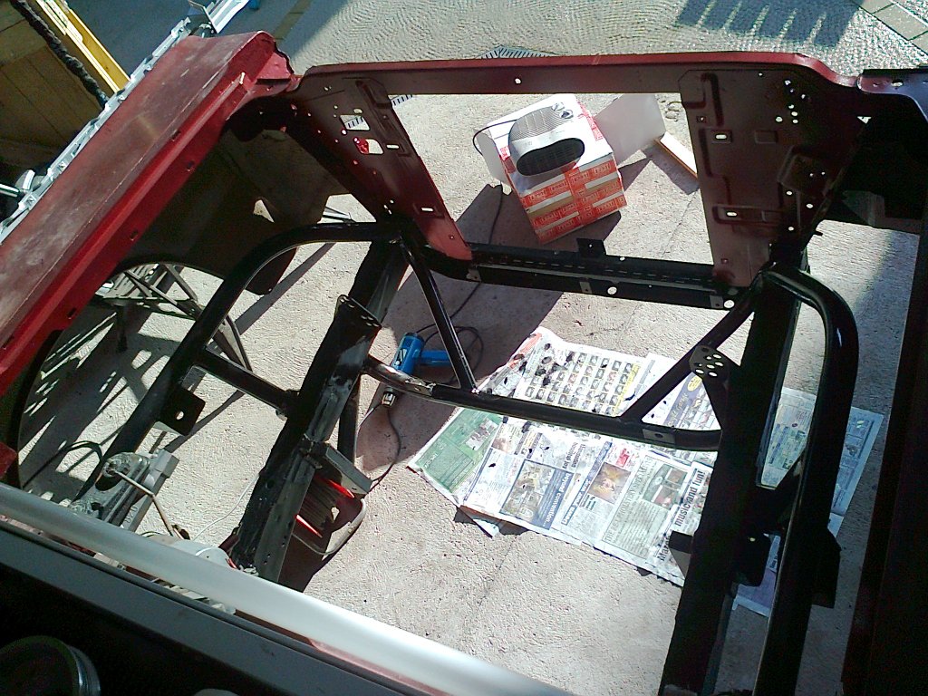

So yesterday i hit the front end with Por15.
I love this stuff- Just spray and/or Bananarama! on, can catch what runs off and re-use it (it ain't cheap!).
Keep it warm and wet for a couple of hours and you're left with an etch-primed zinc-phosphate coated surface.
Any rust you can't see (in seams, etc) is converted in the inert black stuff.
Give it a wipe and it's ready for primer :thumbright:
The chassis paint came out really well, til i welded up a little crack i found in the front and got grinder dust stuck in the tacky paint on the crossmember :roll:
Front end primered 2.jpg (156.37 KiB) Viewed 1413 times
Front end primered 1.jpg (167.63 KiB) Viewed 1413 times
Front end chassis blacked 1.jpg (168.5 KiB) Viewed 1413 times
Front end with Por15.jpg (144.34 KiB) Viewed 1413 times

db wrote:Meanwhile i took the flywheel up to Terry's. The guy who was gonna neutral balance it couldn't fit it on his machine, so we opted for plan 'B'.

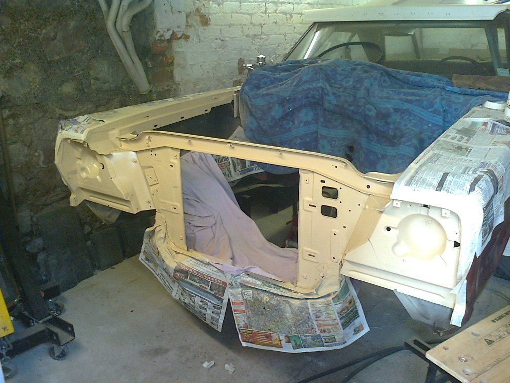

Here's the front end finished. Shame it'll all be hidden :roll:
Front end painted 3.jpg (205.34 KiB) Viewed 1299 times
Front end painted 2.jpg (228.69 KiB) Viewed 1299 times
Front end painted 1.jpg (169.63 KiB) Viewed 1299 times
