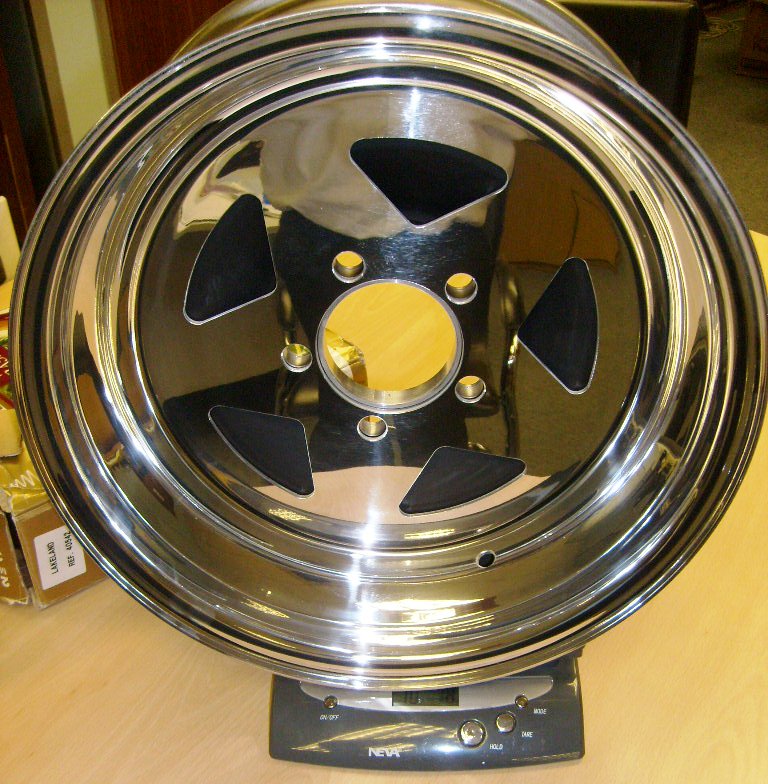

Got my new Bogart rear wheels yesterday ; superlight at 10 lbs 1 oz each ... thanks Blue
Get them on this week plus a few other minor mods

Posts: 13000
I bet they make your wallet a bit lighter too! ;)
Posts: 13847
Crikey, they look thin, Jon :shock:
Presume they're ally or similar, and not steel (tho they look chrome plated). Dont go near any kerbs with them fitted!! :?
A pot hole in the road would kill those never mind a kerb. I wouldn't race at York if I were you. :lol:

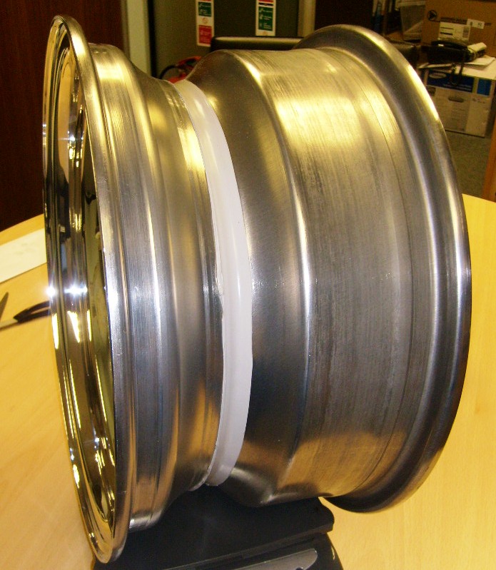

Ivor .. they weren`t too bad, in line with weld etc
They are a strange construction ... made in 2 halves ; back half out of billet turned alli and then welded onto the front half with the weld covered up with silicon sealer :shock:
Dave ... not been to York yet, will let you know if they survive

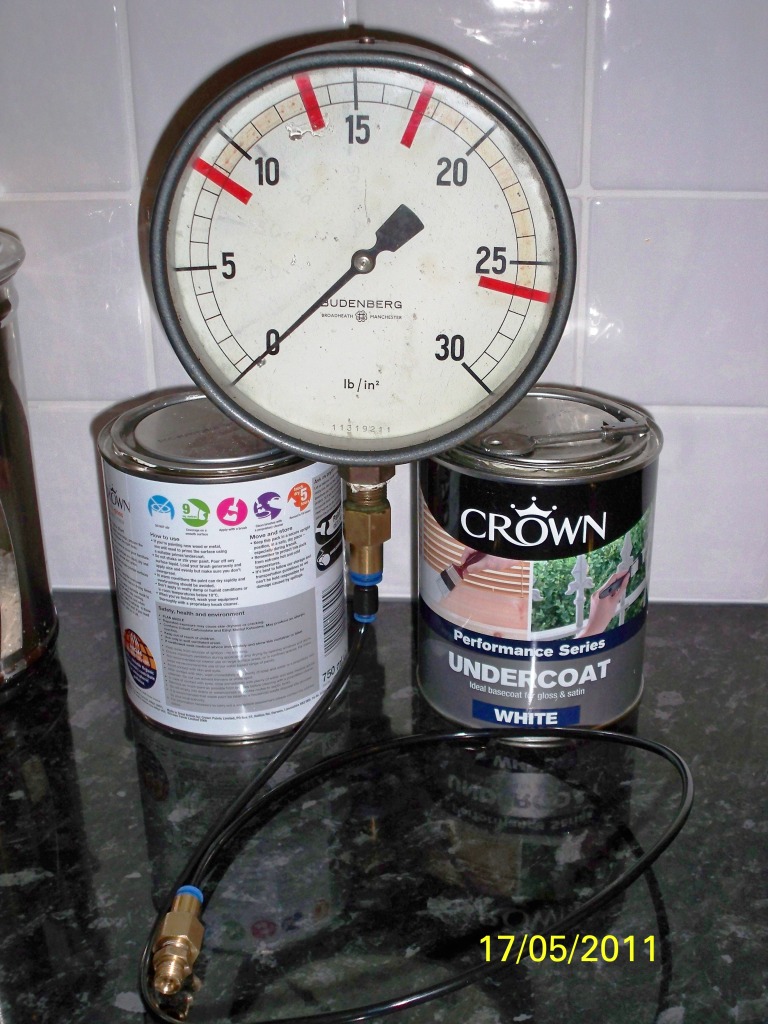

Will now reset fuel pressures using a calibrated pressure guage ( calibrated to + - 0.2 % ) with 1/8" NPT and start fine tuning at Gary`s Picnic
