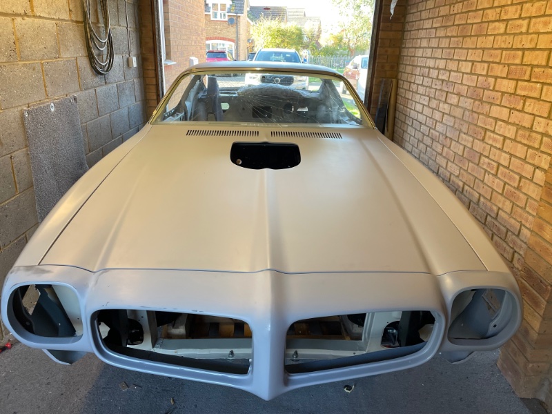

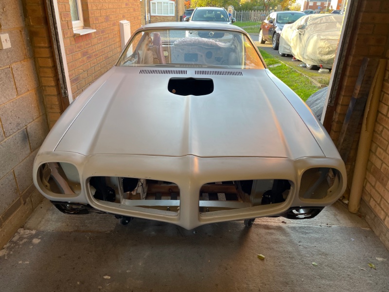

Scrub that , I’ve spent the last 20 hours and managed to get my new fenders to sort , well sort of !
Much much better than last weekends effort
Still will need some cutting and dressing on the left side but not to horrible.
My Pypes exhaust system looks rather nice
Maybe a tad too large but meh !

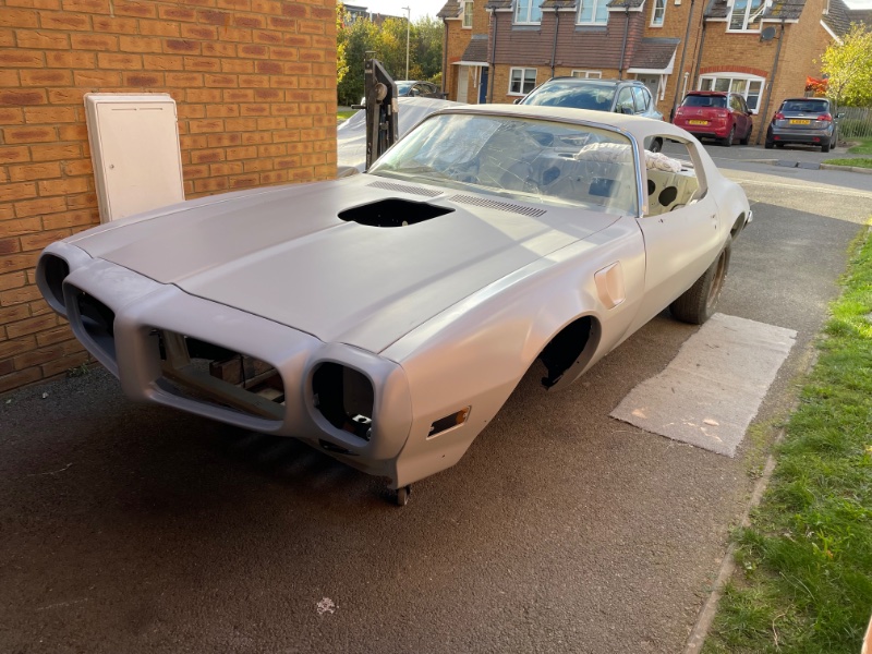

Re: My very last restoration!!!
Been busy again and trying to get my moody Asian metal work to something like aligning !
There’s very little in panels for early F’ body’s so later bits have to be chopped and modified,

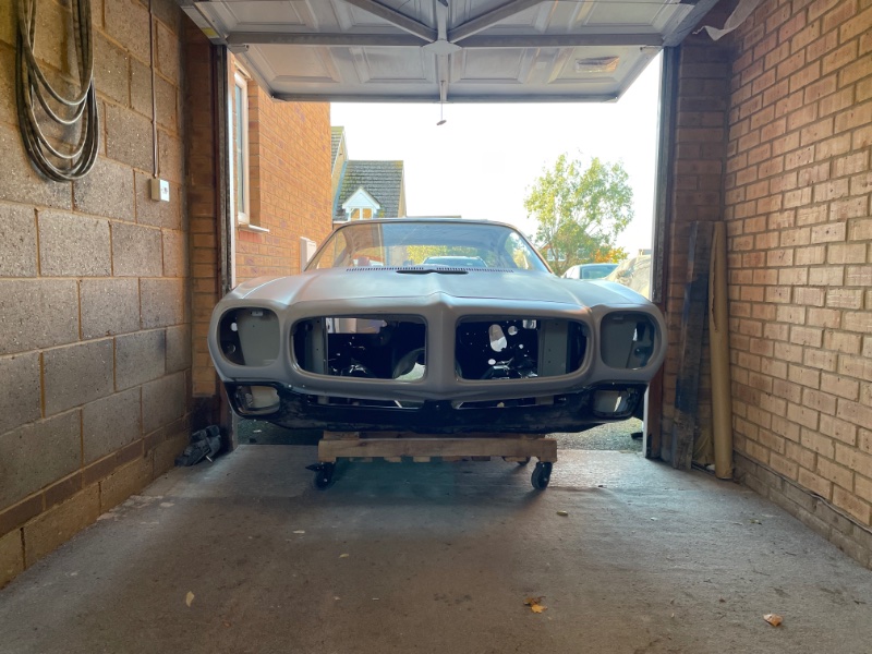

Do you have enough room to open the doors in the garage or do you have to wheel it out on the dolly?
It’s got much bigger since all the panels and subframe have been fitted!
So yes I have to work mainly outside now ,
Given the winter is almost here progress will undoubtedly slow, and eventually stop through the worst parts,
I’m hoping to get the front end alignment done, square up the panel gaps , doors to front fenders, fenders to hood,

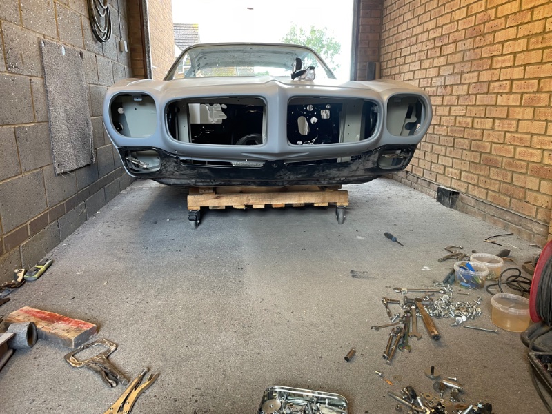

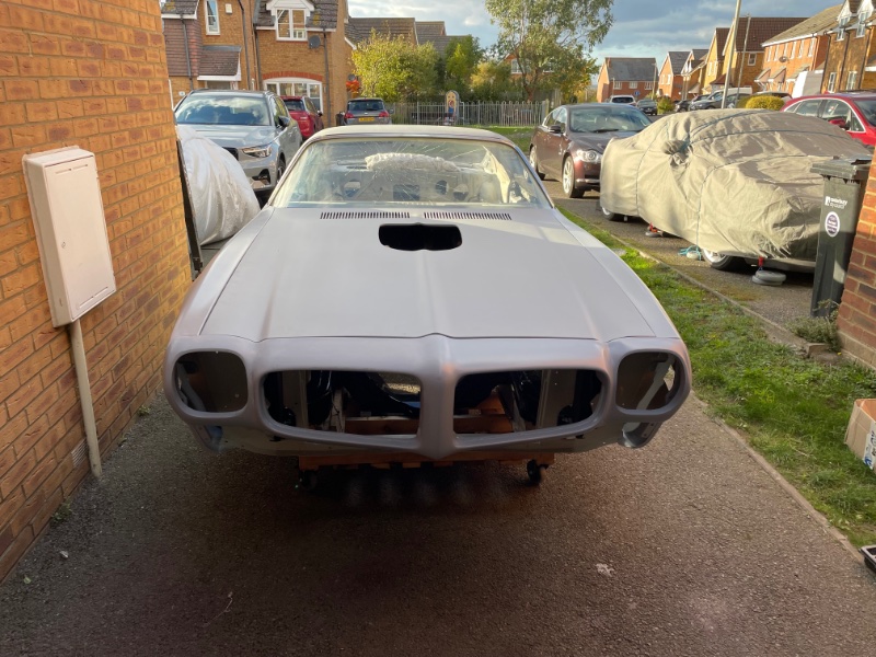

Well after another weekend Ive almost got the front short of aligned !
Absolutely crap way for building a car,
Shims and spacers, bending panels and a hundred different permutations to end up with something that’s just about acceptable,
Bit of an eye opener really,
The actual body tub is far more accurately built than my Challenger but this rubbish front subframe assembly and all it supports is totally crap,
Front chassis rails and inner wings all fully welded are far superior,
Its hardly surprising that they wasn’t successful in Trans Am racing, and ironic that they have the name !
The white car is the actual car that started my obsession way back around 1977’ ish
One ride in this thing and my Escort RS days were over ,
It’s taken me 48 years to actually own the very same model and specification, but not the actual car,
I did find and looked into buying the original TA
But once I’d seen it in the Bananarama! was obvious that years sitting in a garden in Essex for years and the amount of rubbish welding it was far to gone for me to entertain,
It has be owned by the yank dealing in Fearing for donkeys!
- IMG_5401.jpeg (178.62 KiB) Viewed 16496 times
- IMG_5400.jpeg (184.51 KiB) Viewed 16496 times
- 93e36f5c-dc1c-4ec7-bdf8-3690337ab67d.jpeg (98.71 KiB) Viewed 16496 times

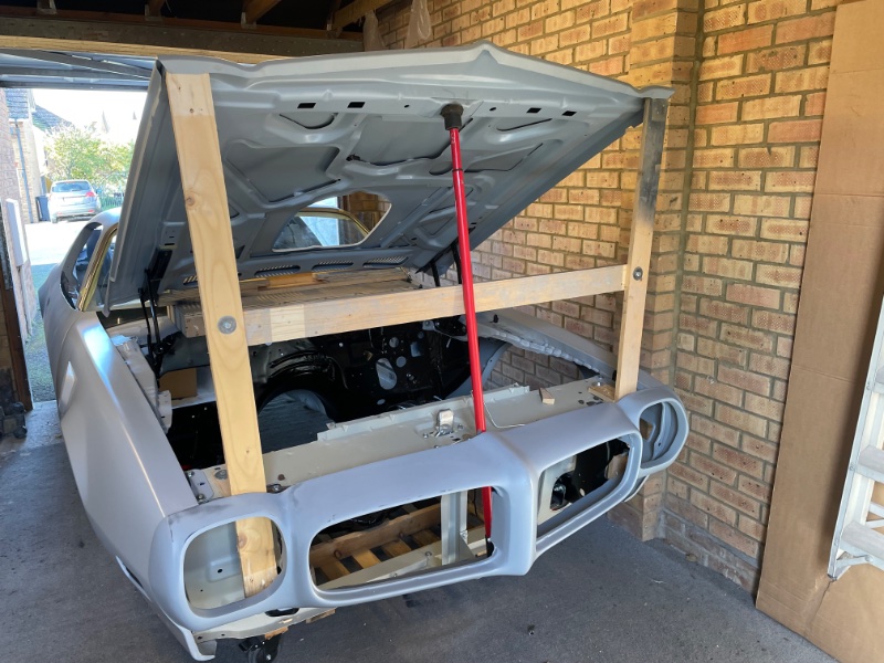

My Doug’s stainless headers and new mini starter were delivered today!
Excellent service from Summit as always,
And managed to get the front end pretty square over the weekend, so all good !
Had to fabricate a second pair of hands to assist with hood holding!
Going to take a break from the turd now,

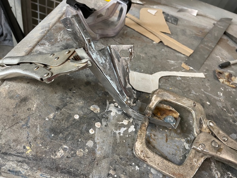

Haha

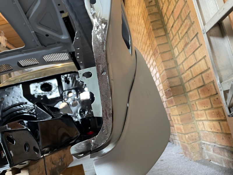

Cheers, however done a couple of small jobs this week so far
My front quarters require a modification to the front edge,
Early cars like mine have a steel lower front panel,
Fiddly little bracket to remove from original fenders and retro fit in the new ones ,
My brackets had some corrosion so required some neat repairs,
Just test fitted them , all good,

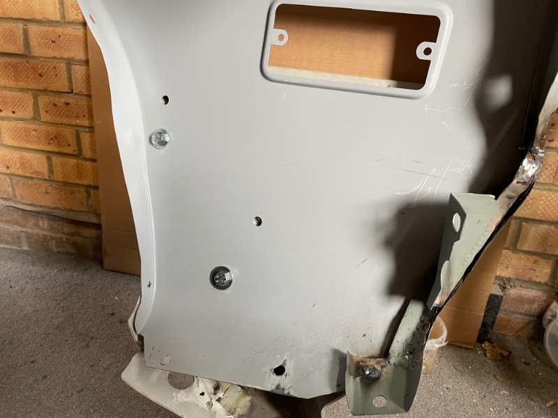

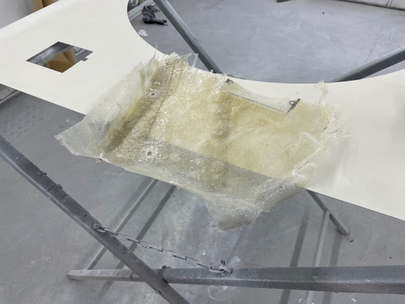

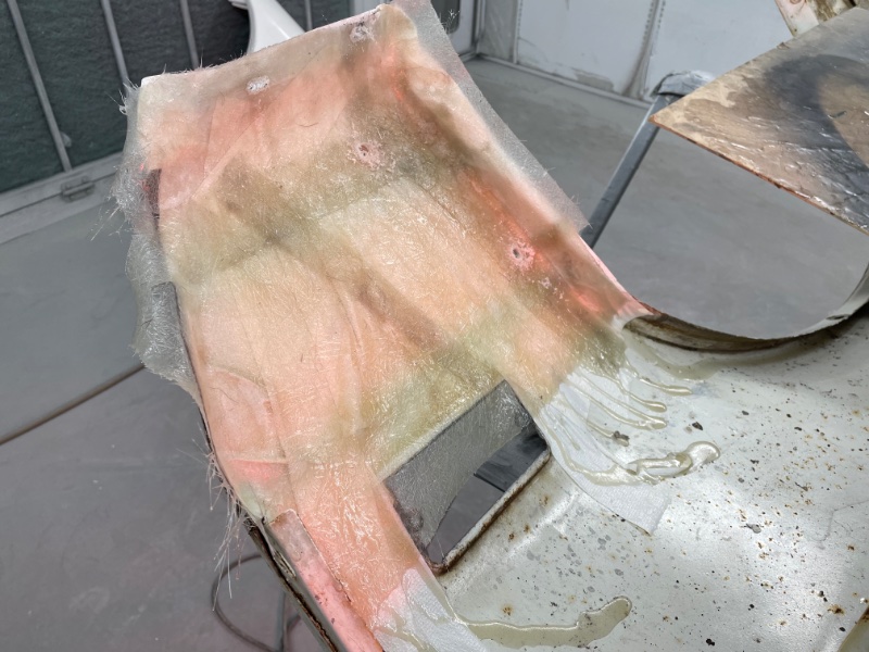

Back on the FireTurd today
Following a test fit of my fender deflectors which didn’t fit as the factory punched hole were completely in the wrong position?
Struggled to get an accurate template with card, thin Ali etc
In decided to take a moulding from my original fenders
Proper faff but didn’t want my panels to resemble Swiss cheese!
Worked perfectly
Finished replacing the lower front panel brackets
And almost got the car built back up,
You can see the strange profile on the fenders that made it difficult to copy, hence the GPR !
Worked perfectly

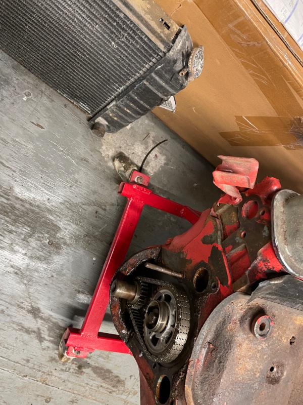

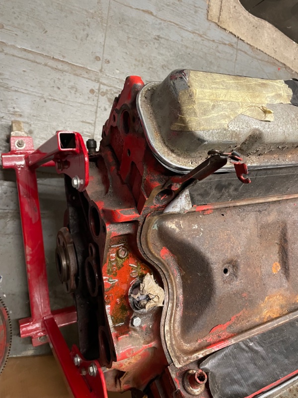

And I’ve finally started to pull the mill apart
Heads off next week hopefully
