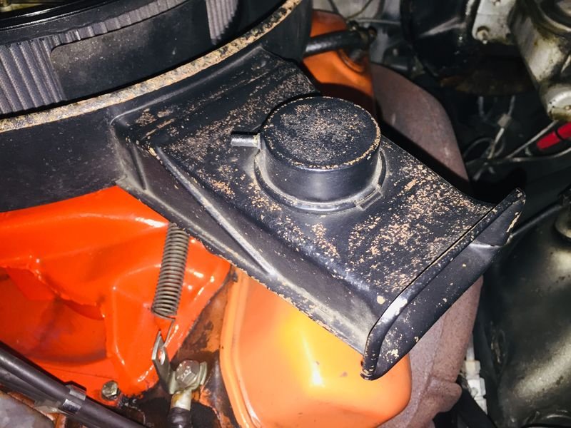

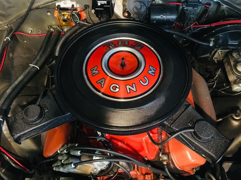

Air Cleaner Refurb
“Unique for 1970 383 and 440 4-Barrel. Breather hose comes off back of unit. Snorkels have straight crease line on their right and left side. 1972 air cleaners are very similar but have a curved crease line or hump on right side of their snorkels” – Nick’s Garage

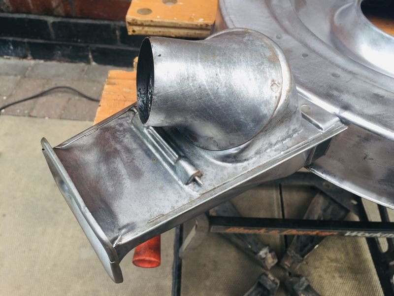

The air cleaner is in good shape, no dents or such like, only needed a re-paint

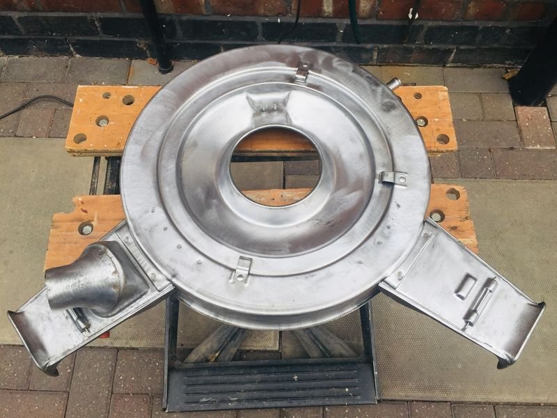

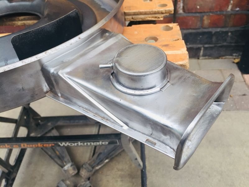

Removed all the old paint ready for re-finishing
- IMG_2250.JPG (105.55 KiB) Viewed 8845 times
- IMG_2255.JPG (72.75 KiB) Viewed 8845 times
- IMG_2256.JPG (101.77 KiB) Viewed 8845 times
- IMG_2257.JPG (80.48 KiB) Viewed 8845 times
- IMG_2259.JPG (86.99 KiB) Viewed 8845 times

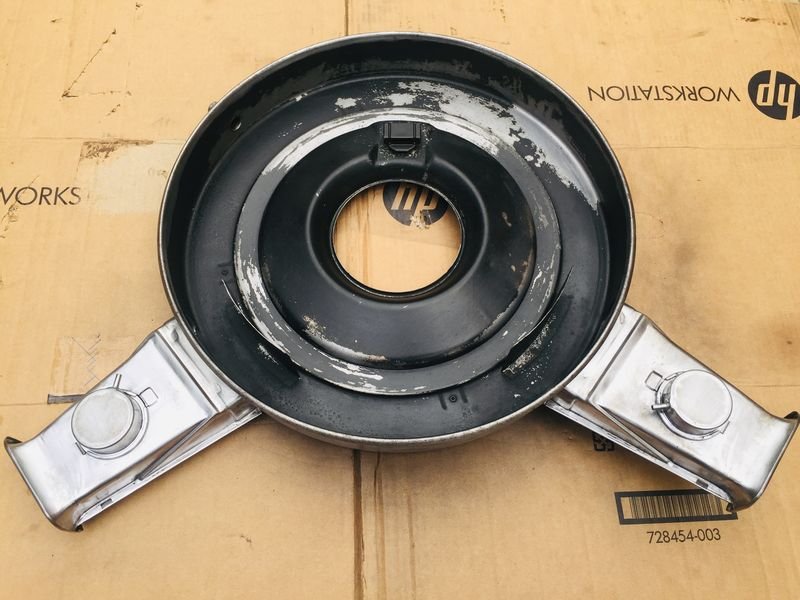

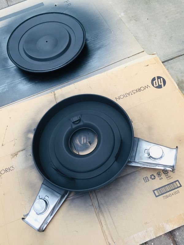

Re: Si's '70 Charger 500

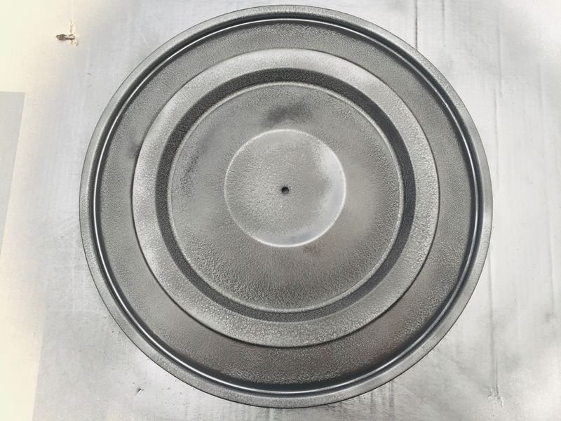

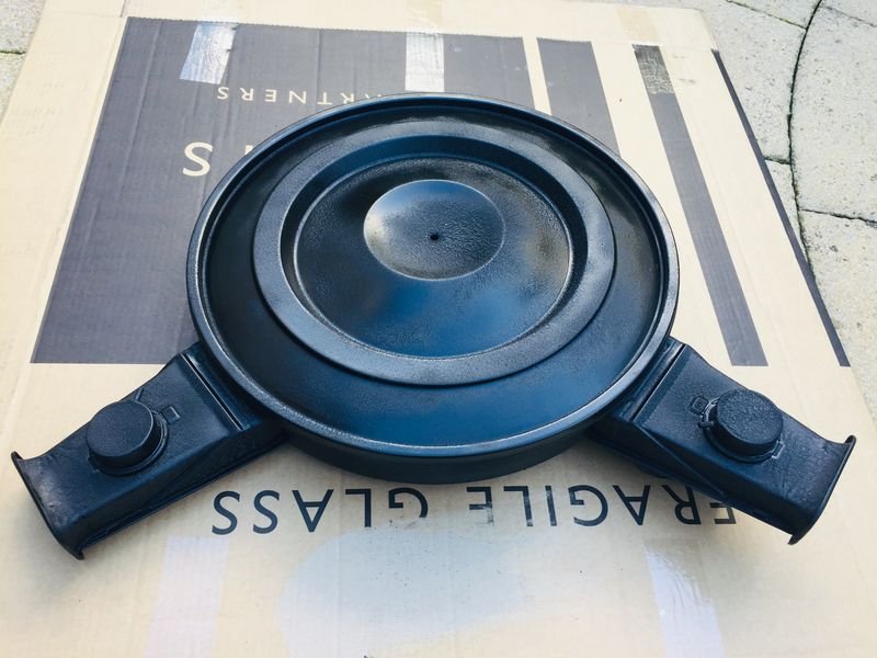

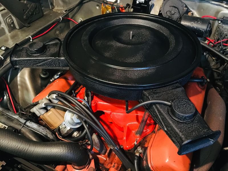

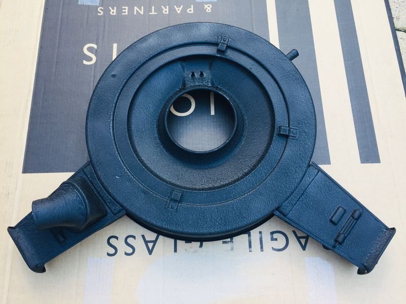

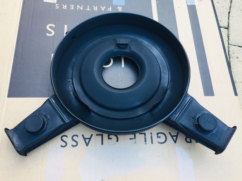

VHT Black Wrinkle Finish was used for the exterior, satin black inside
- IMG_2258.JPG (99.83 KiB) Viewed 8844 times
- IMG_2300.JPG (68.18 KiB) Viewed 8844 times
- IMG_2303.JPG (87.04 KiB) Viewed 8844 times
- IMG_2304.JPG (70.16 KiB) Viewed 8844 times
- IMG_2305.JPG (84.27 KiB) Viewed 8844 times

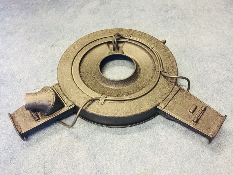

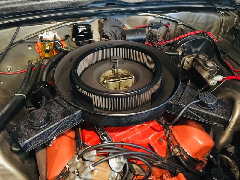

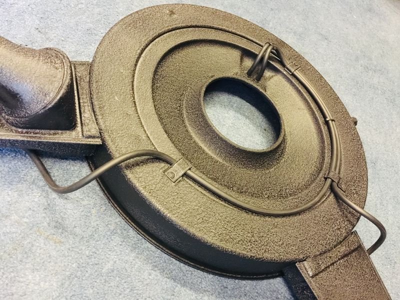

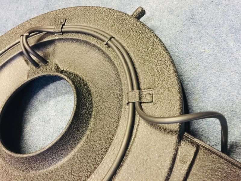

The vacuum lines are added for appearance only, both lines are terminated at the thermal switch with no actual vacuum source
- IMG_2306.JPG (113.61 KiB) Viewed 8844 times
- IMG_2307.JPG (144.53 KiB) Viewed 8844 times
- IMG_2308.JPG (141 KiB) Viewed 8844 times
- IMG_2309.JPG (124.49 KiB) Viewed 8844 times
- IMG_2310.JPG (115.29 KiB) Viewed 8844 times
- IMG_2311.JPG (113.55 KiB) Viewed 8844 times
