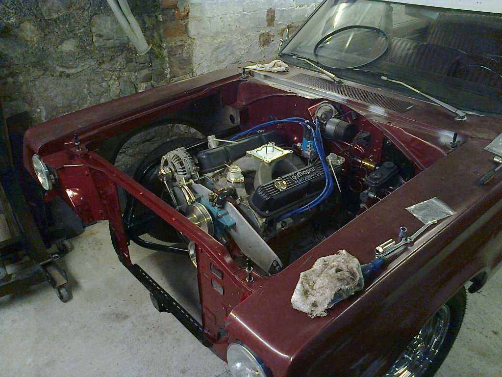

Just got the motor back in this evenin :D
Motors back in.jpg (181.49 KiB) Viewed 1551 times

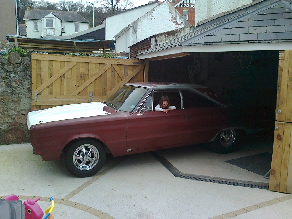

Well today I fixed a couple of really arsy things on the car while waiting for two mates to help me shift it over to Tamzins brothers for wiring.
One of the rear windows needed adjusting as it was fouling the upper frame. The adjuster of course is behind the panel which requires the rear seats taking out which cos of the cage is like fighting a hippo in a cupboard. Jasper will need the seat out for wiring so i bit the bullet and went forit.
I also needed to re-mount the pass side front seatbelt spool. On the proper mount the seat collided with it so i welded a bracket to the base of the rollcage and bolted it to that.
I refitted the hood pins and set them to the correct height.
In the end we towed the car. Not ideal, in fact proper scary and not a little stupid, but a real buzz to steer it along the road for the first time :D

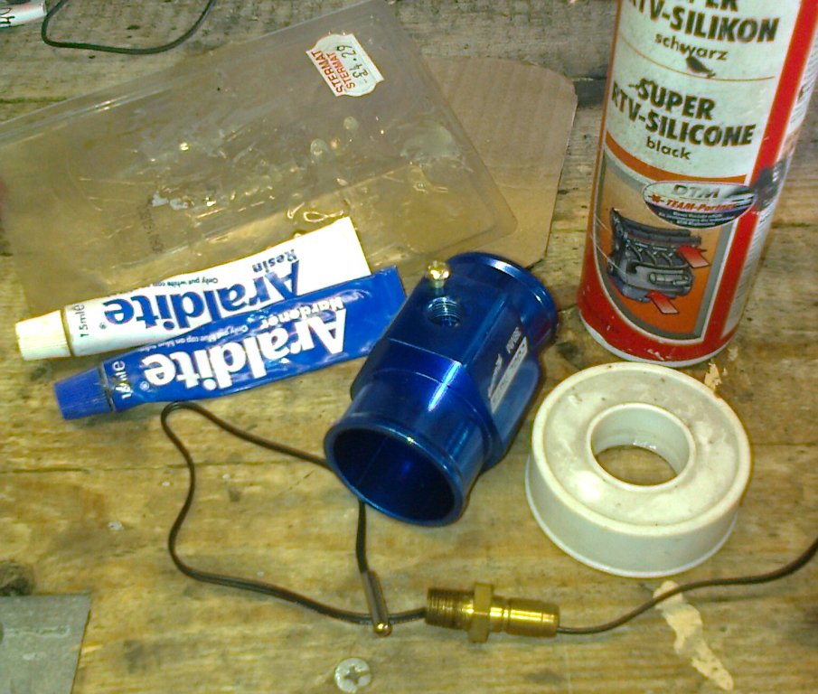

I'm off to the garage now to make a bracket for the water temp & oil press to sit in the mouth of the cowl hood, and to fix the probe for the fan controller into the top hose.

db wrote:...... and to fix the probe for the fan controller into the top hose. :thumbright:
Plenty of PTFE :thumbright:
Or has it got it's own collar to sit in :shock:
Fitting fan sensor.jpg (135.43 KiB) Viewed 1340 times

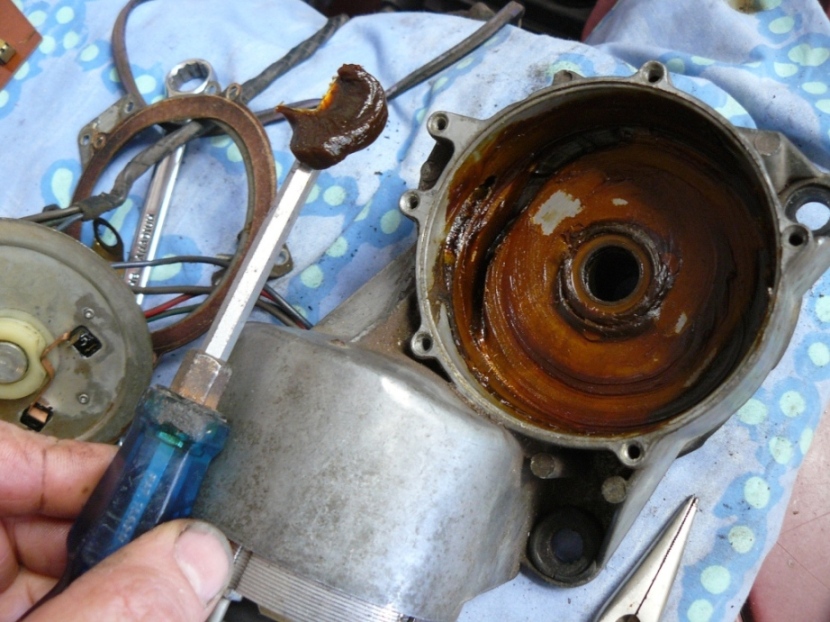

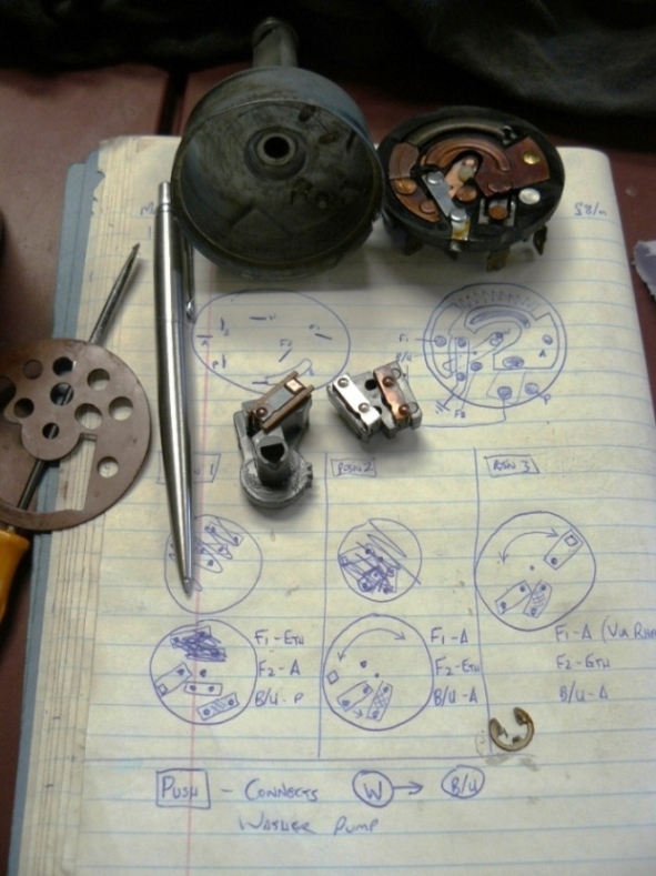

Anyone ever worked out why the wiper motor and switch have to be so bewilderingly complex? Were they designed by comittee? :scratch:
We found the light and wiper switches had packed in, along with the wiper motor.
I've stripped the lot, cleaned/ fixed as necessary and they all work lovely now :D
The Wiper motor had beed packed solid with grease which had baked to a nice treacle and seized the gearing!
The wiper switch control shaft was stuck in it's housing because the aluminium had worn and the resulting ally powder was jamming it. I had to fully dismantle it though just try to figure out how the hell the wipers actually worked. Bizarre!

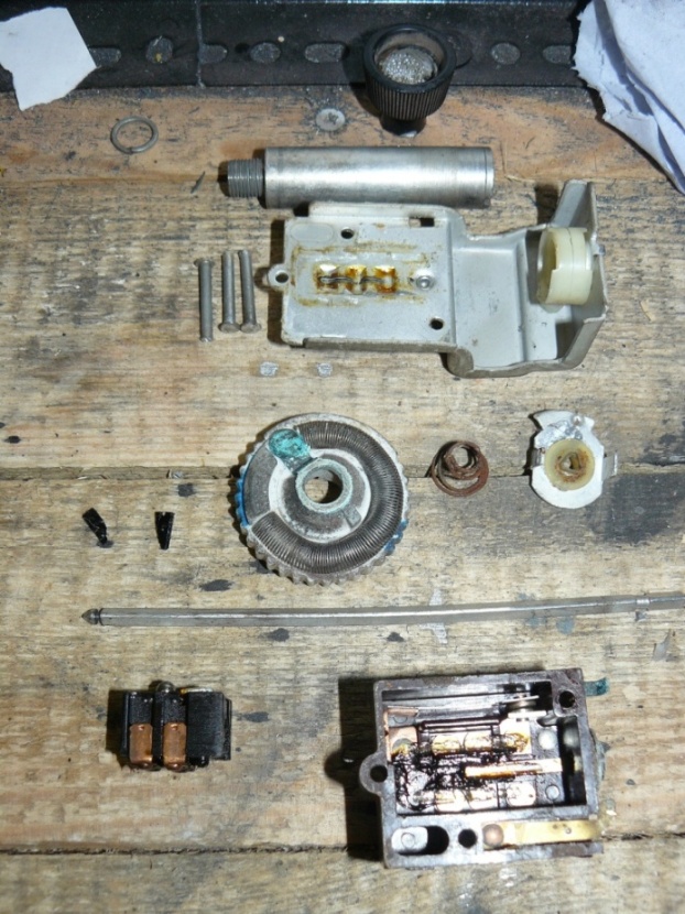

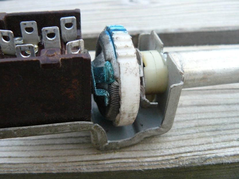

The light switch was in a sorry state. Corroded to hell and the rheostat (dash light dimmer) had come apart. I cleaned it all out, cleaned all the contacts with WD40 and scotchbrite and re-laid the rheostat on a bed of araldite. It was originally riveted together, i had to replace these with bolts. I had to grind the bolt heads to fit and sleeve one contact with heatshrink. Sorted :thumbright:
